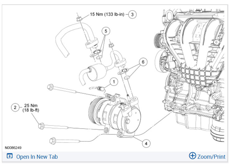

Ac seized awhile back but was still able to drive. Yesterday a squealing noise started when I used my defrost. Crawled underneath and it looks like the A/C pulley is about to fall off. looking for a cost-efficient solution.

Not much you can do with that at this point it sounds like it's time to get a new A/C pump and they usually come with a new pulley that about the only solution i can think of if you have a bad pump and a bad pully. good luck .

Yep, I agree with MECHTRIX, the A/C compressor will need to be replaced.
Here is a guide and video to help you through the steps:
https://www.2carpros.com/articles/replace-air-conditioner-compressor
And this video will show you how to vacuum down and recharge the system:
https://www.youtube.com/watch?v=4EqdrBVb0sY
Check out the images (below). Let us know how it goes.
