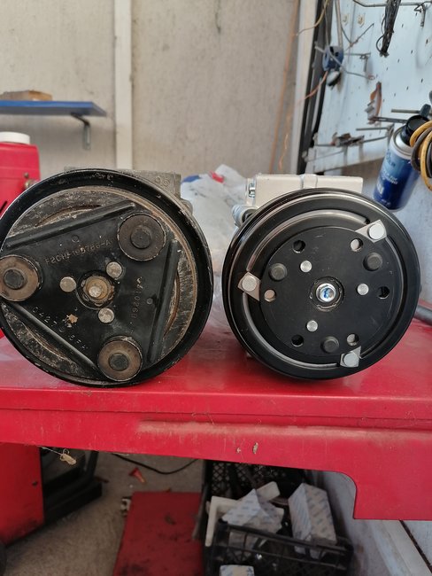

I purchased from a local dealer by part number and win number and received the same but with smaller clutch wheel diameter on the front side.
The mechanic said it would not be a problem, and he will adjust the belt tensioner.
When I took the car, he told me that it works perfectly.

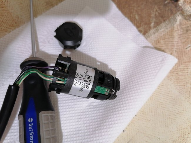

Sorry about my late answering, but I received the last e-mail notification in spam. I just came back from the mechanic, and he said there were about 300 grams of 760 missing Freon. He inspected with ultraviolet light and said he didn't know where it was leaking. Then discharged the whole system, and recharged again. Then he said to drive the car together and the symptom with on and off was the same. He said why do you open the window to hear the click of compressor, just don't listen and drive. The final words were that maybe the cabin temperature sensor is in some fault. He said I don't know what to tell you, just drive the car. Please if you have some schematic or photo of location of this temperature sensor and if it is not very difficult, I will try to remove and test at home with multimeter and hair dryer. Or if you don't have, please just describe me with words. Thanks once more.
Jul 4, 2022 at 6:27 AM
WISH30
  • 124 POSTS
Update: I made some researching and effort and got the sensor out. It is on the photo. Please if you can give me some instructions how to test it at home. As I can see it have four wires.

Update: I found that two wires are thermistor leads and other two are cooling fan. So I connected the fan at 5V Dc because I was not sure about its voltage and it started to spin. Other two wires gave me 9.4KOhms at room temperature around 26-7°C and if I blow hot air by mouth it drops than rises again to this value. Is it good range? Thanks
Jul 4, 2022 at 11:33 AM
  • 55,706 POSTS

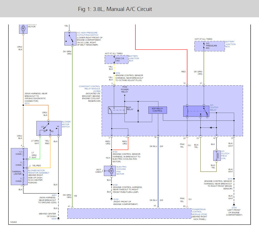

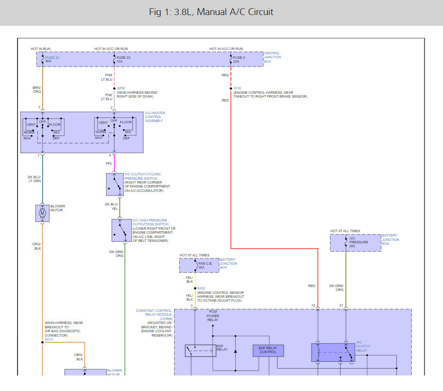

It still sounds like you have a leak, did you see the video? You can inspect the condenser without having a leak tool. I would not allow the compressor to continually click on and off, the sensor values seem okay, I did notice that the compressor is controlled by a CCRM constant control relay module which goes out all the time. Here is a compressor HVAC wiring diagram so you can see how the system works. Check out the diagrams (below). Please let us know what happens.

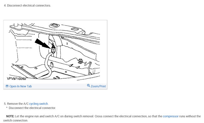

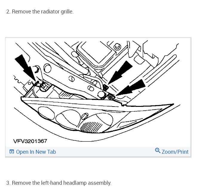

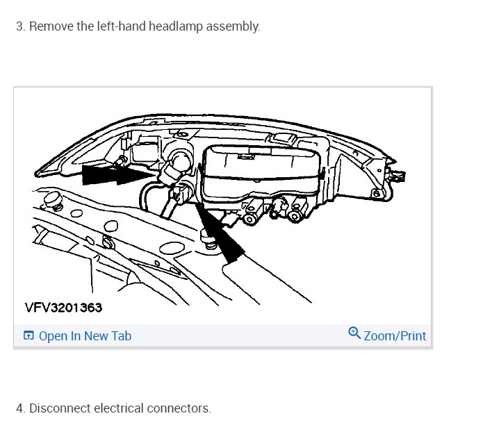

Jul 20, 2022 at 9:53 PM
  • 55,706 POSTS
You are never boring, we want to help you get eh problem fixed. I would like to know what the high side pressure is because if the system has too much refrigerant it will have this problem as well.
Here is the location of the cycling switch sensor in the diagrams below.

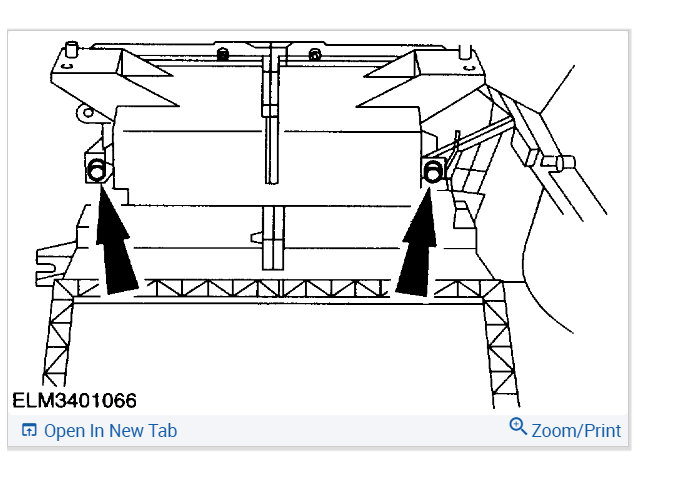

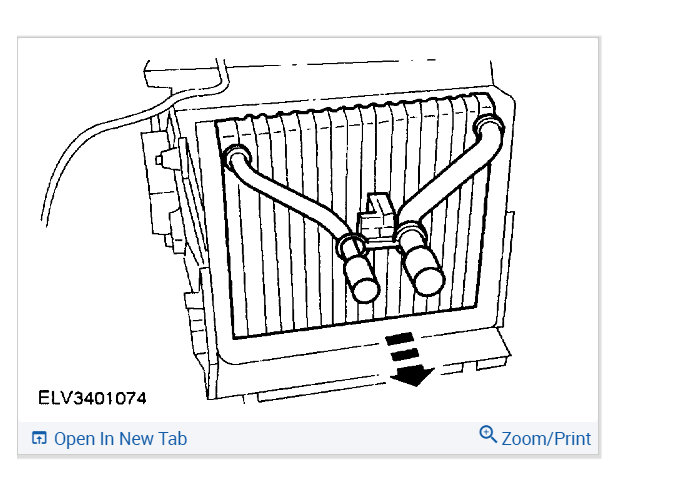

Do you have a diagram of the exact location of evaporator sensor, that one which measures the temperature of internal evaporating core (not cabin temperature)? because I like to check that sensor also (if not too difficult to reach). Thanks
Jul 21, 2022 at 3:58 AM
  • 55,706 POSTS
They don't show it be it should be around the evaporator core case.

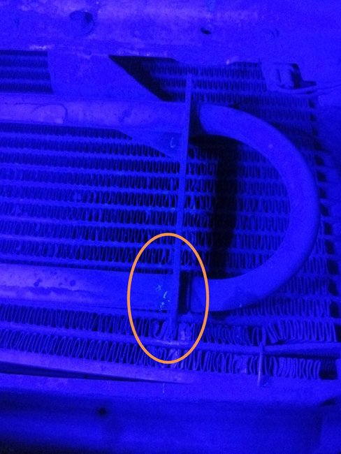

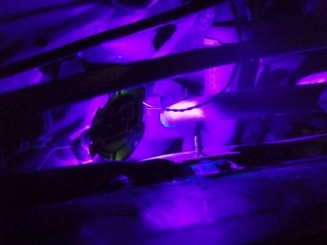

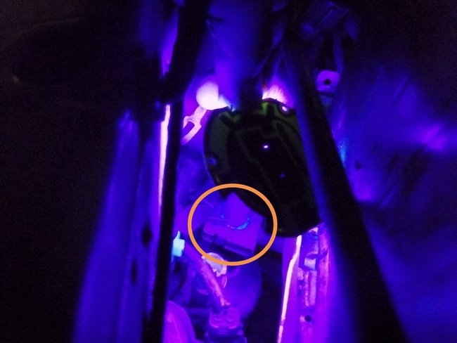

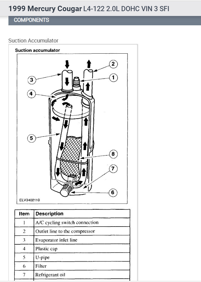

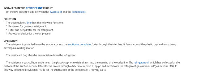

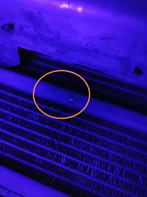

Update: The refrigerant leaked out completely again (it was in around 20 days). Before searching for a fifth mechanic, I tried to inspect in late at night with mosquito lamp diodes. What I noticed was fresh green color on the joint of pipes between low pressure line and the accumulator/receiver/drier.
I attached photos made by mobile (but it can be seen). As I read on internet it is good option to replace the receiver every 2-3 years, and as it is never replaced, I ordered new one (together with low pressure sensor) and waiting to receive and go to mechanic to make new try :)
I would like to ask about one pipe if you are able to tell me what is that pipe for (hope not a part of AC).
I was not able to completely inspect the way because I was laying in front of the car (not under). I noticed some points of leak but also the coolant joints on some pipes reflect green and by logic it is not necessary to be Freon.
This pipe is like a horizontal U letter and is mounted in front of the car (in front of the AC radiator on the lowest point. It is connected with rubber hoses, then hoses again connected with thinner pipes and go somewhere behind the engine. Thanks in advance for your patience, time and answer. Best regards from Macedonia.

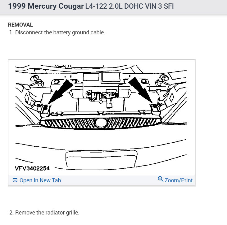

The first two images seem like the problem, the second two don't look like anything to be concerned with, good job on finding the link, I like the mosquito lamp. :)

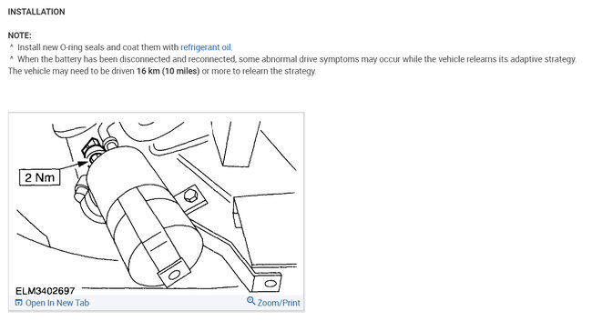

Here is how to change out the receiver dryer. Here is a video on vacuuming down and recharging:
https://youtu.be/4EqdrBVb0sY
