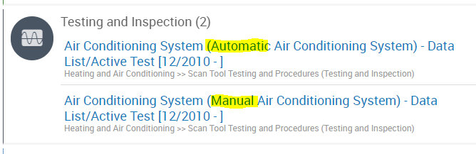

Do me a favor. Let me know if the system has automatic climate control or manual control. I want to read through the diagnostic info, but it goes two different ways based on the system. See pic below
See pic below.
Aug 4, 2022 at 9:24 AM
GMANSCHULT
Hi Joe. It is manual.

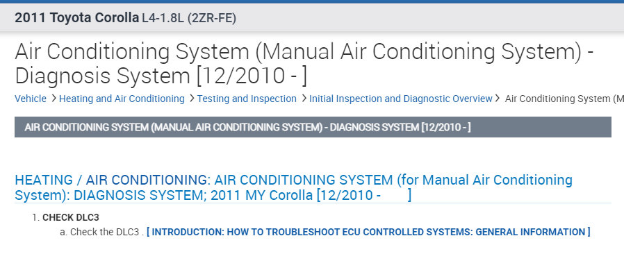

Thanks. I went into the manual diagnostics and found nothing. See pic 1.
Since it takes a couple of minutes until the pressure builds, my first suspects are low refrigerant, or the compressor is failing. The compressor itself would be more likely with the pressures.
Have you tried vacuuming the system down and then recharging it?
See pic below and sorry for the manual's lack of help.
