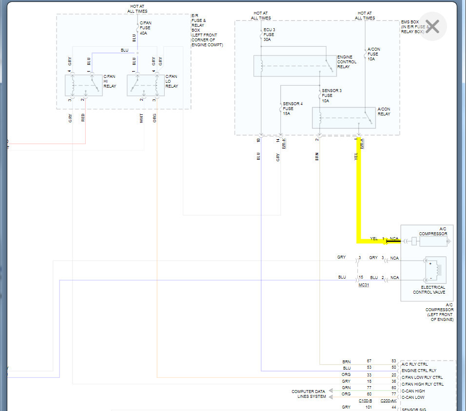

The A/C stopped working a while back. It would work for like the first 5 minutes then quit. After a while it quit working all together. We had the engine replaced not too long ago due to one of the connecting rods coming apart. We had asked the dealer if they could also find out the issue with the A/C since it wasn't working then. They said they would. When they called me to let me know it was ready, I asked them what was wrong with the A/C. They said they couldn't find anything wrong and only recommended replacing the discharge line as it had been seeping. Told them we would get around to it. Picked up the car, A/C was working fine for 2 weeks then it stopped again. We replaced the discharge line a had the system flushed. System was charged to 1.21lbs, still not working. We had already replaced the thermistor (evaporator temperature sensor) and high side pressure switch just because they were cheap. Still cannot figure out what is going on with it. Any suggestions?

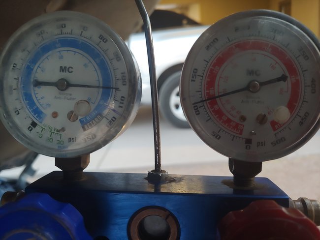

Hey guys, sorry for the late reply but I finally managed to get the pressures. Both low and high sides read about 103-105 PSI without the compressor engaged (obviously) at idle. Sorry for the foggy lenses.

Just to be clear, this was without the compressor running? If so, what are they when the compressor is engaged or does it not engage at all?
If not, then we need to check power at the compressor to find out if it is being commanded on.
If it is not getting power then we can chase that down. If it is then the compressor is the issue.
Those static pressures are okay at this point so this needs to be the next step:

Those are the pressures with the compressor off because it does not engage at all. We have a scanner thats bi-directional so when I try to command the compressor on through the scanner, it will not engage. I pulled the plug at the compressor and it has power. This would have been the second compressor to do this. The first original compressor would turn on for 5-10 minutes then shut down. Always on the first turn of the key after its been sitting.
When the old compressor was removed, it didn't show signs of coming apart or any internal damage. No dark traces or traces of metal. Albeit the second compressor was used, it did run for a bit then it did the exact same thing, run for 5-10 minutes then shut off.
When we had the engine replaced at the dealer, they said there didn't seem to be no issue. It ran fine for 2 weeks after the engine replacement then stopped again. It did lose .6lbs of Freon so we replaced the hose they recommended due to seeping. After that is when I couldn't figure out what is causing it to not engage. I thought maybe there was a code set and it wouldn't turn back in until it was cleared or whatever the dealer did but the scanner at work doesn't read an HVAC module.
I did notice there are 2 different dlc's on the vehicle. One in the usual spot below drivers knee bolster and one at the underhood fuse block. Don't know what the underhood one does.
Is there a way to manually bypass everything and engage the compressor? Like a jumper straight to the battery maybe?
Also, fuses and relay is okay. Any idea on what the electrical control valve does? Is it just a control to turn the compressor on and off according to pressure? Is there a way to test that?

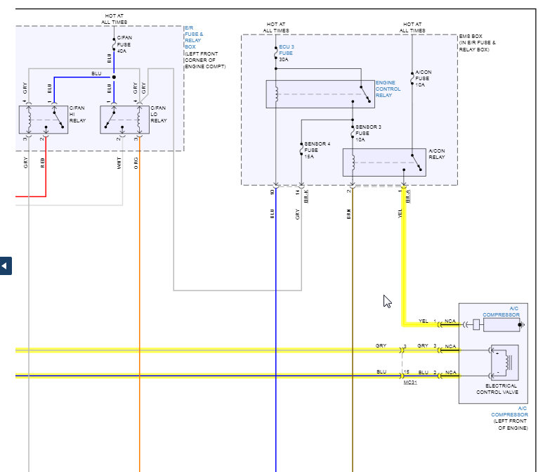

When you are commanding the compressor on with the scan tool you are taking place of the engine control module so we can assume most of the relays are okay but we need to check them as well.
The way this works is the power is feed to the top of the relay through the wire from the sensor 4 fuse and then the sensor 3 fuse. Then when the PCM wants the compressor on it grounds the relay on the AC relay control wire.
So we need to test this wire by putting your red meter lead on the battery positive and then the black lead on this terminal of the relay. Then turn the engine and AC on and if the meter reads 12 volts then the PCM is grounding the relay like it should. If not then the PCM is the issue.
