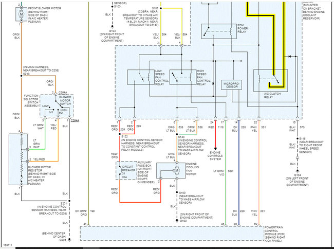

I need to find out where the relay/fuses for the compressor, it turns on by hand. attached gauges while car running, and they read 90 on low and 90 on high side. Checked fuse 24 which is 20 amps and it's good. Checked wires at compressor but both are ground. Also jumped the low-pressure switch and nothing. It has power and ground. There is also this switch, which has two powers and two grounds, tried to jump power to ground and nothing. It may have also caused the fan to stop working after I did that. I think I blew a fuse when I jumped it.

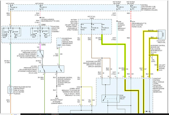

At the compressor, you should have a black wire (which is ground) and a black wire with a yellow tracer (which is power).
If you disconnect the connector from the compressor, with the engine running and the AC turned on, do you get power to the black/yellow wire? That wire comes from the compressor relay and should power the clutch coil, so it engages.
Check that and let me know what you find. As far as the wires, if you have continuity to ground via the black/yellow, pull the compressor relay and recheck. If it still shows ground, the wire must be pinched or broken and is shorted to ground.
Also, I attached the wiring schematic below of the A/C system for your reference.
Let me know what you find

Removed the wire, there is ground, there is no power but sometimes i get a reading that isn't power cause the probe doesn't light or beep and it reads 9.9.

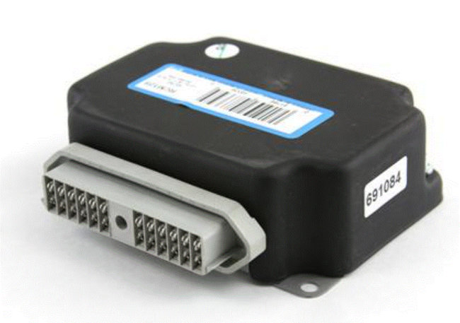

According to the manual, the relay is mounted on a bracket behind the engine. If you want to test it, here are the directions for checking a relay.

Check behind the coolant reservoir. It should be located in the constant control relay module. Keep in mind that some of these relays are integral. If that is the case, the module would need to be replaced. And based on the model year, that may be the case. I attached what the CCRM looks like on the newer Mustangs. See if this is what you find. And as far as the relays are concerned, they are integral. I believe you can take it apart, but the relays are usually soldered onto a printed circuit board.

Replaced the relay module and all is good. Thanks
