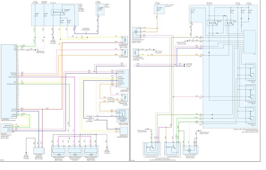

Hello, My vehicle listed above as filled all the information the A/C went out. okay, so the clutch looked shot burnt. maybe I'm answering my own question but any way I replaced the compressor with new clutch and the pressure switch charged and still nothing jumped the compressor so it works all fans work blows cold air... all i need is the compressor to turn on... fuse is good but this car does not have a relay switch is it possible the burnt clutch as i did bench test it and nothing possibly somehow messed up the IPDM board that this model has the A/C relay switch on? Is there a way to test so i'm not replacing for no need if not the problem? hope you can help..
Thank you, Rich

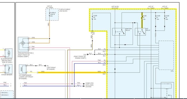

Good afternoon,
The relay is part of the module.
The test you did was for the module as it passed current to the clutch from the microprocessor. The relay is internal and is controlled by the inputs from the pressure switches. It energizes the relay when the proper signal is seen.
You need a scan tool to view the live data from the switch inputs.
Check the fuse listed for power on both sides.
You can still have a bad module in this case.

Hello Roy,
Thank you for your help. you state,
My car only has one pressure switch to my knowledge? And I replaced it... I was told the test I performed if the compressor clutch engages the module is good for all that respond to the test...
If your saying it could still be the module, and if only one pressure switch, could it be fair to say with everything replaced at this point but the module.. It's the module?
I don't have a scanning tool and if i bring it to someone I'll probably spend more than the 130 modular part..
What do you think?
Jun 21, 2019 at 11:59 AM
It is the last step before confirming the module as the failure.
Jun 21, 2019 at 12:36 PM

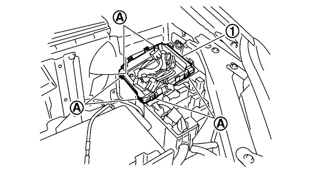

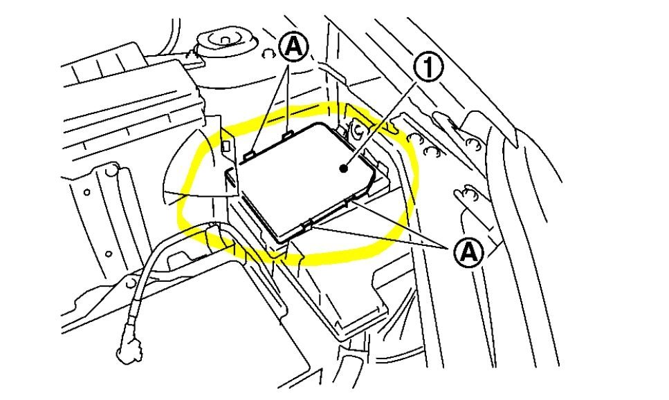

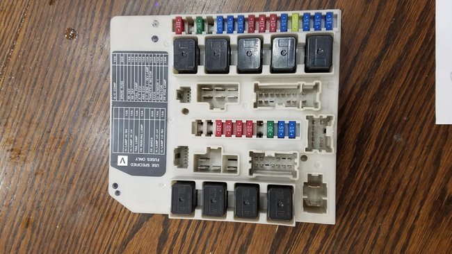

Tks for the advice. Can you supply me with the IPDM part number or even better yet a picture if what the full part looks like? I have an idea but don't want to invest in the wrong part and it seems like there are no photo's online. is this it? (see attached)
Jun 23, 2019 at 10:44 AM

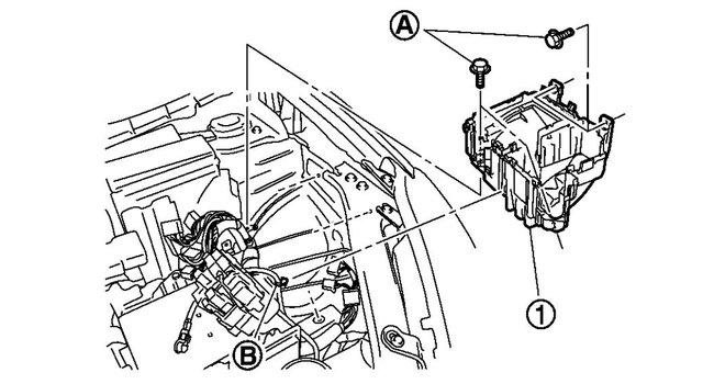

You would need to call the dealer for the part number as they update these part number every couple of years.
Procedure
Removal and Installation
CAUTION:
IPDM E/R integrated relays are not serviceable parts, and must not be removed from the unit.
REMOVAL
1. Remove air duct (inlet). Refer to See: Air Cleaner Housing > Removal and Replacement > Exploded View.
2. Remove battery. Refer to See: Battery > Removal and Replacement > Exploded View.
3. Remove IPDM E/R (1) while pushing and opening pawls (A).
4. Disconnect connectors from IPDM E/R.
5. Remove fuse and fusible link block cover.
6. Unlock all pawls (A) of IPDM E/R bracket, and remove IPDM E/R bracket (1).
7. Unlock pawls of IPDM E/R cover A, harness cover A and harness cover B, remove them.
8. Disconnect connectors connected to fuse and fusible link block upper side, and remove fuse and fusible link block.
9. Remove IPDM E/R cover B mounting bolts (A) and battery cable fixed clip (B), and remove IPDM E/R cover B (1).
Jun 23, 2019 at 7:27 PM

Tks again for the help. the saga continues. I decided to run up to the junkyard and buy a used IPDM module as the new one sells for over 500 ... it's a 2009 same year yes the picture i sent you lines up with the part number form Nissan 284B6JG03A so yes the picture i sent is the box/module in question... i put it in and nothing no change at all i know a local mechanic so i figured rather than paying Nissan 150 an hour to diagnose the problem he is good and should be able to help out, well he was as lost as i am as he got to the same point i got, but he said the module need to be programmed when replaced?? do you know if that's the case?? oh and to really just throw a monkey wrench into this whole dilemma... guess what happened as i was getting ready to take the car to my mechanic?? yep the AC clicked on i thought wow maybe the new/replaced module needed time to be recognized no need to go to the mechanic?? but after cycling on and then off once it stopped working ever since which is why i brought it to the mechanic... any other advise kind of weird that two modules are bad with same issue?? no?
Jul 4, 2019 at 1:51 AM
Okay, first a used module is never a good idea. The numbers may match up but the used unit needs to be flashed or programmed to your car, not the junk car.
Anyway, if it did work then it was failed. The issue is what caused it to fail. Voltage spikes are the common issue for the failures of the ECM.
I am afraid that if you get another one, it will fail as well unless you or someone finds the reason it failed.
Jul 4, 2019 at 2:04 AM
