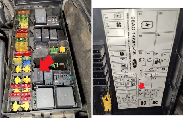

- I tested #9 and #6 with test light and they tested good with key on. I also removed and physically inspected for broken wire. They are good.
- I have attached the picture of the fuse box with red arrow pointing to the relay I tested.

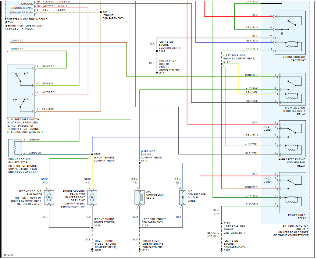

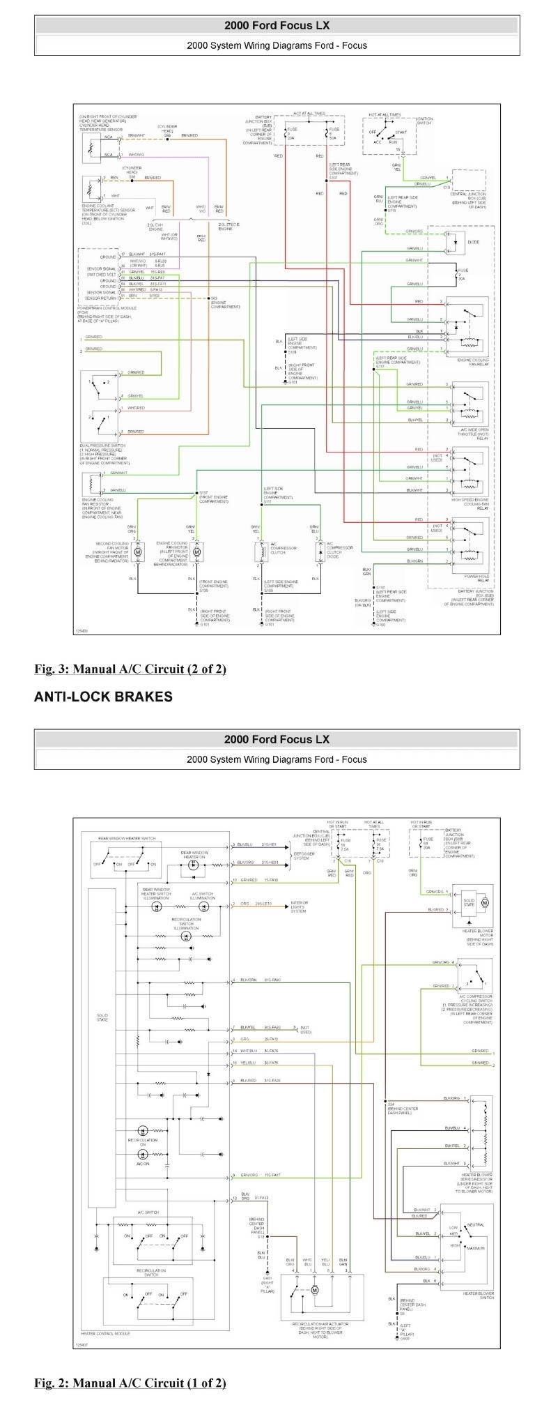

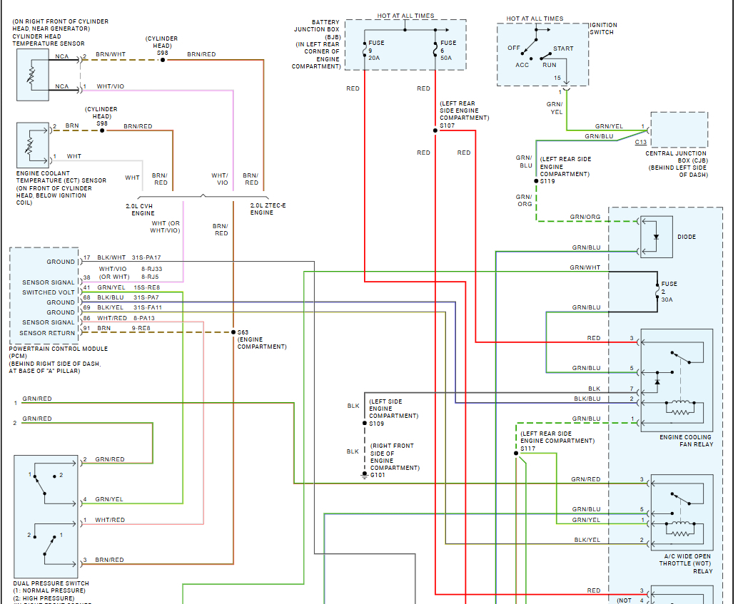

- I have also attached the ac wiring diagram.

Sorry, I for got the wiring diagrams, but it looks like you have them already. So the Cut Off relay is controlled by the ECM. So if the ECM think the engine is overheating it will not turn the AC on. Have you run the codes to see if any are present? Also, when you get 12 volts a the compressor coil does the compression clutch engage? If not the ground is bad or the clutch coil is bad which is common.

The system has two pressure switches. One on the low pressure line with two wires and the other is on high pressure lines with four wires. From the wiring diagram, it looks like that the high pressure switch should have an open between brown/red and white/red terminals, and continuity on the other true. The readings at the terminals show the same.
