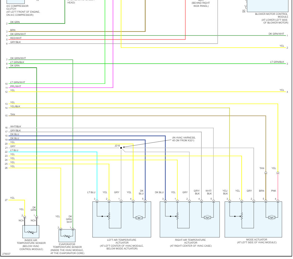

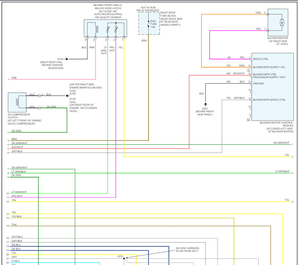

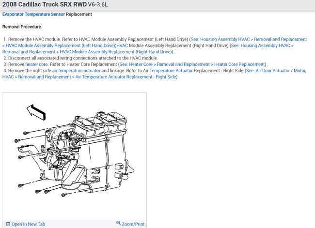

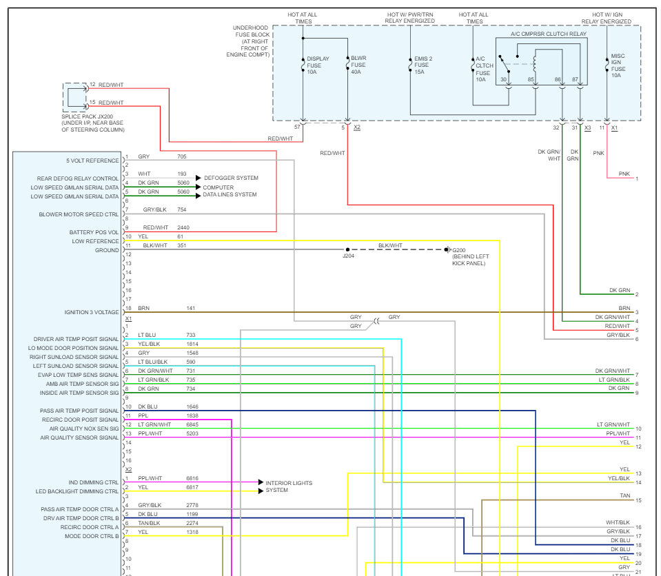

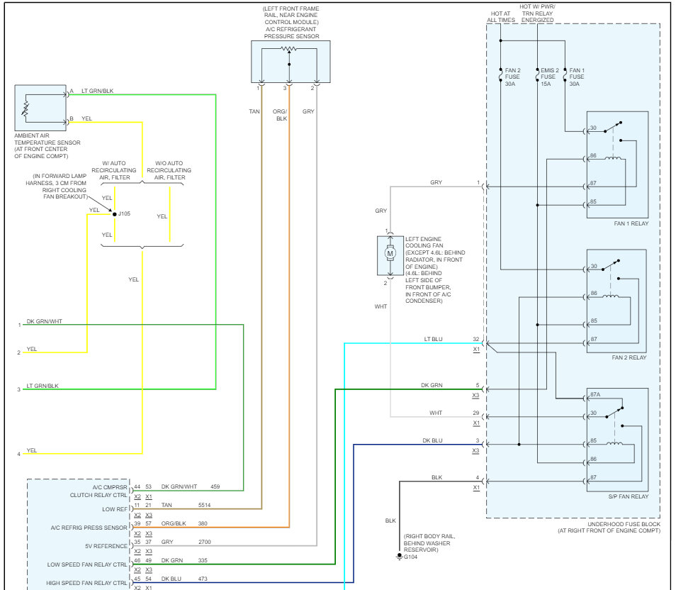

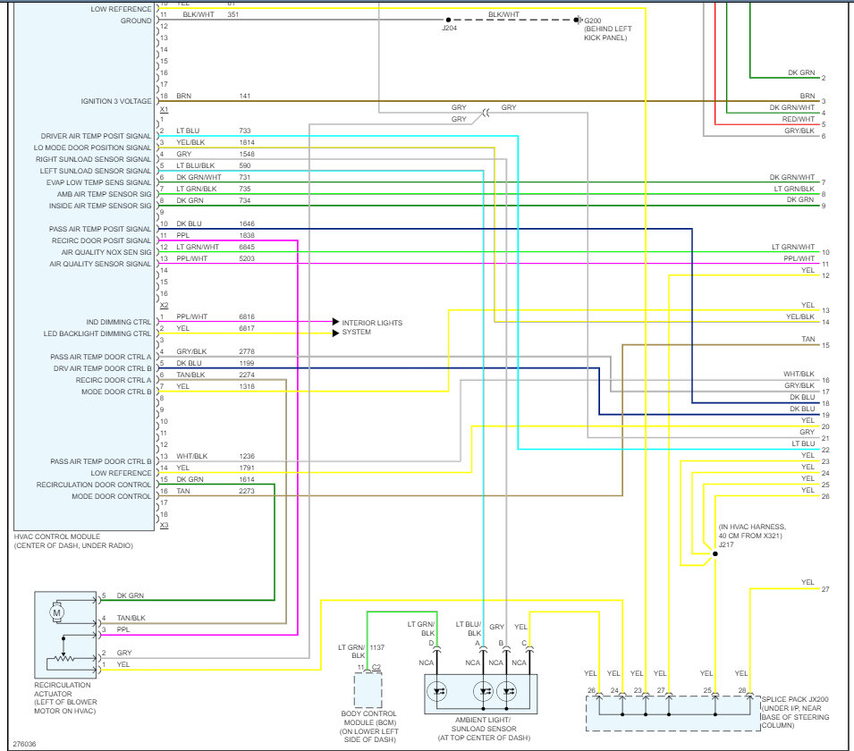

We have gotten the error code
B3933:06 AC evaporator temperature sensor circuit short to ground/open
We can get the compressor to kick in when we use a jump wire at the relay, so we replaced the relay, however we are still having the same problem.
I have called the Cadillac house to find an evaporator temperature sensor however they cannot find anything like that for this vehicle and have suggested it’s the actuator temps level. We’re not sure what to do now.

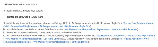

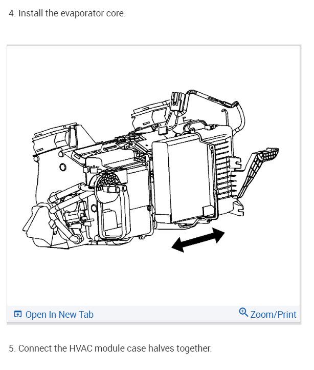

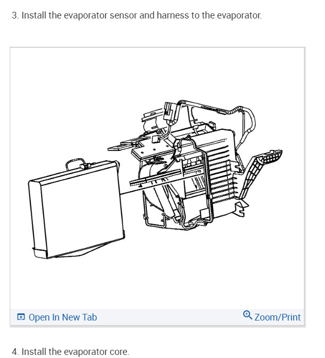

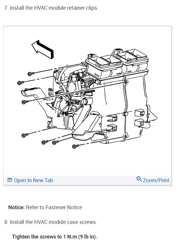

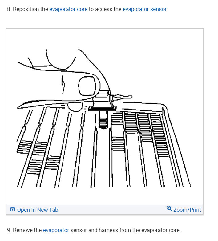

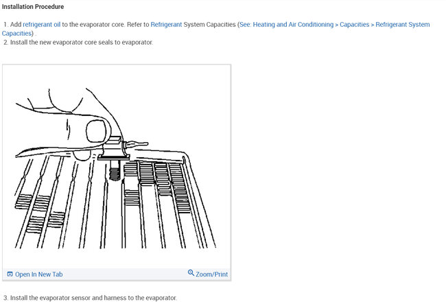

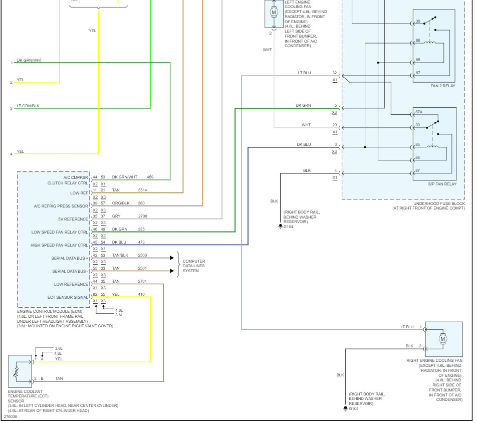

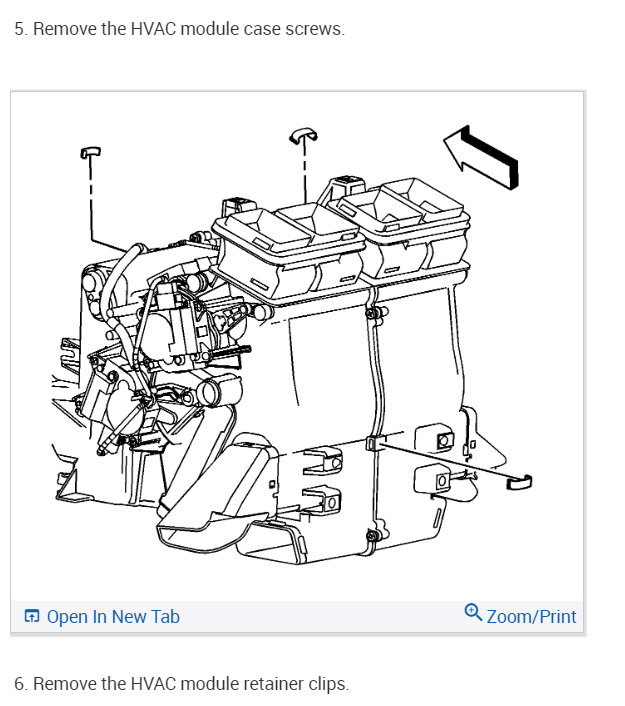

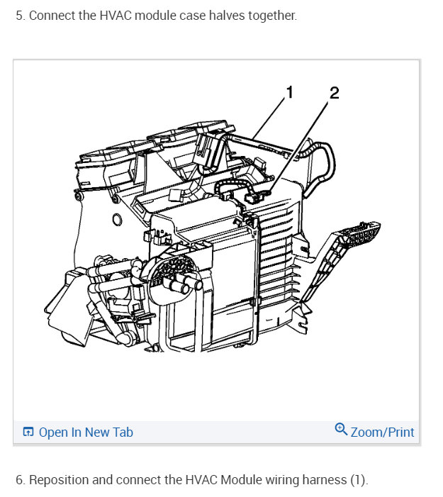

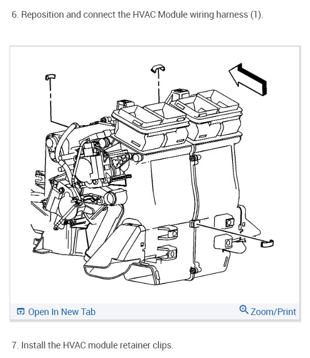

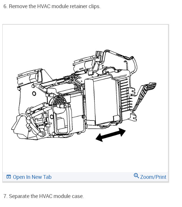

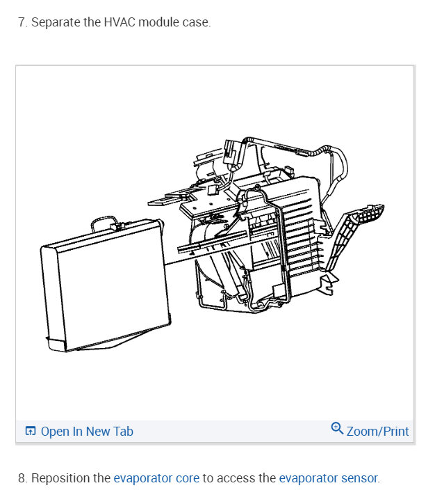

Yep, the evaporator temperature sensor is inside the evaporator case, here is a guide to help you test the connections and the HVAC system wiring diagrams so you can see how the system works and which wires to test. Also, I have included how to change out the sensor as well.
