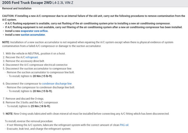

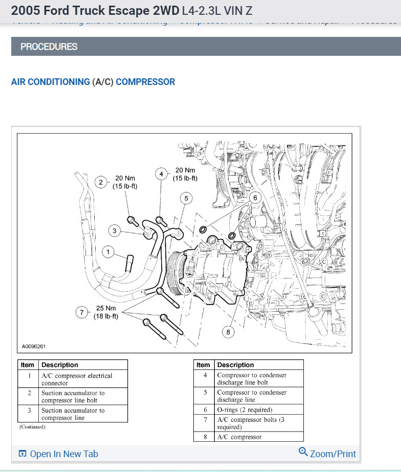

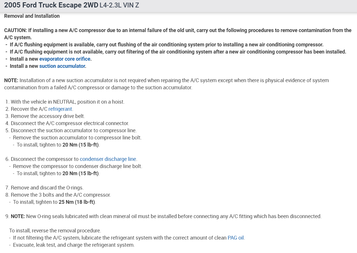

When I turn on my air conditioner as soon as it clicks on it blows two separate fuses under the hood. The A/C clutch fuse and HVAC fuse are the two that keep blowing.
Jul 30, 2023 at 6:55 AM
  • 55,423 POSTS
Yep, this happens when the A/C compressor clutch coil shorts out so it will need to be replaced. They may service the clutch coil separately but if not the compressor as a unit will need to be replaced. Here is a generic guide to help you step by step with instructions in the diagrams below to show you how on your car:
https://www.2carpros.com/articles/replace-air-conditioner-compressor
And this video will help as well:
https://youtu.be/4EqdrBVb0sY
Check out the images (below). Please let us know if you need anything else to get the problem fixed.
