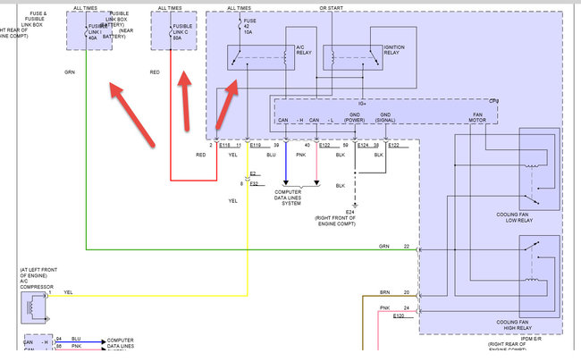

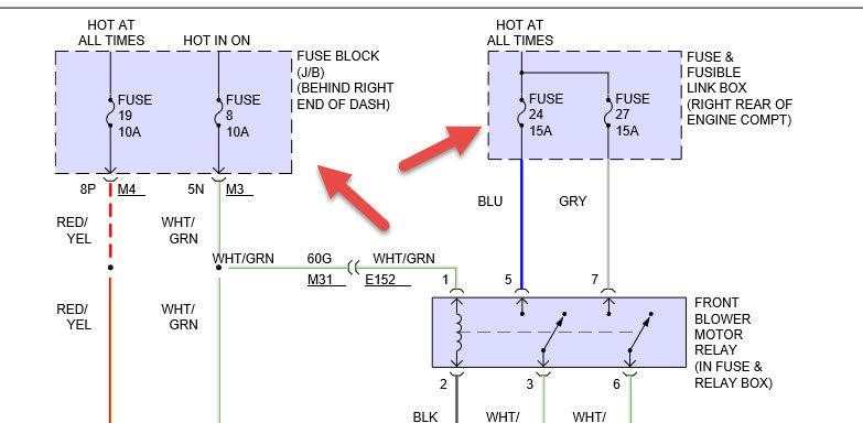

check fuses and compressor relay under hood if Freon level is ok. the noise you hear under dash is probably the blower so don't worry about it they are loud if compressor turns over then it still could be bad as it has valves in them and that is what goes bad on it. check items in pics then have it scanned for codes by a mechanic you can trust. I am assuming this is manual a/c where you DO NOT set temperature . if it's auto temp control where you set temp this has to be scanned to see why it's not working. but if all the stuff I have in pics is good then it has to be scanned as well.

Thank you hmac300 for the pictures. I will check this evening.

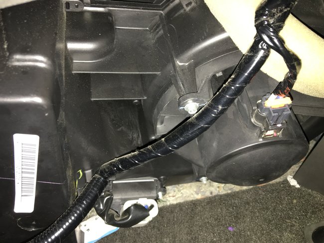

Ok guys thanks so much for all your help this has been an amazing experience to be able to run things past people that actually care about you and not a dollar sign. We have COLD air finally!! I have one more issue now. The blower fan under the dash is still kinda loud but it's making a squeaking noise and chirping noise. It's driving my wife crazy! The noise does get louder with fan setting higher and vice versa. I'm thinking it's just the blower and am wondering if it's something I could fix myself. Seems like they go online for anywhere from $60-$140. I have attached a picture from where the sound is coming from. I tried a video but it won't upload. It looks like four screws holding the fan blower on and one electrical connection. Is there a huge difference between the ones that cost so much and the mid range ones? I know you get what you pay for so I'm thinking the $50 part may not be the right choice. Thank you again for everything.

i personally do not recommend parts but on rock auto one comes with the fan and that would be your easiest thing for you to replace but you never know on parts. it's about $45 without shipping. what fixed the problem with the cold air?

Ok thank you I will check out rock auto. What finally fixed the air was the clutch was bad on the compressor. Apparently you can buy just clutches for some vehicles but ours was not one and so we had to buy the whole compressor. Got that put on and everything worked fine except the blower making noise.

Good to hear we helped you get the problem fixed, now it sounds like it time for a new blower motor, here is a guide that can let you know what you are in for
