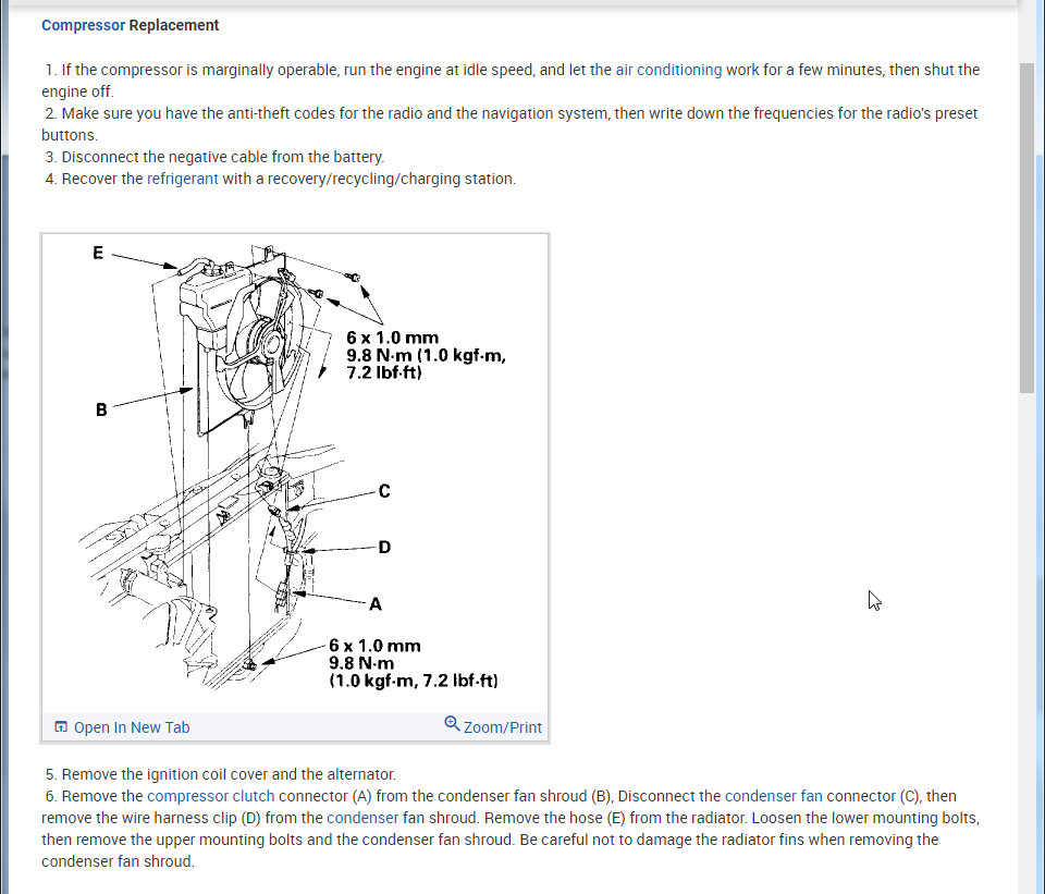

My A/C does not work. it’s coming apart. can I replace the A/C compressor?
Apr 5, 2019 at 7:01 AM

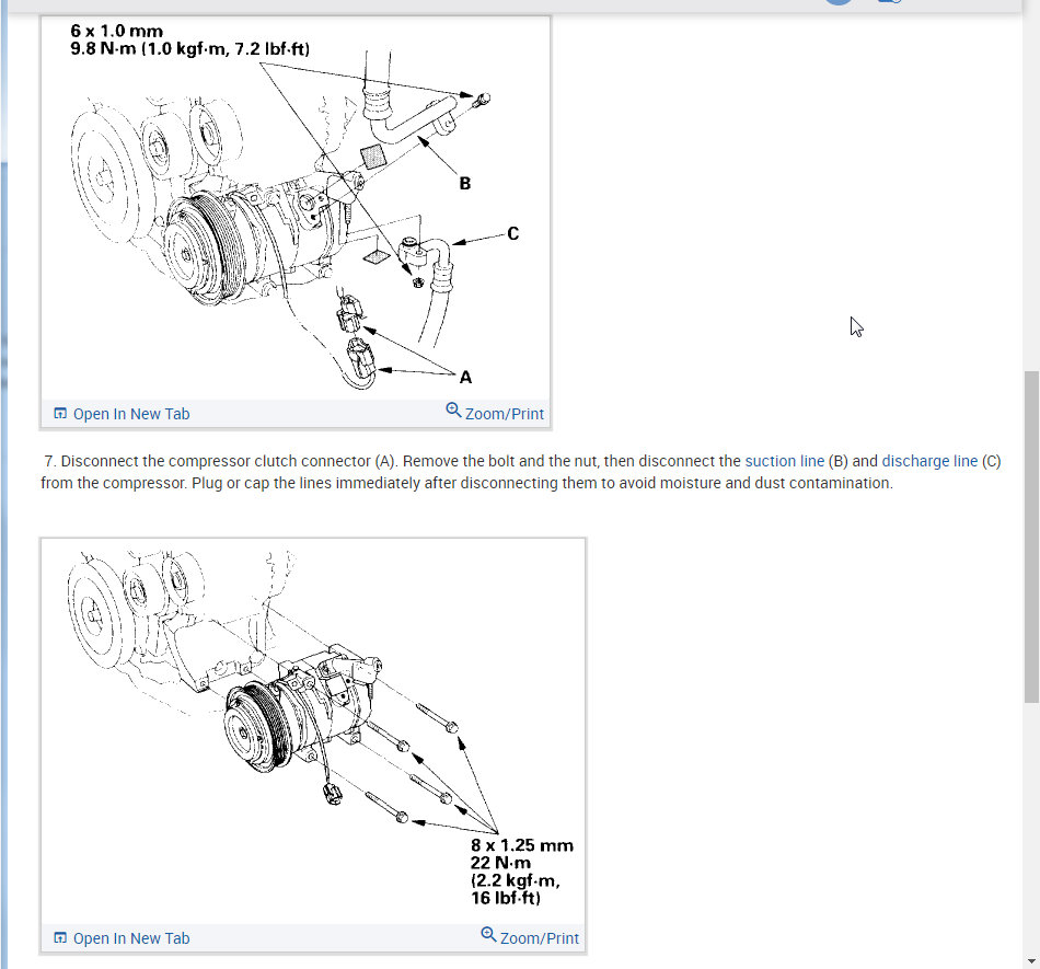

Unfortunately these compressors are just very different and are not interchangeable. They will not bolt up in the Honda's location nor will the belt be aligned so it will not stay on when the engine is turning.

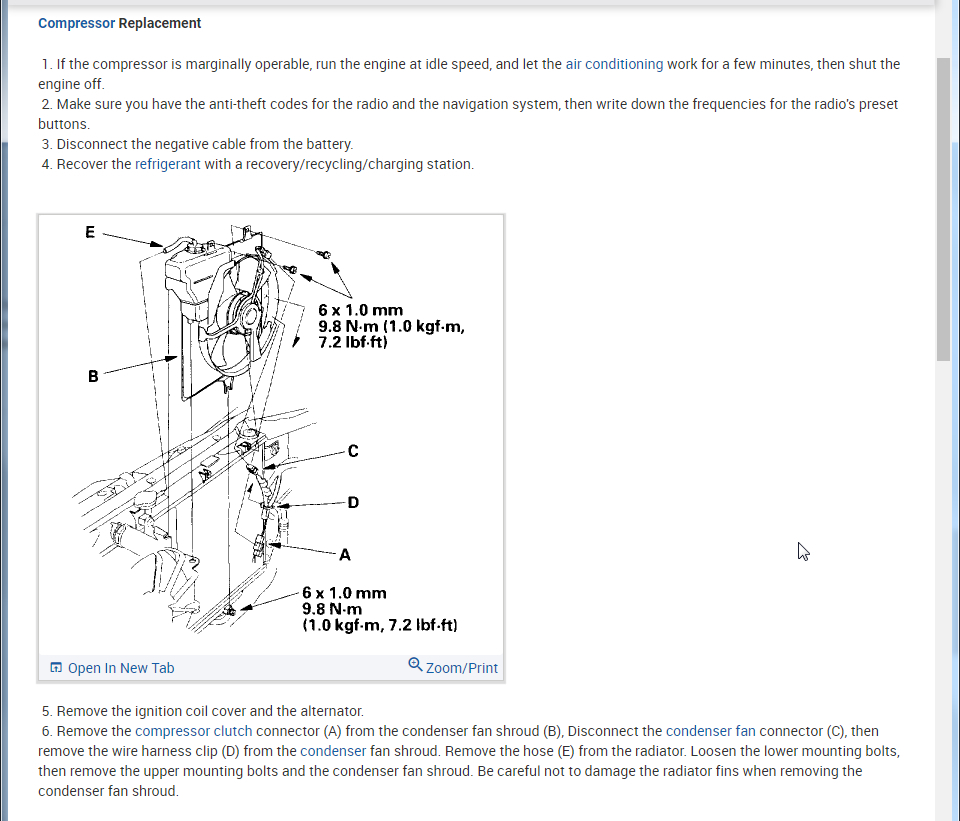

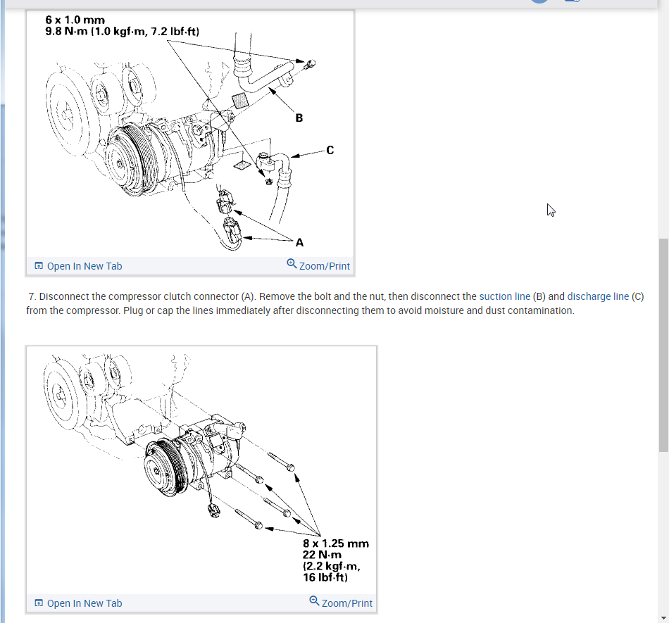

I am attaching the process on how to change the compressor from the manual. Please review the material below.
Also, here is a guide on how to replace the compressor which should help as well:
https://www.2carpros.com/articles/replace-air-conditioner-compressor
Thanks

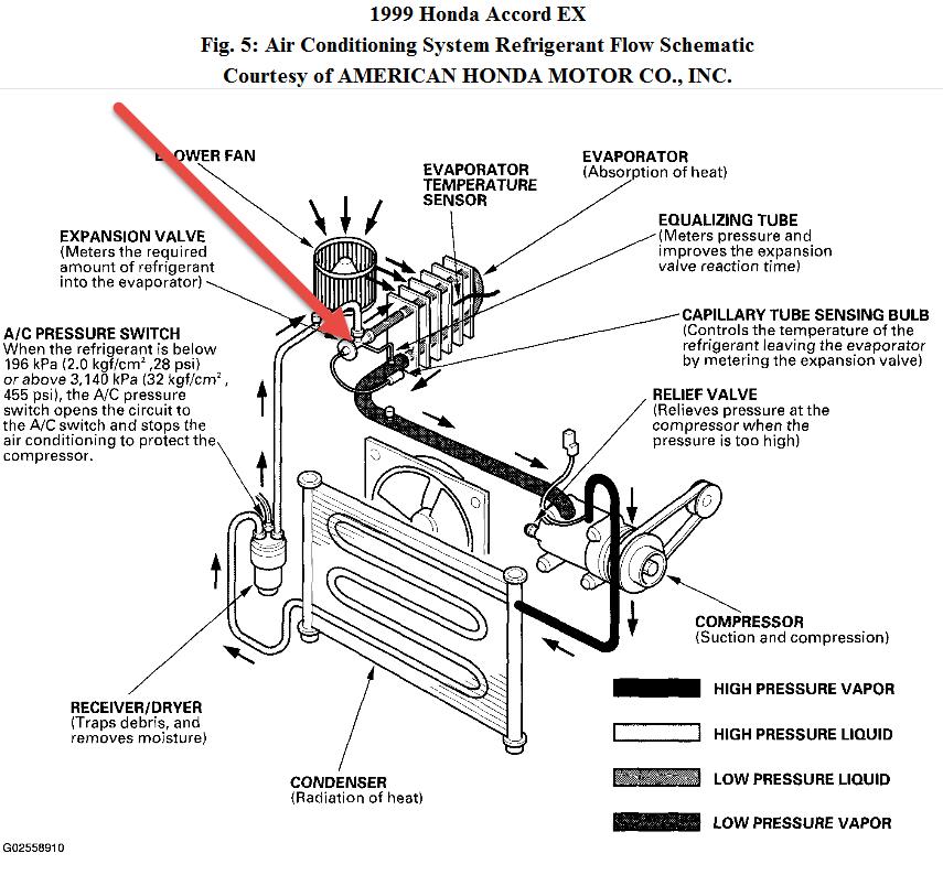

I'm replacing the compressor & it was recommended I also replace the expansion valve & filter drier. Is this necessary? If so, where is the expansion valve located? I've found the filter drier, but not the expansion valve.
Are there any hints or tips for replacing the compressor? Thank you for any & all help!
Dec 17, 2020 at 1:31 AM (Merged)
HMAC300
  • 48,601 POSTS
Yes it is necessary as well as back flushing your a/c system form orfice to compressor to get all the debris out. It's also imperative to pump the system down with a vacuum pump for at least 30 minutes
