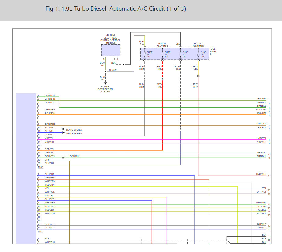

I recharged the system, changed the solenoid valve on the compressor and still nothing happens. Is there any way to run the compressor bypassing some sensors?
Jun 23, 2019 at 4:17 AM
  • 55,746 POSTS

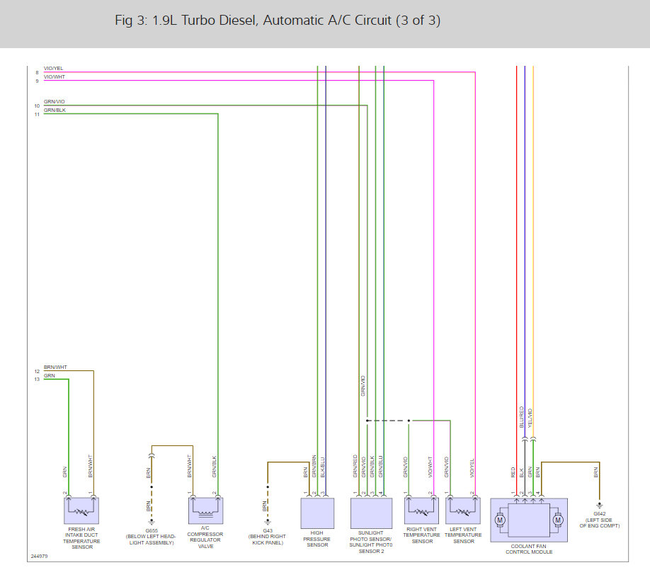

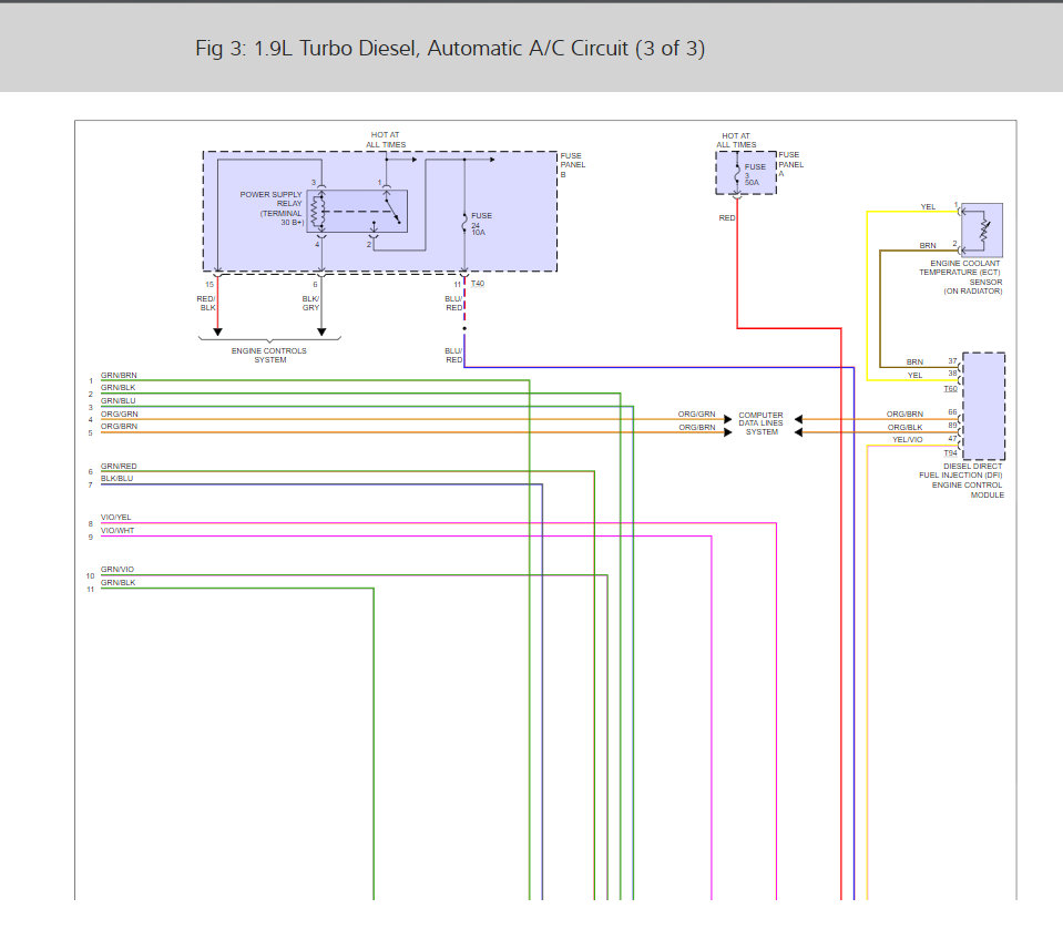

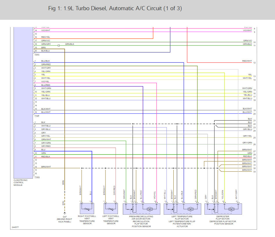

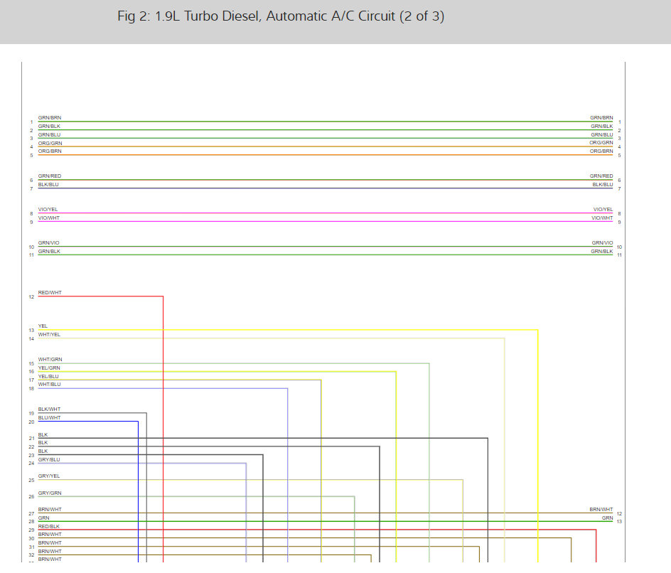

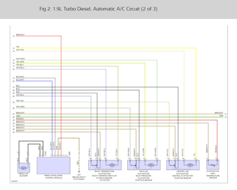

That compressor has an internal clutch so it is hard to tell if the compressor turns on or not. here is the wring diagrams so you can see how it works. there is a relay and fuses that run the system which I would check and check with a test light if the compressor is getting power. Here is a guide to help you:
and
The wiring diagrams show the fuse and relays to check. Check out the diagrams (below). Please let us know what you find.
