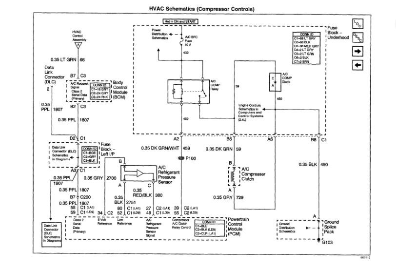

Checked Freon and pressures good, if I pull relay and jump terminals 30 to 87 compressor will run and cool down, the switch on panel is on for AC and the fan switch is on. The system seems good but electrically not so sure of. It has three wire switch on high side line cannot find low side.

Okay, the PCM is what grounds the control side of the relay when it gets the correct signal from the pressure switch.
You have a 5 volt reference, a ground and a signal wire that go from the pressure switch back to the PCM.

Okay, the 35 and 135 are not bad.
You will need to check that transducer or switch.
Back probe the switch. You should have 5 volts on the feed, one is ground and the other is the signal. Can you tell me the voltage on the signal wire?

Okay.
You need to check the wire at the PCM next. Check the diagram and go to the connector and pin number. Back probe the wire for the relay control. See if there is any voltage there with it hooked up to the PCM.

Okay, you need to check the wire from the relay to the PCM. It is the dark green/white wire from the relay to the PCM. You need to see if there is voltage at that wire at the connector.
With the plug removed you should have voltage and when you plug it in, it should not have voltage.

I pulled the relay and probed the coil side of the relay in the base of the connector and I had power with relay out twelve volts, I reinstalled the relay and had some jumpers in with relay prongs and when I plugged the relay back in I lost power to the coil side of the relay. The voltage I had was twelve volts. I am assuming there is a triac output in the PCM is the reason for this?

The control side power is controlled by a fuse from the fuse block. The ground for the control side is controlled by the PCM and that is based on the signal from the pressure switch.
If the dark green/white wire has voltage, then it is not being commanded to ground. It should 0 volts if it is grounded.

Carried car to shop and put the scan tool on it and the following is what we found:
1. The high side pressure sensor was reading or showing (444.92 psi).
2. The high side pressure sensor volts was (4.92 volts).
3. A/C relay command was (off).
4. A/C request signal was (no), but we had the switch on and blower on.
5. FC relay 1 command was (on).
We drain system and pulled the orifice and was very dirty and had look like alum metal shavings on it. I feel like the condenser maybe stopped up? So at this point I am not real sure if I need to replace it all and do not mind if it will fix it. We tried to force the compressor on with scan tool and it would not come on. Said it was on by the screen, so that is the problem is something else bad also like ECM also. Strange but the small line from the evaporator was ice cold but the large line was cool and got cool air out vents for a minute and then warmed up when we where checking everything with the jumper in contacts on relay base. Also, wondering about the high pressure seems real high. And I do need one of these scan tools they are nice?
Jun 20, 2018 at 12:59 AM
Okay, yes 400 is way high. The aluminum is the key. I would suggest a compressor, condenser, orifice and a dryer. Flush the system of all debris.
