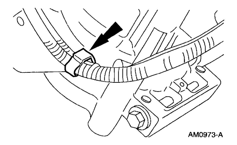

4. Remove the drive belt from the A/C clutch pulley. For additional information, refer to Drive Belts, Mounts, Brackets and Accessories.

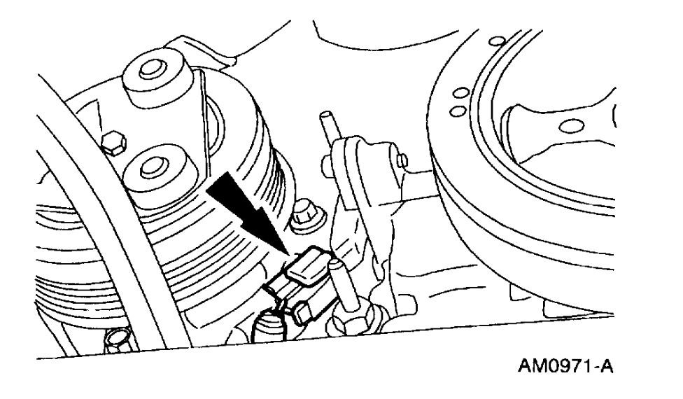

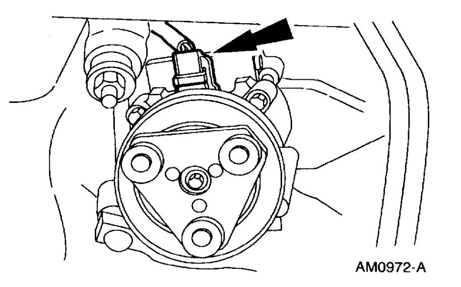

5. Disconnect the wire harness connector from the crankshaft position sensor.
6. Disconnect the connector.
7. Disengage the wire harness retainer from the bracket.

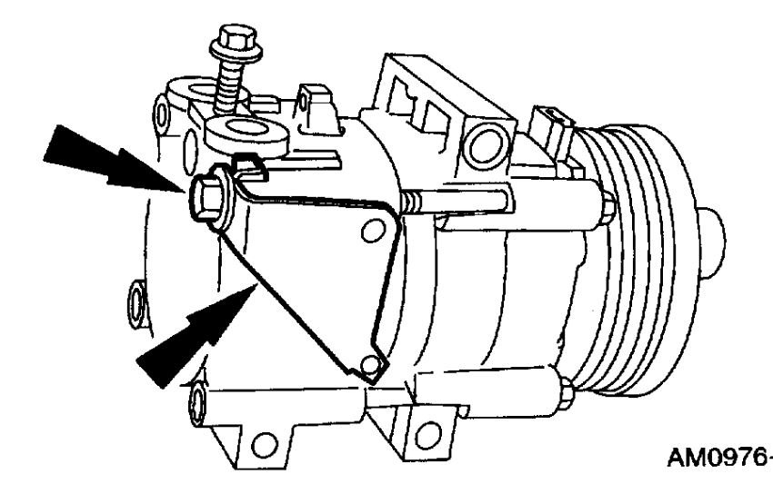

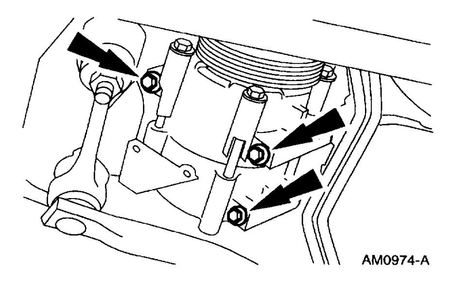

8. Remove the bolts and lower the A/C compressor.
9. Remove the A/C compressor.
1 Loosen the bolt.
2 Remove the A/C compressor.
10. Remove the bolt and remove the bracket from the A/C compressor.

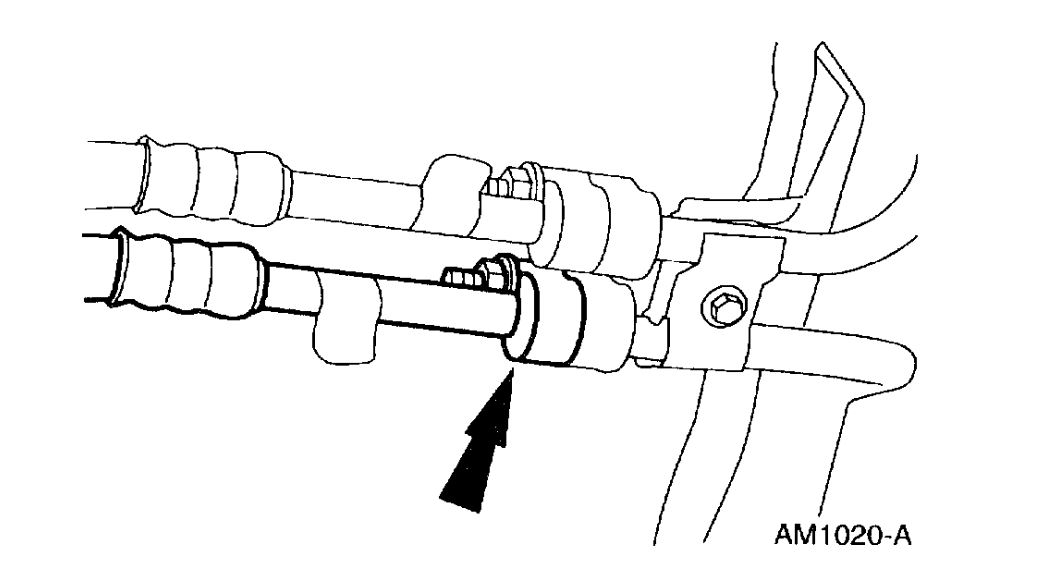

1. Perform the Refrigerant Discharging and Recovery Procedure.

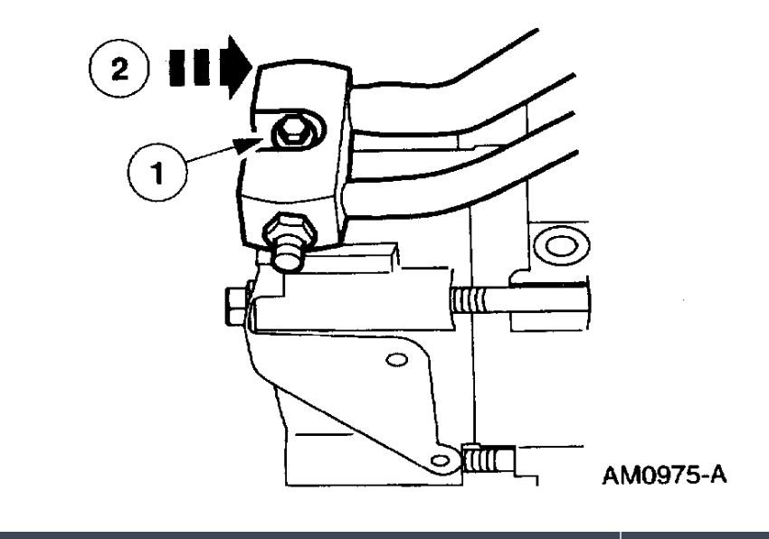

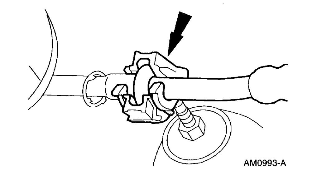

2. Disconnect the condenser to evaporator tube from the A/C evaporator core. For additional information refer to the spring lock couplings disconnect and connect general procedure. See: Coupler HVAC > Procedures > Spring Lock Coupling Connect and Disconnect Procedure
3. Disconnect the condenser to evaporator tube from the A/C condenser core and remove the condenser to evaporator tube.
