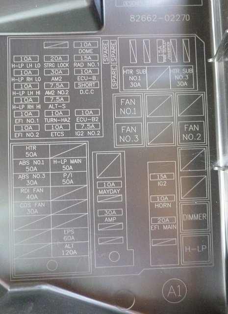

I checked the fuses in the box under the hood. All okay. I have to do some reading on how to check relays. I have not looked at the fuse box inside the car yet.
Attached is a picture of the diagram on the underside of the fuse box under the hood. I'm not familiar with some of the abbreviations there, so do you see anything that would be related to the AC system there? Or should I be looking at the fuse box inside the car located under and to the left of the steering wheel? Or both?

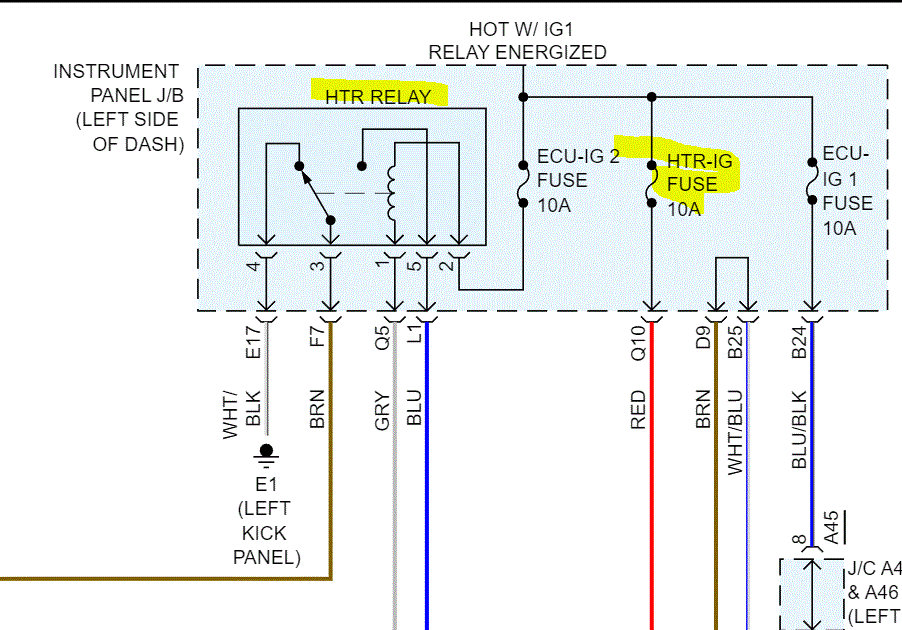

I'm not seeing anything there. As far as testing a relay, here is a link that explains how it's done.
Interestingly, the relay and fuses are in the vehicle. See pic 1 below. Note: It says htr fuse, but that also powers the ac switch. Battery voltage to the compressor is then provided via the AC amplifier.
Let me know what you find.
See pic below.

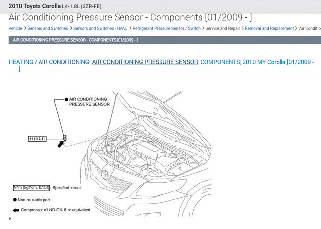

  • 110,251 POSTS
I believe there is only one pressure sensor if I recall on this vehicle. I attached a pic below.
Is that the one you are referring to?
Also, if you are getting power to the compressor and it has ground, something there has failed. Some of these don't have a traditional clutch, instead, there is a clutch solenoid that actuates the system.
