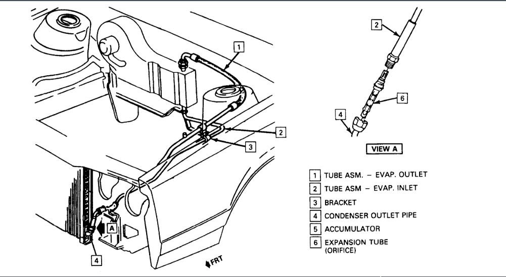

I have put a new compressor but no o ring seal or a ac Orifice tube how do I put the Orifice tube at and is it too late to put everything on now

I attached a picture of the location of the orifice tube for you.
You need to recover the Freon to access this. The tube comes with seals on it but you need a new seal for the line.
Did you replace the dryer as well? Since you had the system open, you must replace it.
