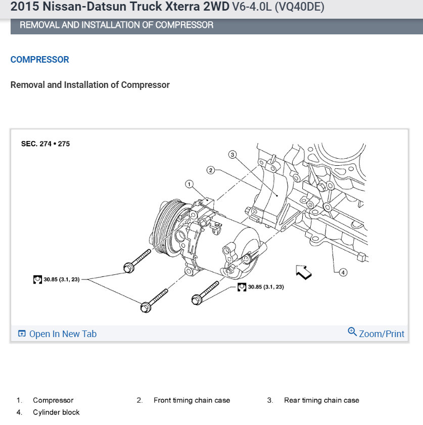

Where is the A/C compressor located in my vehicle listed above (Hybrid)? The A/C was not working sometimes but was rectified by switching off then back on the vehicle. But today it stopped working totally.
Oct 16, 2018 at 11:47 AM
  • 55,214 POSTS

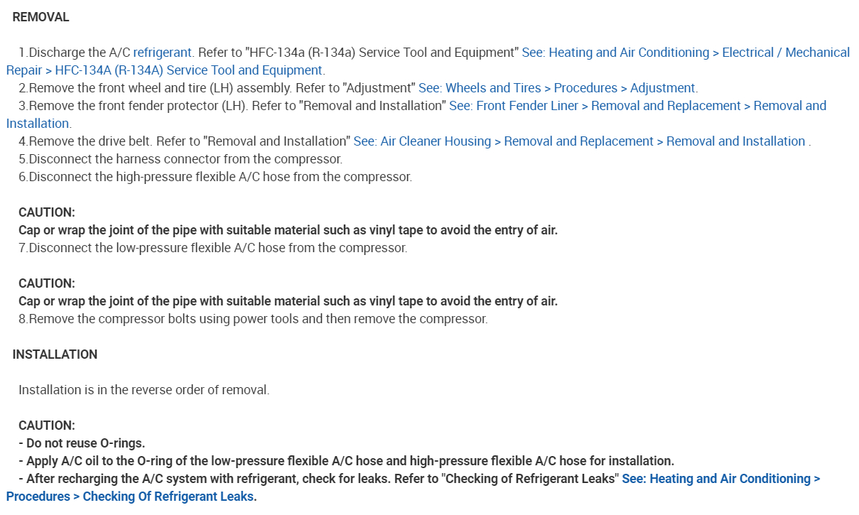

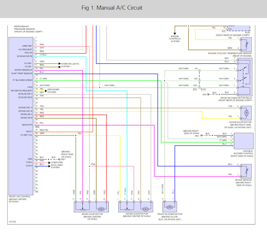

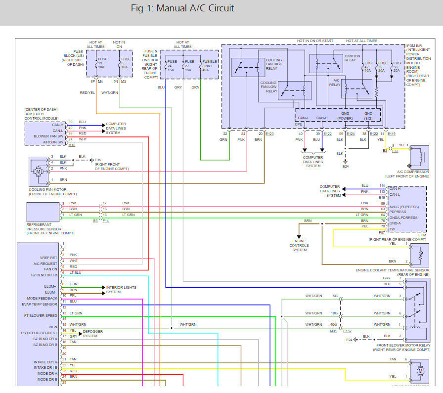

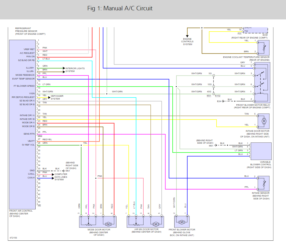

There are two styles of AC system on these cars both have compressors but only one uses a belt powered by the engine. The compressor should be on the lower left hand side of the engine. I would check is for power at the compressor with the system on to see if it is the compressor or something electrical. Also I would check the pressures.
Here are diagrams and diagrams below to help see what is going on:
And to check for power at the compressor.

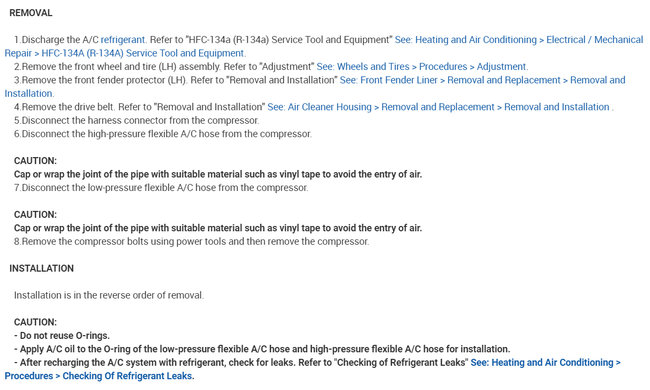

If the compressor is bad
https://www.2carpros.com/articles/replace-air-conditioner-compressor
