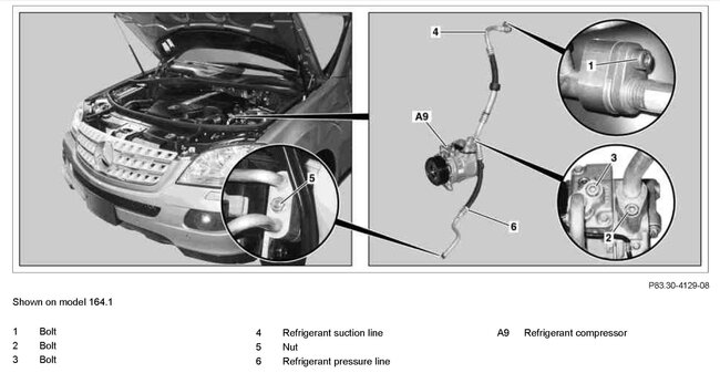

How do I determine what to replace besides the compressor? The A/C was blowing cold prior to pulley freezing up. Examples: Should I replace the condenser, do an A/C flush, replace all the seals? I have access to a vacuum system.
Sep 3, 2024 at 5:50 AM
  • 55,381 POSTS

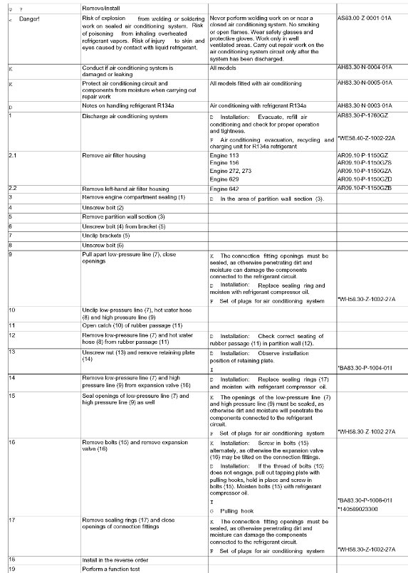

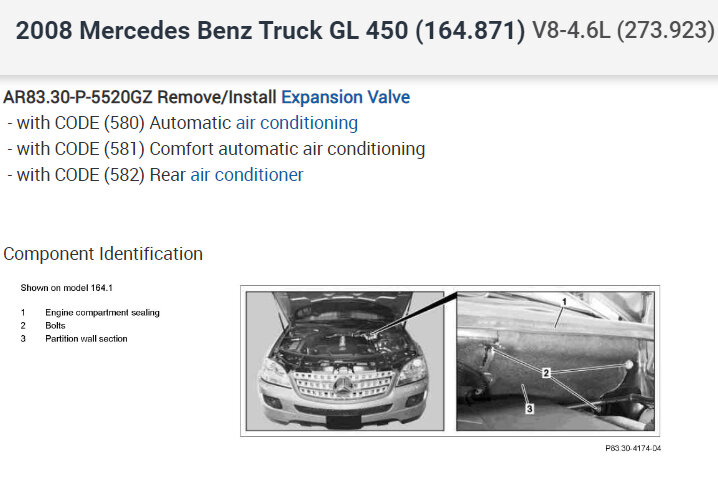

If the compressor came apart internally it will spread metal and seal material throughout the system so it will need to be flushed and the expansion valve replaced. Can you tell if there is debris inside the refrigerant tubes?
Here is a video to help with the job and how to change out the compressor and expansion valve:
https://youtu.be/4EqdrBVb0sY?si=tqE2yNp1wekpSNq3
Check out the images (below). Please upload pictures or videos in your response of any problems so we can see what to help you with.

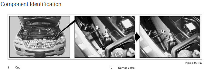

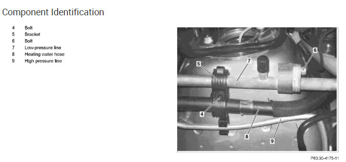

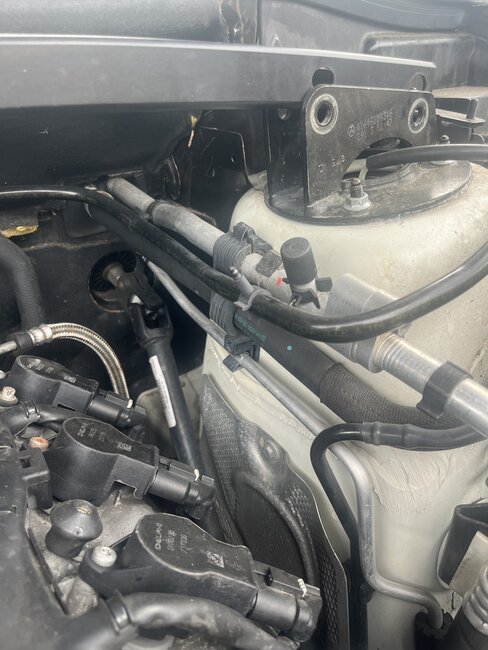

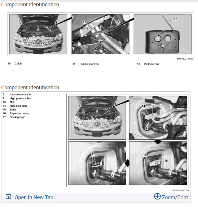

Thank you for the prompt response. I'll break it apart, and report back. Does my AC system have a high side port? I could only find the low side. The low-pressure port is centered no obvious high side. Thanks
Sep 4, 2024 at 1:01 AM
  • 55,381 POSTS
The high side pressure port will be on the smaller tube (liquid line) which is at the condenser in the front of the car. Check out the images (below). Let us know how it goes.
Sep 4, 2024 at 3:18 AM

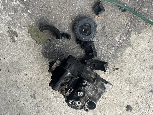

Found it, thanks to you! Here's where I'm at now. I will remove the old locked up ac compressor. Then inspect for metal particles in the line.
I'll report back to you then. I'll hit this job Monday next week. Does this sound like a plan?

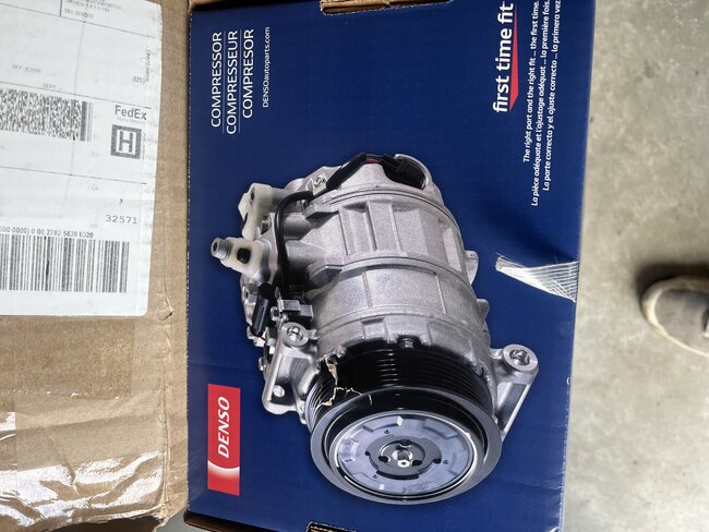

Removed old A/C compressor. I purchased OEM Denso.
1) New A/C compressor appears to be an exact match. The new comp does not have any instructions. Did you know if the new ac compressor arrived with the correct PAG oil, and with the correct amount of it?
2) The high and low coolant lines, do not appear to have any metal particles in it.

Wow, that compressor came update all right lol. I would do the dryer which is a normal service item when doing AC work. DENSO is pretty good about adding the correct amount of oil that is high quality as well, (they don't want the compressor to come back) you can add 2 ounces extra to be safe. Let me know how it goes.

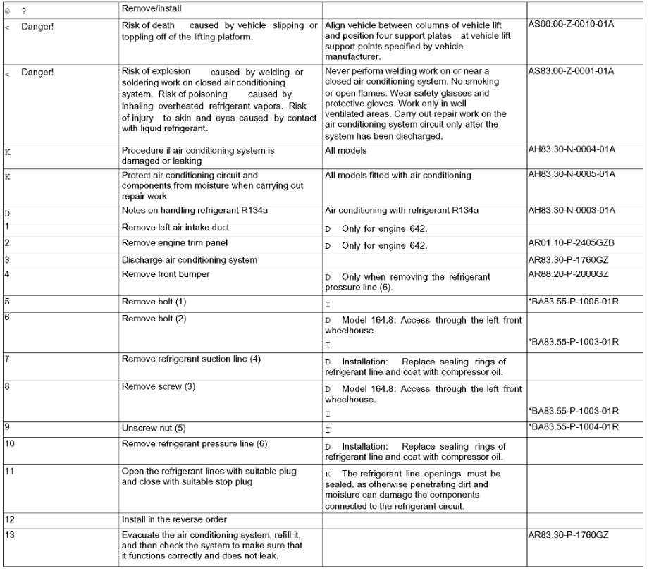

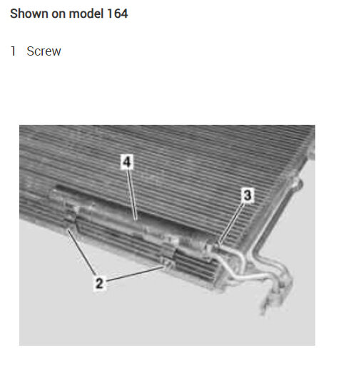

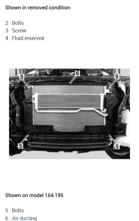

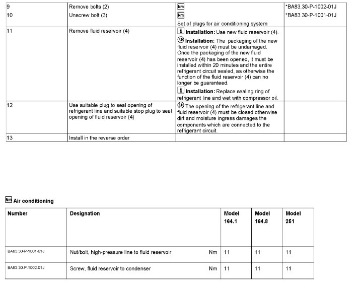

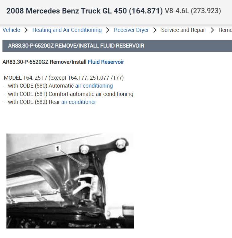

1) Can you send the procedures to replace my 08 MB GL450's ac drier?
2) You recommended that I add 2 ounces of PAG oil to the new DENSO ac comp. A. What type PAG oil? Which whole should I add it to?
3) Are new O rings necessary?
Thank you
Sep 9, 2024 at 8:01 PM
  • 55,381 POSTS
Hi Joe,

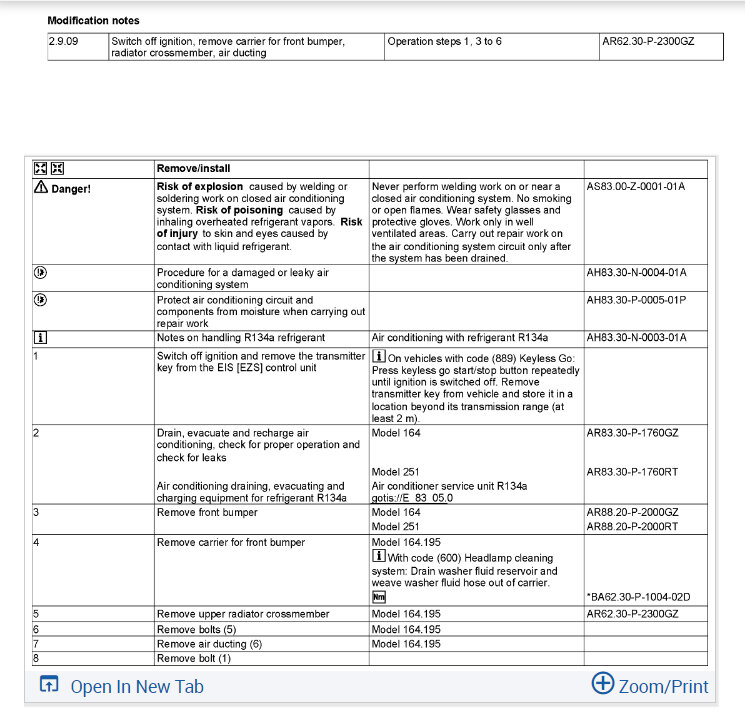

You want to use PAG oil from the auto parts store should be fine, I would use new O rings for sure. Here is how to replace the receiver dryer. Check out the images (below). Let us know how it goes.
Sep 10, 2024 at 2:34 AM
