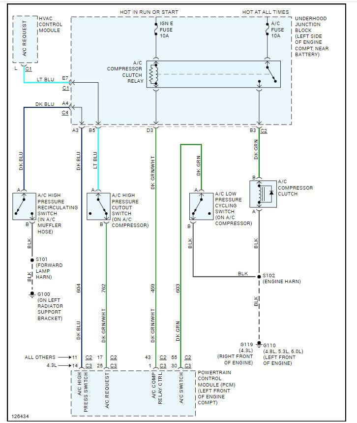

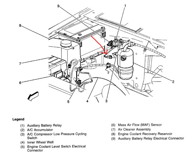

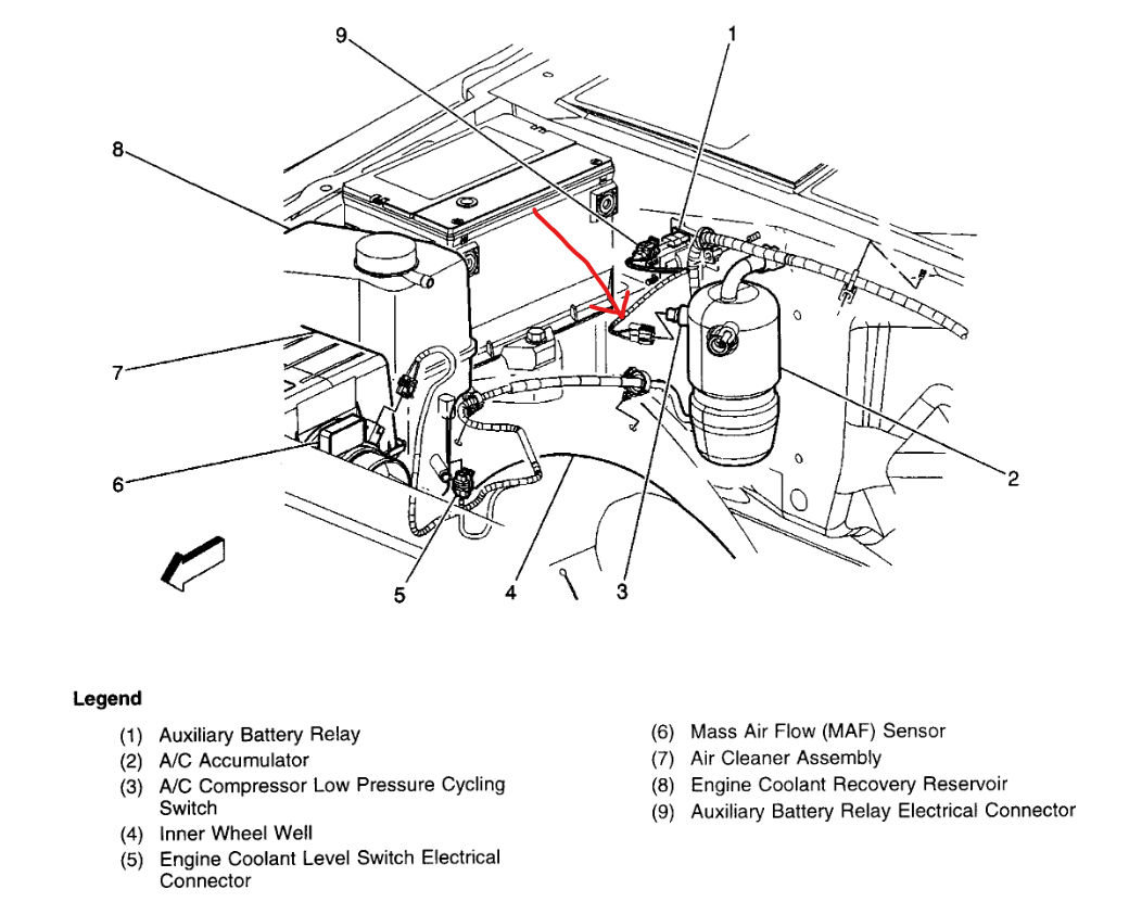

Does the compressor run if you jump the low-pressure switch? The blk and drk grn wires? Here is the location of the pressure sensor and the wiring diagrams for the compressor circuit so you can see how it works. Please go over this guide as well:
Check out the images (below). Please upload pictures or videos in your response of any problems so we can see what to help you with.

Negative, no change when jumping low pressure switch.

The low side is at 35 psi and the high is at 225 psi when I jump the relay.

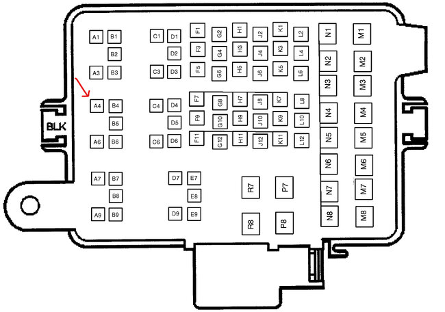

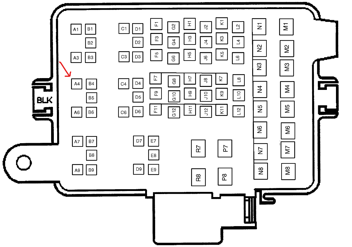

Can you please check the IGN1 fuse for power and make sure the fuse has power?

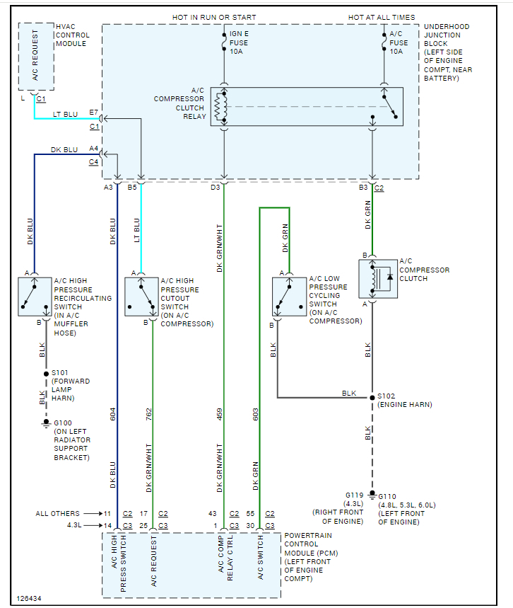

Also, did you swap out the AC relay? Also, there are high pressure switches on the back of the AC compressor that can be jumped which if the compressor comes on the high pressure switch needs to be replaced. Check out the images (below). Let us know how it goes

I swapped out the relay with the horn relay that I know works, no change. I will double check the fuse.

Yep, see if there is power at the fuse as well.

Omg, the fuse was fine, bypassed the high pressure switch and it works! Problem found! Hooray! Thank you sooo much, I figured a view from outside would help.
