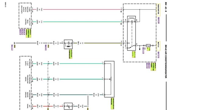

I was planning to replace a new serpentine belt and a AC condenser today. So I replace a new serpentine belt due to the damage of the original belt that broke and shredded. After I replaced a new belt. It sounds like there was a clicking sound that just recently started right after I installed the new belt. Before trying to attempt replacing a condenser. I have noticed that the clutch is not engaging when recharging through the low pressure system with an AC dye/Freon rechargeable. My goal is to make sure to find the exact location of the leak before taking it apart. I tried to bypass manually through the relay and found unsuccessful with that procedure. I cannot seem to engage the AC clutch. Is there another way for me to diagnose if the clutch and the AC compressor is still good or defected?

You can run a wire from the battery to the AC compressor to see if it engages.
I attached a wire diagram for you to view. At the relay, test for two powers with the key on. If there is power, then you need to check the pressure switches. They send a signal to the PCM to ground the control side of the relay.

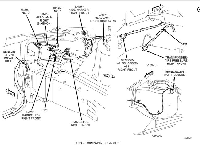

Is there a possibility you could direct me the location of the pressure switch? I am more a visual learner such as photos and images. Diagram is a bit complicated for me since I am no expert and only know the basics. Would love to expand and learned more. Thanks for your help.

Happy to help. It looks like the sensor is by the passengers side strut tower. Here is a diagrams that helps you see the locations.
