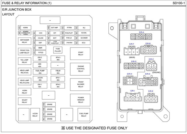

A/C clutch relay location
2009 KIA SORENTO
70,000 MILES • 1.8L • 4 CYL • 4WD • AUTOMATIC
JODY.FARRELL
trying to test A/C compressor function.
Aug 12, 2019 at 10:53 AM
BMDOUBLE
  • 1,139 POSTS
I've attached the location of the A/C compressor location in the engine compartment fuse box. Check out the diagrams (Below). Please let us know if you need anything else to get the problem fixed.
