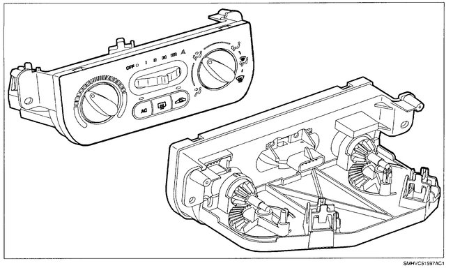

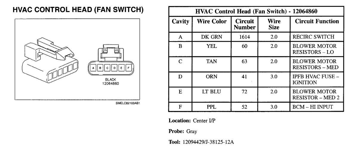

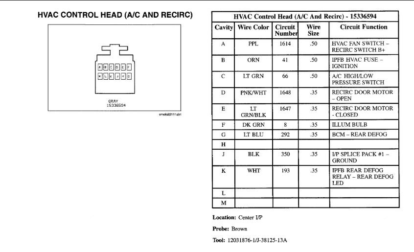

  • 110,194 POSTS
Welcome back:
I have attached three pics that I hope help. The first is the switch assembly and the next two are what each wire is used for which goes to the power switch, AC, mode control and so on. Picture 2 deals specifically with the AC.
Here are a few links you may find helpful:
Let me know if it helps.
Jul 9, 2019 at 7:28 PM

Will A/C system have power if control panel is messed up?
Jul 10, 2019 at 2:20 AM
  • 110,194 POSTS
In most cases, no. However, the compressor isn't working correct?
Jul 10, 2019 at 7:53 PM
RODNEY7867
  • 70 POSTS
I replaced the control panel and everything works. cold A/C, hot heat. thanks for the help.
