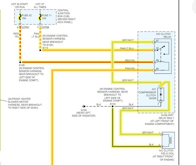

I have front A/C only. I just replaced the compressor because the compressor stopped work completely. I installed the new compressor and now the clutch will not engage. I have looked over and checked all connections to the system itself, all the plugs are clean and plugged in.
May 21, 2019 at 1:46 AM
Good afternoon,
Did you charge the system with freon? How much?
Can you tell me the pressures? It needs 20 lbs of pressure to close the relay for the compressor.

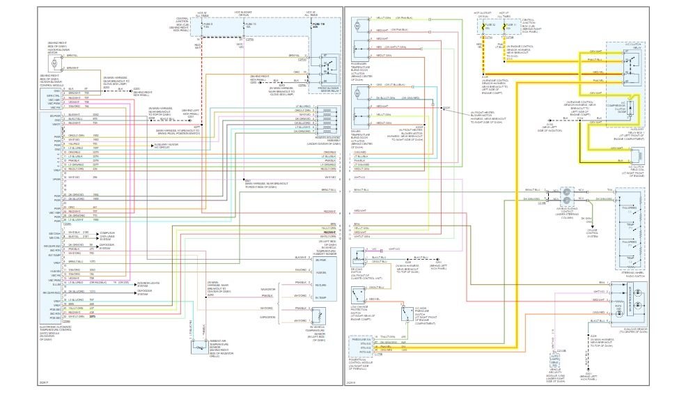

I attached a wiring diagram for the clutch.
