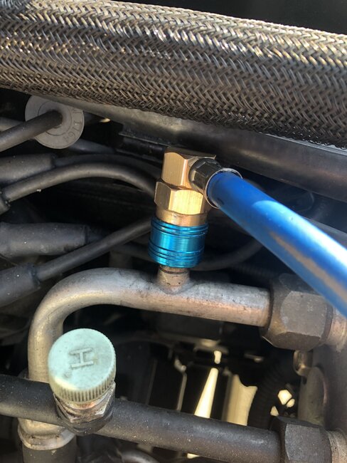

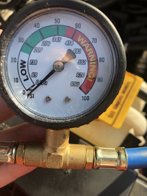

Howdy, thank you for the reply. My vehicle also has an overheating problem at the moment. I've changed the broken electrical fan, but it didn't fix the problem as well as changing the thermostat and the temp sensor near the thermostat on the engine block. My next guess is a clogged or calcium built up radiator as it's hot but it's not in the red on the overheating scale. This overheating only really happens when you push the engine or when it's really hot out. Back to the A/C Problem. I've checked the A/C Pressure with the engine off and the pressure is reading as low as it goes. I'm assuming this means a leak, correct? I've attached a video and two photos, one of the connection, one of the pressure, and one video of how the ac can be jerry rigged to work.

Yep, you jumped the relay. Since there is no pressure in the system, the relay won't actuate because the low-pressure switch is telling it not to.
Have you tried recharging it?

If you recharge it, the system should turn on when the minimum pressure is reached. The only thing is, if there is a leak, we didn't fix it.
Take a look at this link:
https://www.2carpros.com/articles/air-conditioner-leak-detection
Also, if you have an A/C manifold set with a vacuum pump, you can see if the system holds a vacuum before you add Freon. It could save you money.
Here is a link that explains how to vacuum and recharge a system:
