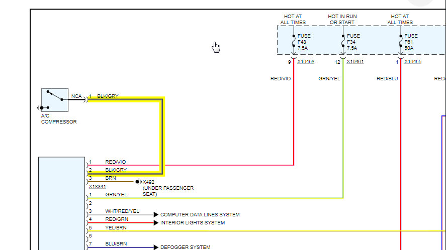

The A/C stopped working. i found that the clutch was not engaging. When i applied power to the wire coming out of the compressor, then it worked perfect. I need to know what to check next. Thanks

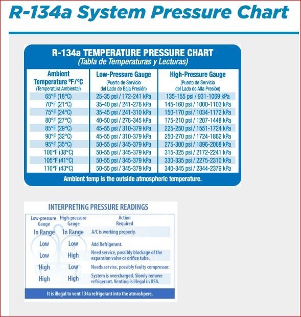

Then you have a compressor issue. You should have about 30-40 PSI on the low side when the A/C is on and about 2.5 times ambient temperature on the high side. When they are equal, it means the compressor is not operating properly. Take a look at the attachments.
The fact that it does not work except when you apply power shows this is the issue. I would check the black and grey wire going to the compressor for an issue. If the wire is okay, then your A/C control module is most likely the issue as long as the fuses to the module are okay ( I assume they are because they are not exclusive to the compressor). Fuse F48 and F34 need to be checked.
Let me know what you find and we can go from there.

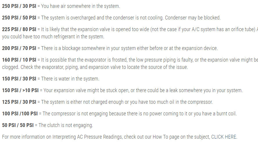

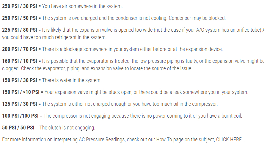

This is hard to understand but it sounds like the A/ compressor needs to be replaced, but to be sure this A/C guide can help us find the problem:
Please go over this guide and get back to us.
