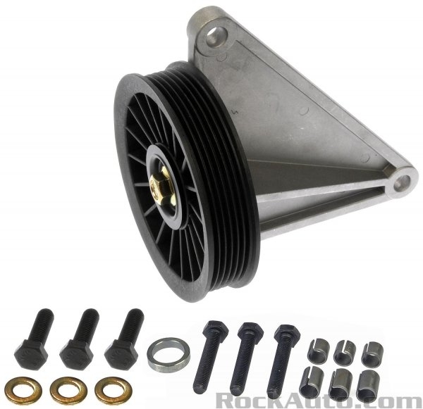

So i want to shortcut the belt and not include the A/C.
how do i find out what size belt i need?
YouTube says same size belt.
But the distance of the shortcut seems shorter.
secondly, if i short the A/C pulley do i need to pull the A/C pulley and unit to have clearance on the new belt or can i just put on new belt and run as is? Excited to hear from you pros.

They use a different belt on the non-AC Astro's but GM replaced the AC compressor with a bypass pulley and a different idler to make it work correctly. First image is belt routing without AC, second is with AC. The bypass pulley is in the third picture.

i saw that diagram on the engine cooling that is when i decided to ask about the shortcut. do you know if i have to remove the A/C pulley and unit to allow the shortcut?
i am told to determine the belt size i should use a string. Is that true?

The bypass pulley is installed in place of the AC compressor. The upper idler is moved to a different bolt hole and you just buy the belt for the Astro without AC.

This site and these guys that answer..
ROCK..
you gave me expert advice that i was able to convey to my mechanic..
to fix and reinstall the ac was over $1400.00
With the shortcut
all in with short belt and a bypass pulley
$160.00
