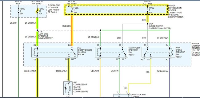

So recently I did a timing belt job on my car listed above and I discharged the A/C system and when I was ready to put refrigerant back in it the A/C clutch wasn’t kicking on. so I ended up jumping the relay and it turned on and now the system is fully charged. But my A/C clutch still isn’t turning on by itself. I swapped the relay and still nothing. I checked the fuses and it’s all good. I also replaced the low pressure switch on it and I’m still getting nothing. any advice on what I should do next? It seems that the only way the A/C clutch turns on is when I jump the relay.
May 8, 2020 at 3:18 AM
Good afternoon,
I attached a wiring diagram for the A/C compressor.
Can you remove the relay and with the key on? you should have 2 powers in the connector.
Can you verify this?
Can you check for power as well at the high and low pressure switches?

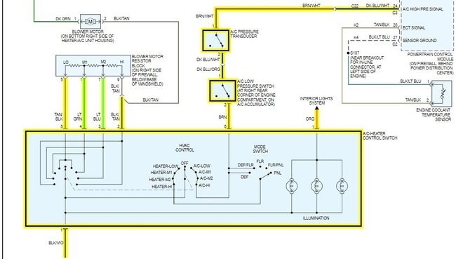

Okay, so with the key on at the relay I do have two power connectors, but as for the high and low pressure switches I have nothing, but when I turn the car on and A/C on I do get a ground at both switches but no power.
May 8, 2020 at 11:00 AM
The power for the switches comes from the control head. If there is no power, go to the control head and see if the wire, brown, has power when the A/C is commanded on.
If it does, you have a wiring issue, if it does not, then the control head is bad.
Without the signals from the 2 pressure switches, the PCM will not ground the control side of the A/C relay for the compressor to come on.

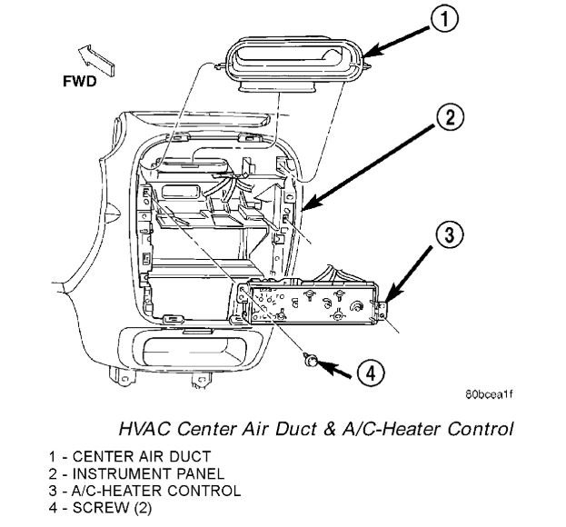

The control head would be inside the car right the instrument panel that controls all the A/C stuff by the radio? If so then yea the brown wire isn’t getting no power so that would mean the control head is bad then?
May 9, 2020 at 1:54 AM
That is correct. That is where the power comes from.
I attached a picture of the control for you.

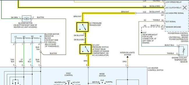

Hey, so I know it’s been a while but I finally had a chance to replace the control head with a brand new one but still the A/C clutch doesn’t engage. I also back probed it to check for power at the brown wire and I still have nothing.
May 19, 2020 at 11:36 AM
Okay, when you checked the brown wire, was the engine running and the A/C commanded on?
May 19, 2020 at 11:17 PM
TONY02
  • 86 POSTS
Yes, I put the A/C on high.
May 20, 2020 at 3:56 AM
If you disconnect the connector with the key on, does the brown wire have any power?
May 20, 2020 at 4:03 AM
TONY02
  • 86 POSTS
No the brown wire doesn’t have any power.

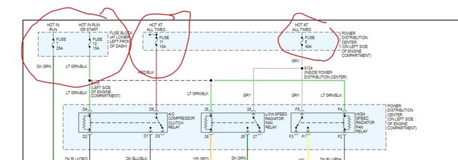

I attached a wiring diagram for you.
check the voltage on both sides of the fuse with the key in the on position.
May 20, 2020 at 4:33 AM
TONY02
  • 86 POSTS
Okay, so I checked the fuses you said to check and they are good. I used a test light connected to battery ground and it lit up on both sides for all of them.
May 20, 2020 at 10:36 AM
Okay, it is pointing right back to the control head again.
