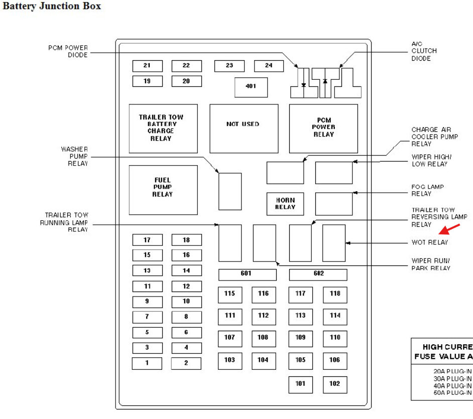

This truck has had this problem for over a decade. The AC works great, but after it runs for about an hour, the engine temp shows normal then jumps to hot and the engine goes into limp mode. The code given is engine temp sensor. It has been replaced several times, but the condition continues. When the ac is not used, the truck never has the problem.

Okay, so the PCM controls the output to the temp gauge. Lets remove the WOT relay to see if it makes a difference. Here is the location. Please let us know what happens.

I will try that. Does it make a difference if it’s never happened during wot?
Aug 11, 2025 at 7:28 AM
  • 55,433 POSTS
No, if this relay is shorted it will back feed into the PCM causing the issue you are having.
Aug 12, 2025 at 1:26 AM
CRAIG M
  • 16 POSTS
I ran the ac for awhile then pulled out the wot relay. The compressor quit working and when I pulled the relay out it was very hot.

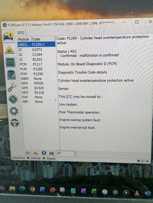

I replaced the pcm and granddaughter has been driving it for a couple of months. It finally did the same thing again. Truck went into limp mode and check engine light came on, water gauge pegged instantly and oil light came on.
Jul 31, 2026 at 2:54 PM
CRAIG M
  • 16 POSTS
Dtc codes
Jul 31, 2026 at 4:07 PM
  • 55,433 POSTS
I had a thought that the pig tail connector at the cylinder head temperature sensor is bad. I would replace it. Here is a link to it.
