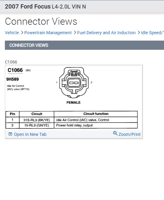

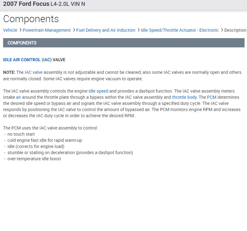

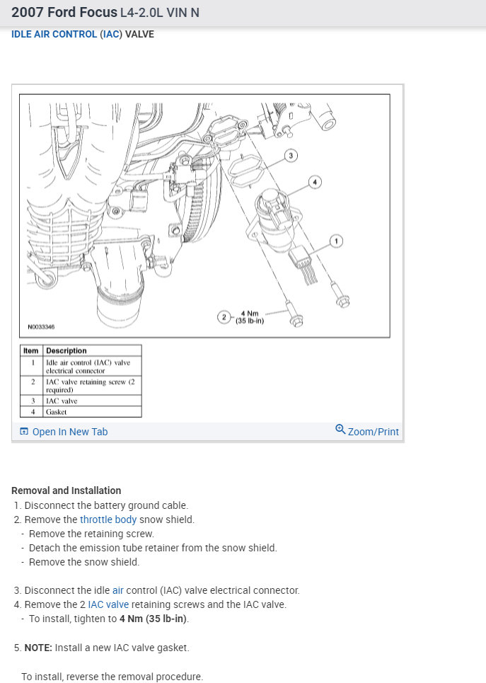

One of the parts that controls the idle speed under load is the idle air control valve. The job of this valve is the adjust the engine idle as it has any type of load from an accessory like the A/C. When the A/C gets turned on the valve allows more air flow to counter the load. A dirty valve might not perform as well. So, it might be a good idea to clean it.
Here are a couple of helpful articles:
https://www.2carpros.com/articles/how-a-idle-air-control-valve-works
https://www.2carpros.com/articles/idle-air-control-valve-service
