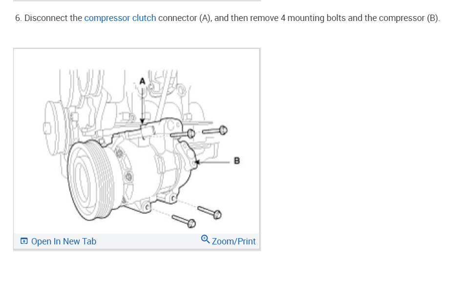

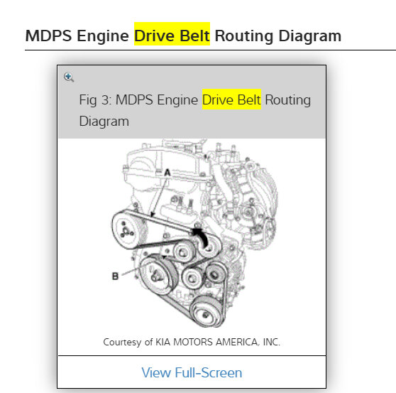

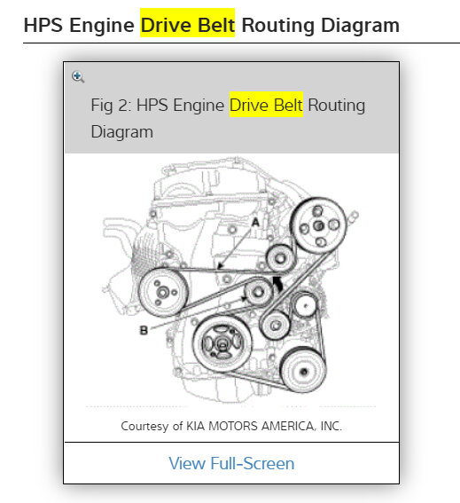

Can you take the A/C compressor out of this car and get a smaller Serpentine belt and the car still runs?
Oct 22, 2022 at 6:15 AM
  • 55,433 POSTS

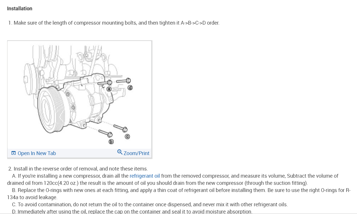

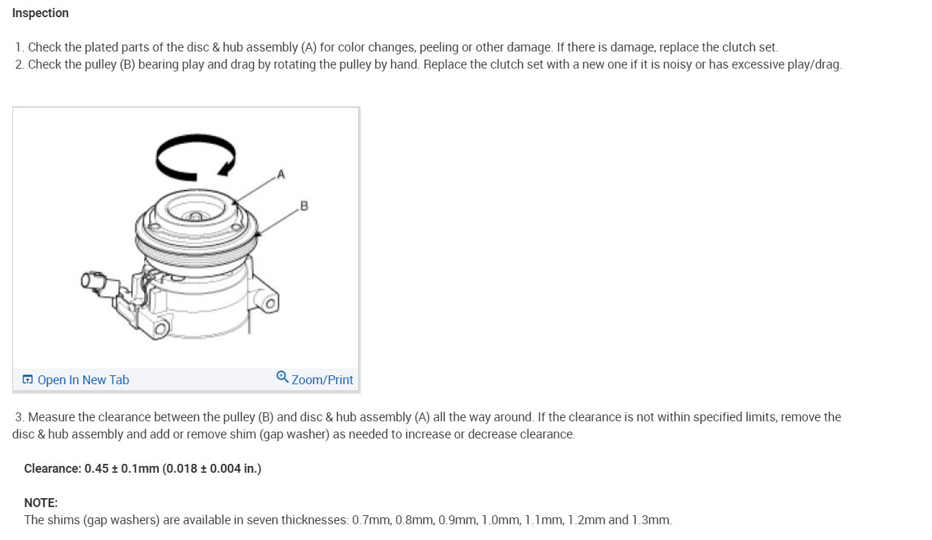

You can only put a shorter belt on there is it does not hit anything which it looks like it might. I have included a guide on how to change out the compressor which you can get on Amazon for about $140.00 with instructions on how to change it out on your car in the images below.
https://www.2carpros.com/articles/replace-air-conditioner-compressor
