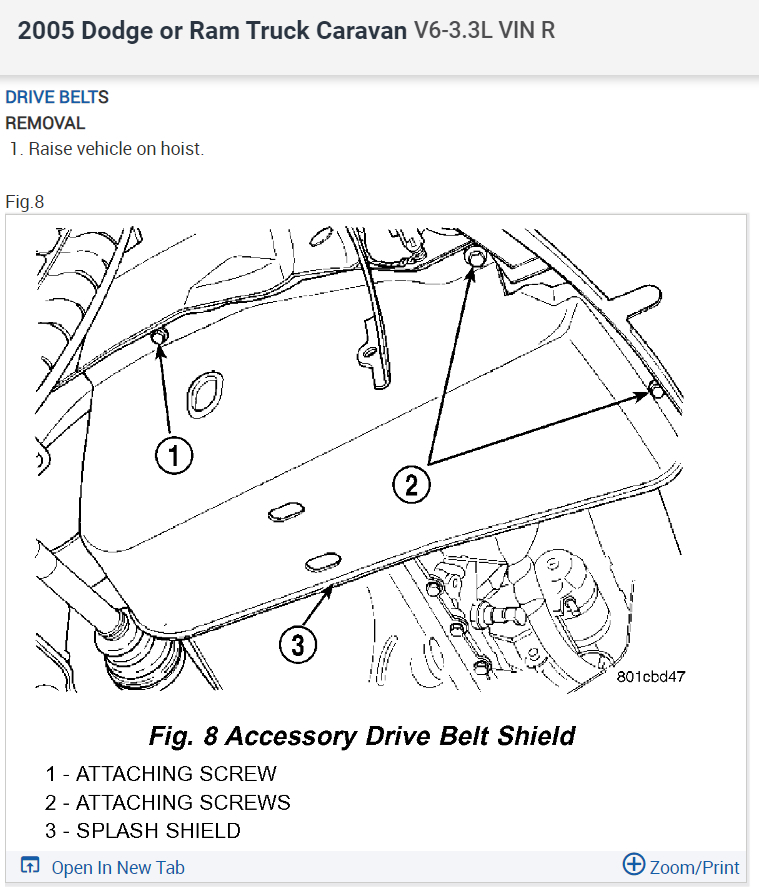

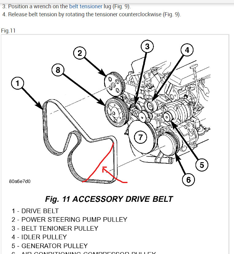

So, my serpentine belt fell off and I'm pretty sure it's my A/C pulley. Do I have to remove the pulley to bypass it? Also does anyone have any diagrams and instructions for that?

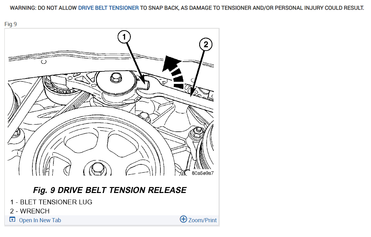

Yep, here is how to remove the belt so you can get one for your van that does not have air conditioning. Check out the images (below). Let us know if you need anything else.
