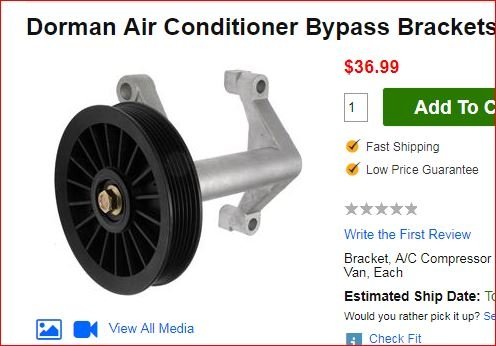

However, an alternative to changing the belt size is to use an AC compressor bypass pulley. They are not much money and you just have to put this in place of a locked up compressor. This way you don't have to worry about getting a different belt and routing it any different.
Just another option for any others with this issue.
