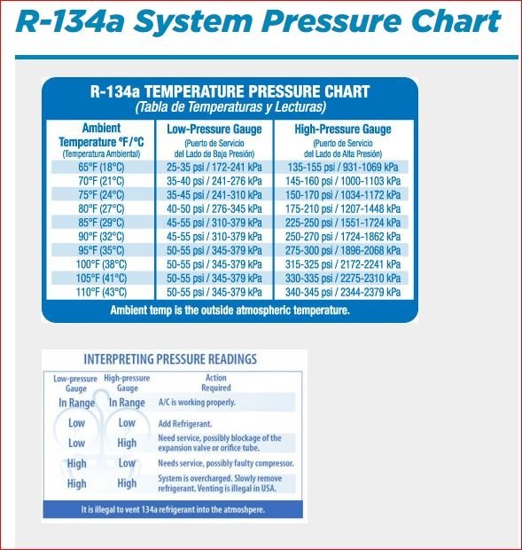

Let's start with putting the gauges back on the system and then telling us what the pressure is when the A/C is off, then what the pressure is when the system is on.
The system should be cycling and the pressures should be responding so let us know what they go to when it clicks off.
Here are a couple guides that will help with this process:
If the compressor does not cycle then you may be freezing the evaporator so we need to keep monitoring the pressure when the A/C starts blowing warm.
So when it starts blowing warm, let us know what the pressure is and then check the A/C lines going into the firewall for frost and check the temperature of them to find out if they are still cold.
Below is a chart that will help with pressures based on ambient temperature and possible issues.
Please let us know what you find with this. Thanks

when my A/C was working properly of course the gauges read in the window of a working system however once it got warm,wich the length of time until warm varies from 15 minutes to an hour or so but when it does here's the readings,at 80 degrees the low pressure was 95,and the high was 110,the tubes going into firewall were actually warm not cool or frozen.going by the chart looks like a compressor is what i need correct?i priced them and they are cheaper than i thought.if that's what is needed then I will have to get one.i have a lung condition and can't breathe in hot conditions.so what's your take on it?
Jul 7, 2021 at 1:57 PM

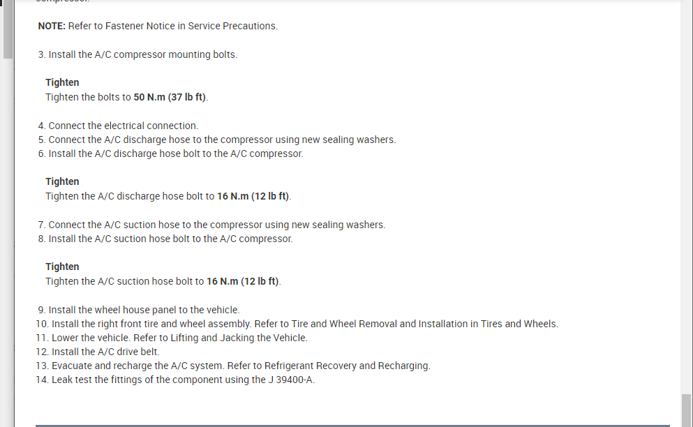

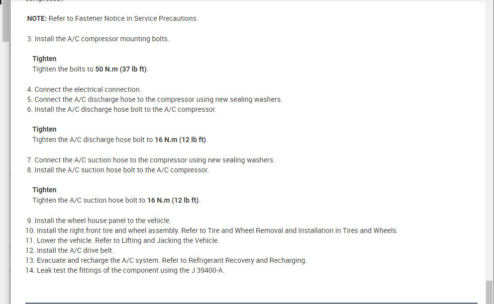

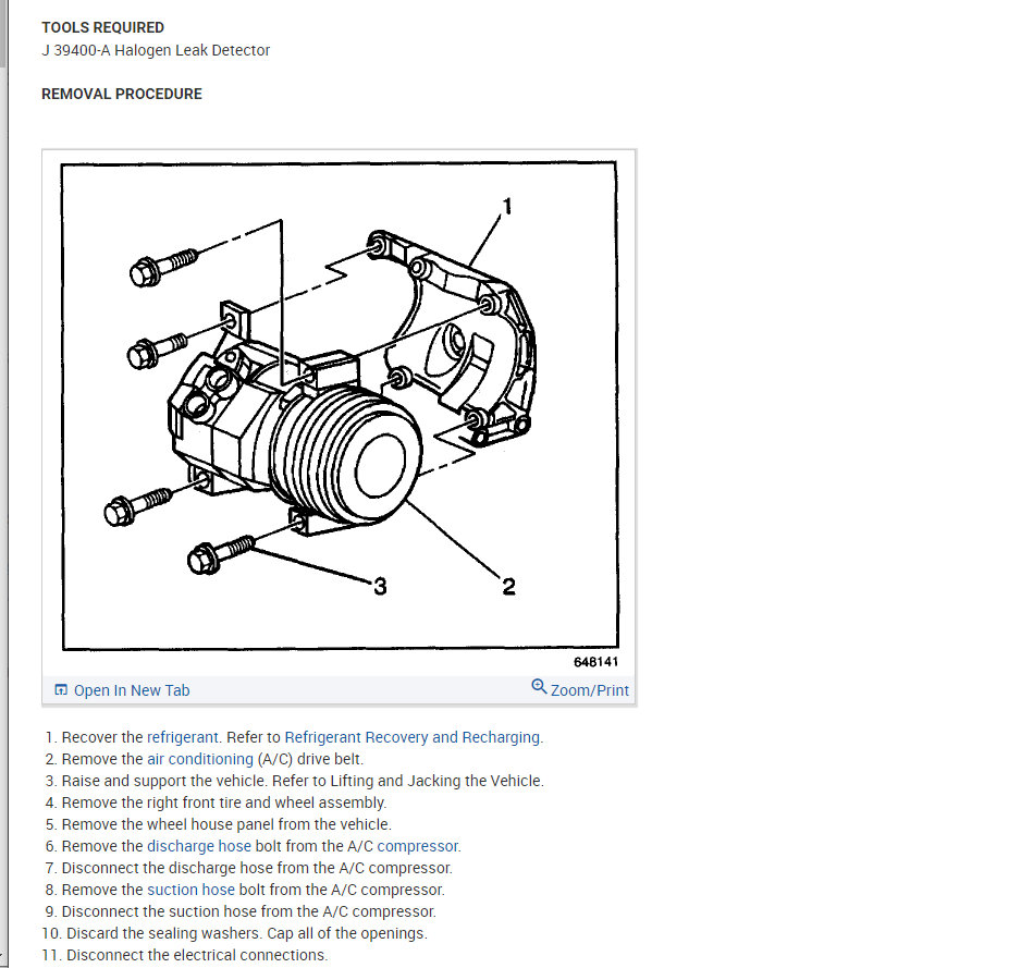

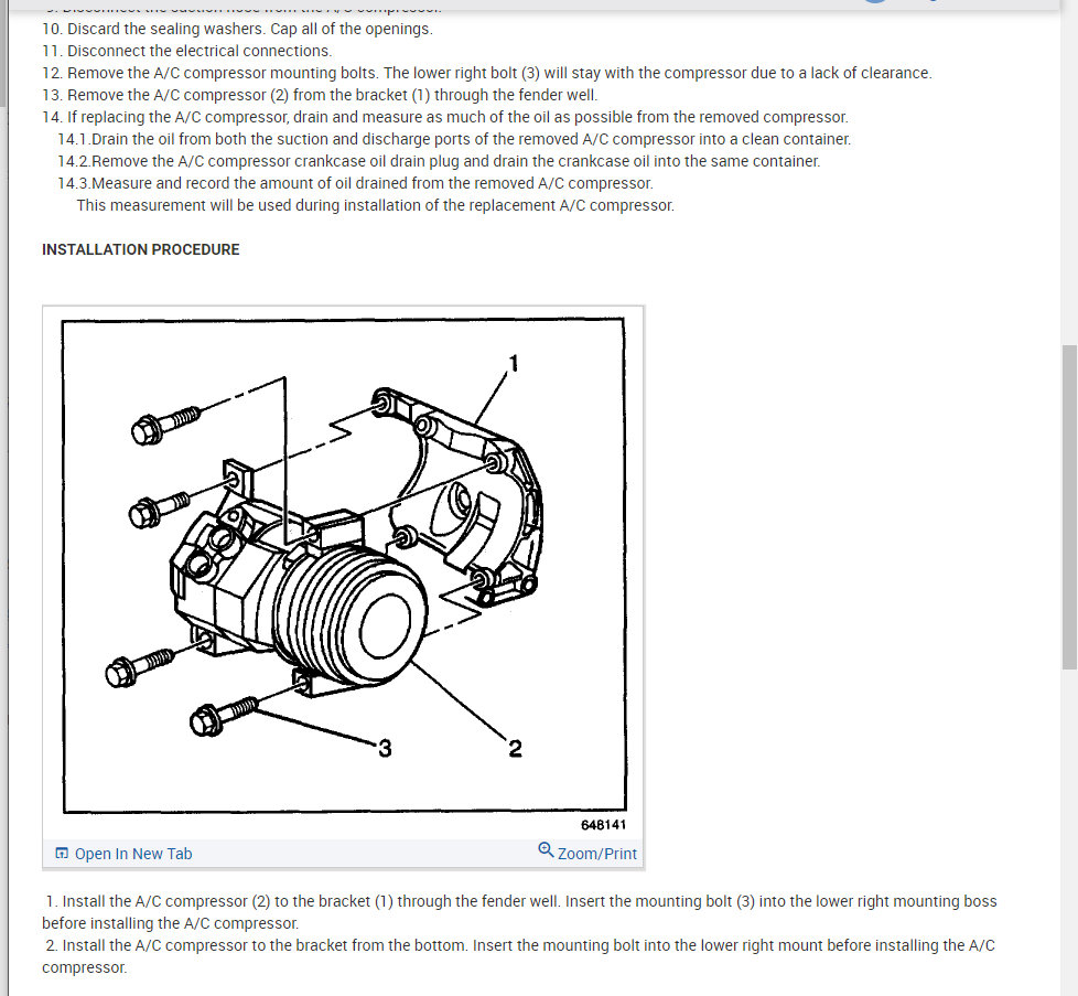

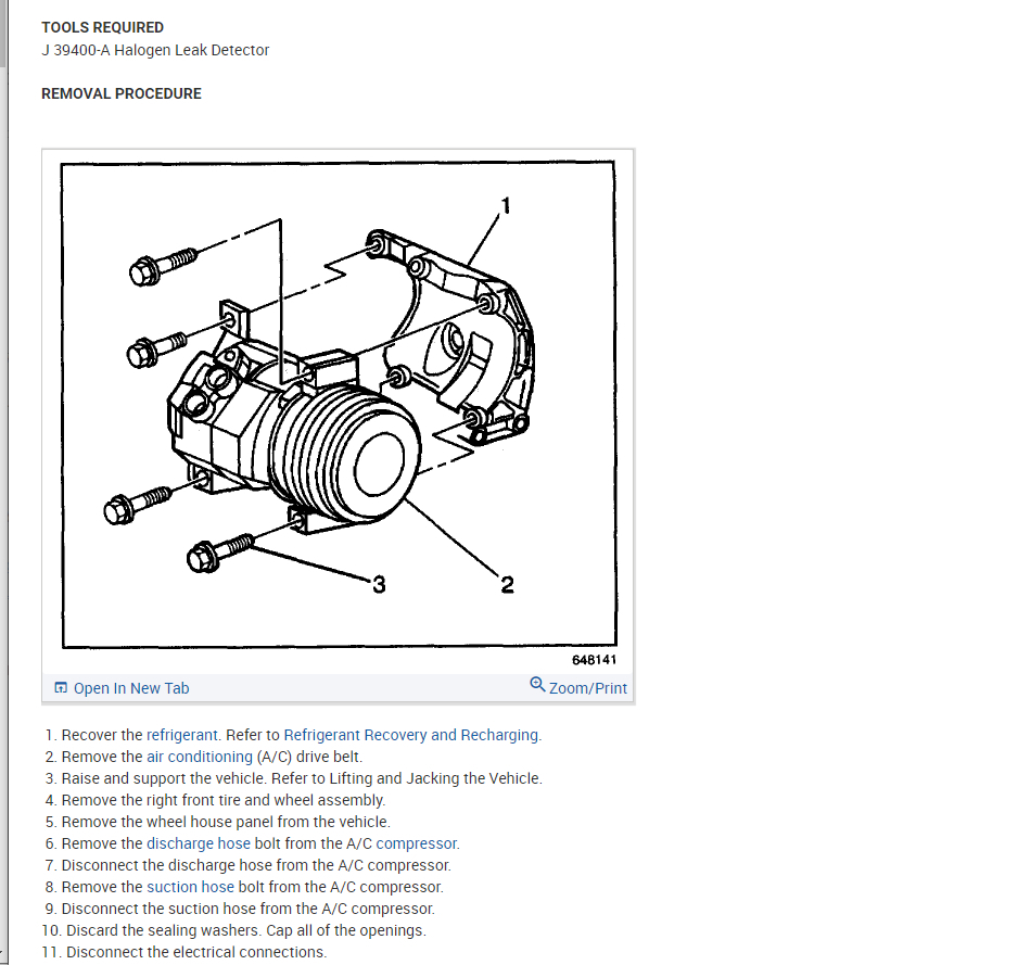

This is signs of a compressor issue. Basically it is not able to build pressure. The only other thing would be a weak charged system so what was the pressure with the system static or the compressor, engine off?
https://www.2carpros.com/articles/replace-air-conditioner-compressor
Below is the info from the manual on how to replace the compressor.
Let us know and we can go from there. Thanks
