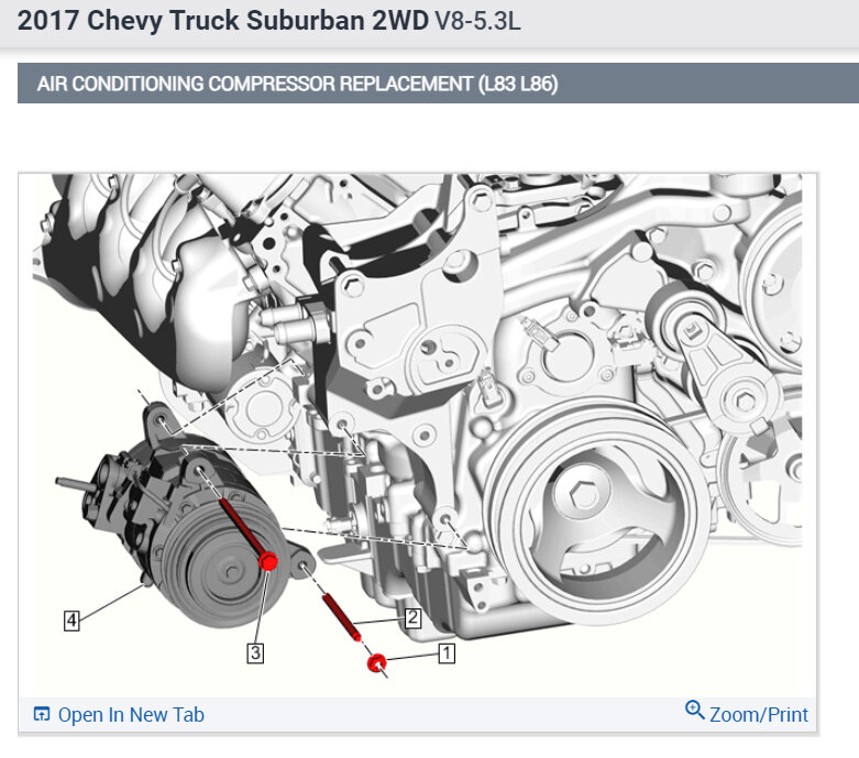

Yep, we need to know the high side pressure because you may have a compressor going out, this video will help show you how:
https://youtu.be/4EqdrBVb0sY

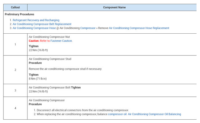

If the pressures are low on the high side and high on the low side the compressor is failing. If the pressures are good, can I ask if the AC performance on the front A/C system is the same for both sides, passenger and drivers' side? The reason I ask is I need to know if it is a blend door actuator problem. If the pressures are bad here is a generic guide to help you step by step with instructions in the diagrams below to show you how on your car:
https://www.2carpros.com/articles/replace-air-conditioner-compressor
and this guide may help as well:
You have either 134a or 1234yf refrigerant, do you know which kind your vehicle has? Check out the images (below). Let us know what happens and please upload pictures or videos of the problem so we can see what's going on.

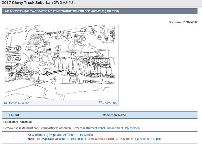

Okay, can you turn the A/C system on full cold and then grasp the larger outgoing/low side tube coming out of the firewall to the compressor to see if it is cold? Also did you get those gauges to see what the pressure was? You may have an evaporator temperature sensor that is off, and it is telling the HVAC controller to adjust the temperature blend doors to warmer. We might want to do a CAN scan to see what comes up. You can get a CAN scanner (Controller Area Network) which will work on most cars from Amazon.
here is a video to show you how:
https://youtu.be/u-4syLc-ifQ
Check out the images (below). Please let us know how it goes.
