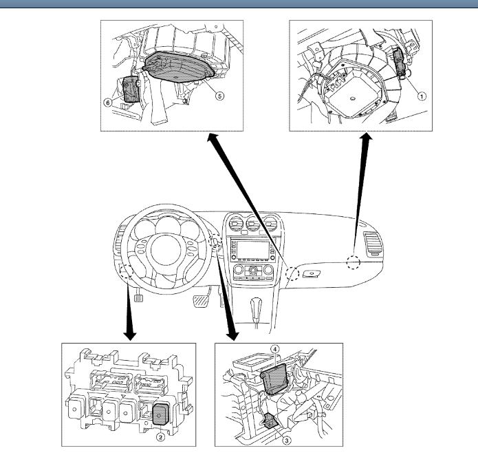

A/C blows warm on driver side cold on passenger side.
Sep 7, 2022 at 4:54 AM
  • 55,817 POSTS
This is usually a problem with the left side blend door actuator (air door), here is the location so you can change it out. Check out the diagrams (below). Please let us know if you need anything else to get the problem fixed.
