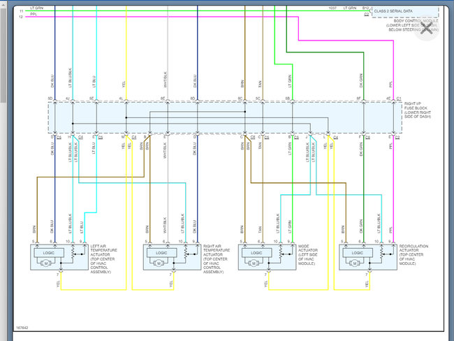

This could be a blend door issue but we should start with what you are seeing so that we can be sure to be on the same page.
Can you get a picture or quick video of the HVAC so that we can make sure that I understand what you are seeing?

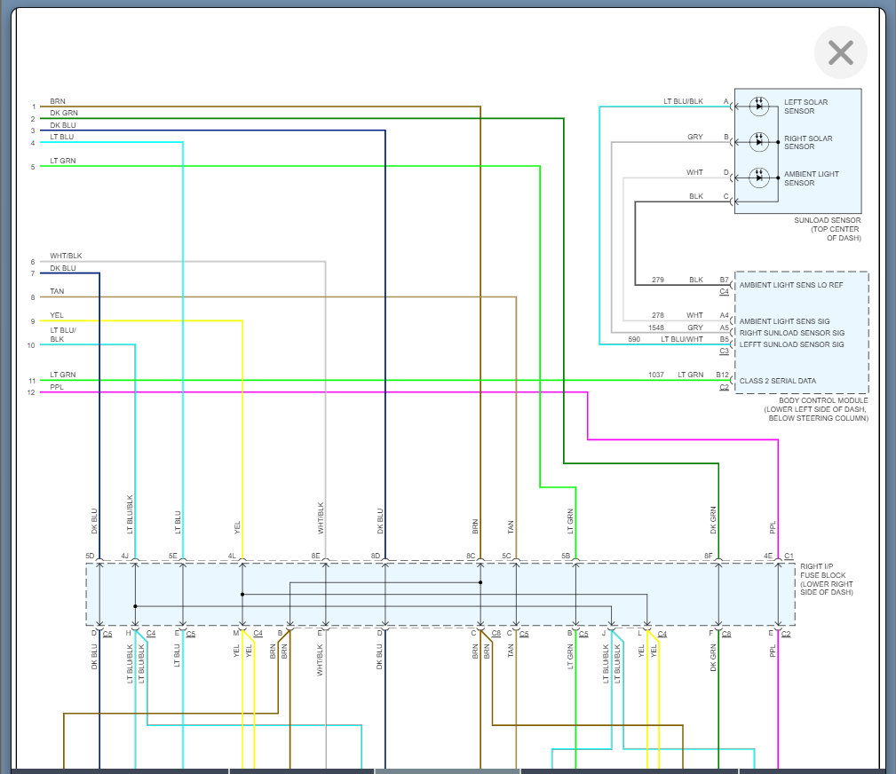

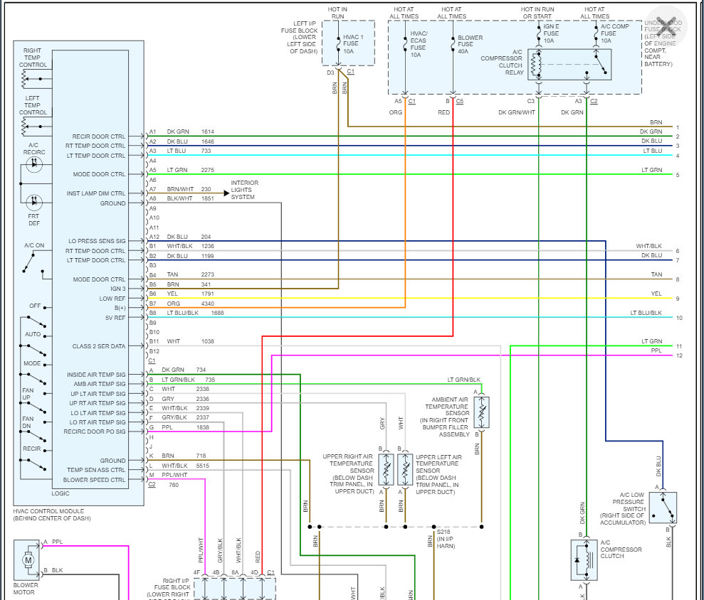

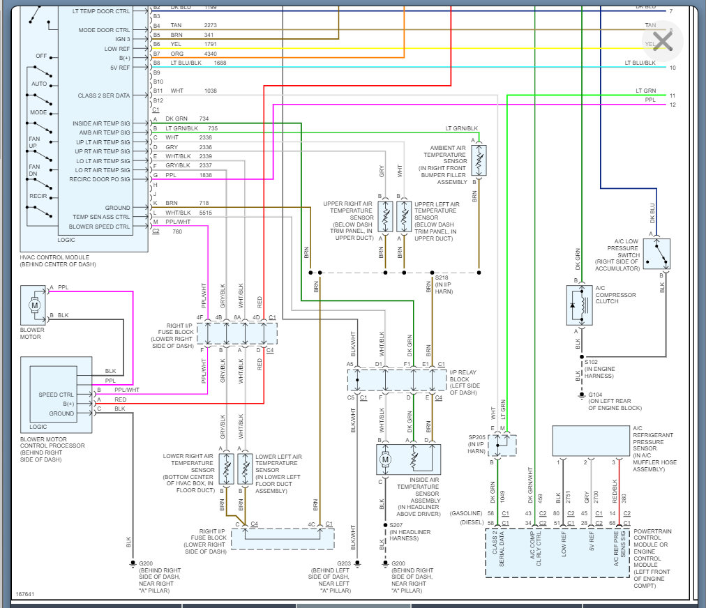

However, the best thing to do is check for power at the module to make sure you are getting proper voltage on all the circuits that are coming from fuses and the illumination circuit?
Then monitor the voltage on the temp door circuits and change the temp. The voltage should be moving. If it is then the blend door is the issue.
However, we need to make sure about this because the module may be the issue and not the actuator.
I attached the wiring diagrams below which will help with this.
Let's start with this and go from there.

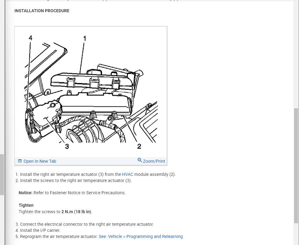

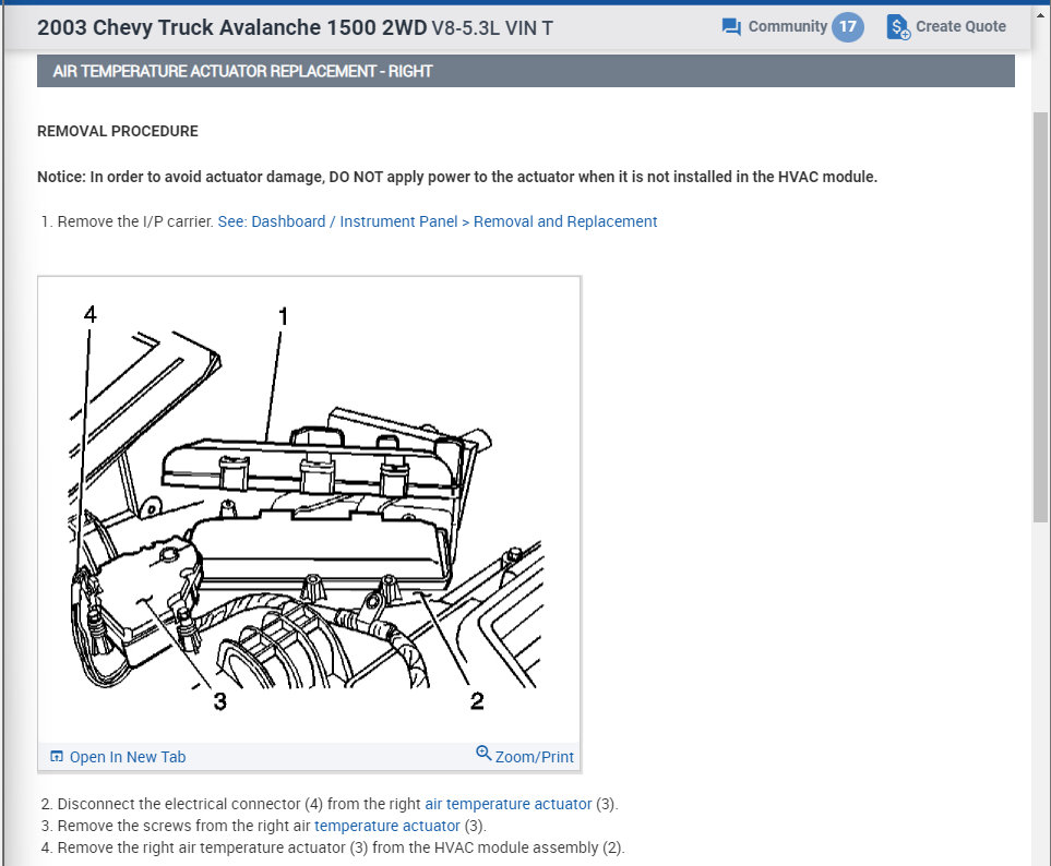

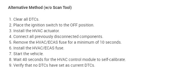

Do you have dual zone temp control? I think that is the only option on this vehicle so if that is the case then I suspect the controller is the issue. It is highly unlikely that there is an issue with both blend door actuators.
However, I would suggest just accessing the actuator and change the temp and see if you can feel it moving.
See the attached info from the manual on the passenger side actuator as I think that is easier to access.
If it is not moving then the module is most likely the issue which would make sense based on what you are seeing with the lack of illumination.

Correct. That is exactly what I am suggesting. Since you have dual zone temperature it is highly unlikely that the actual actuator is the issue. The way to confirm this is to check the voltage coming from the module on the temperature doors to find out if they are changing which will confirm this.
May 18, 2022 at 9:27 AM
ERVIKINGO

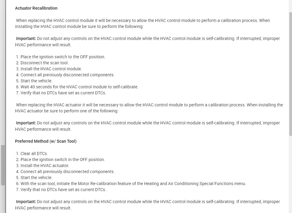

There is power.... I'm buying a refurbished controller. Will post results. Hoping for a solution.
May 19, 2022 at 2:37 AM
Perfect. I think you will get this repaired with that. In other words, based on all this I would be shocked that this does not solve the module issue. Which means I suspect that will fix the blend door issue as well. However, if the module stays powered on and operates and the blend door issue is not resolved as well then, we will need to address that. This must be fixed first and then address that after.
