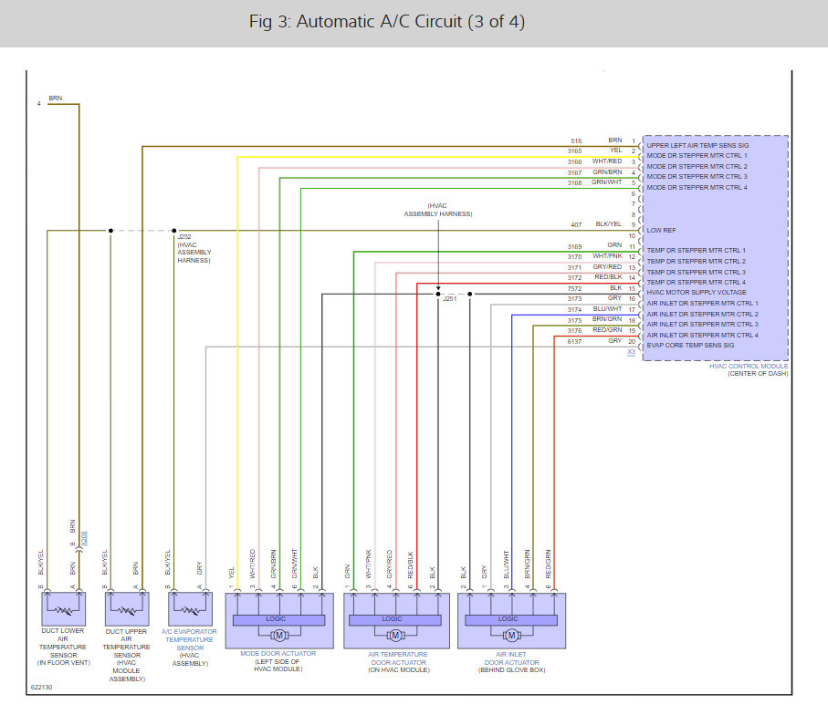

The A/C compressor refuses to start, while my fan continues to run
2018 CHEVROLET COLORADO
112,000 MILES • V6 • 2WD • AUTOMATIC
MBOZE17
This causes my ac to blow hot air. I have replaced fuses, replaced ac pressure switch, and Freon levels are good. The funny thing is I can restart my battery and the A/C will work perfect for about 12-24 hours. Can you help me with diagnosing this issue?
Jun 26, 2022 at 1:12 AM
  • 55,433 POSTS

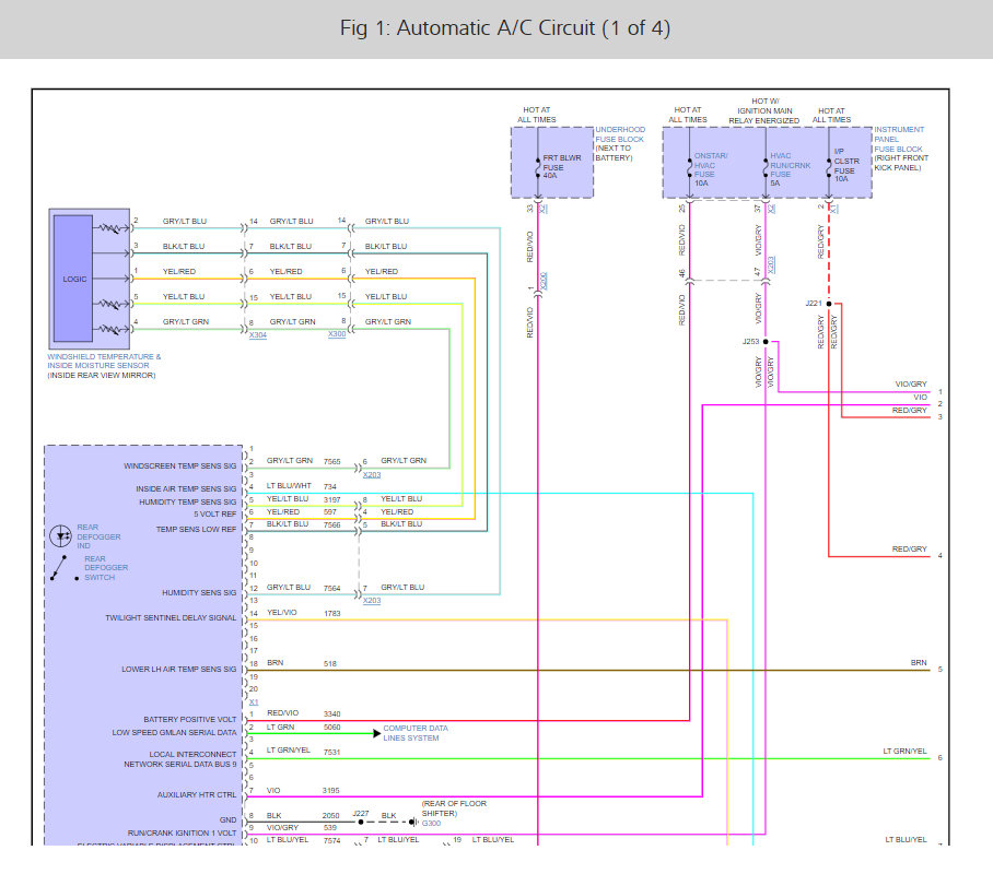

It sounds like the HAC control module is no good. To be sure we can do a CAN scan which is in this guide and video. I have included how to change the HVAC module out and the A/C wiring diagrams so you can see how the system works.
Jun 27, 2022 at 2:31 AM
