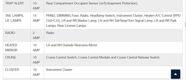

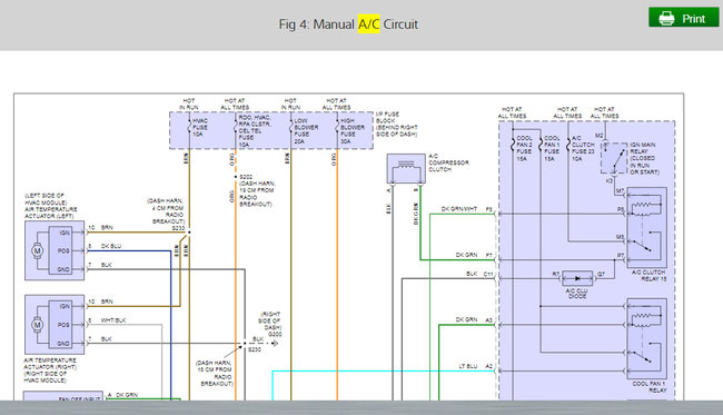

My AC will not turn on. It came on blowing cold for a mintue then went back to hot. The button you push to turn AC on and off doesn't light up the rear defrost does not either. I don't know what to look for.
May 8, 2019 at 3:18 PM
SCGRANTURISMO
  • 4,897 POSTS

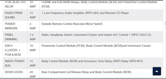

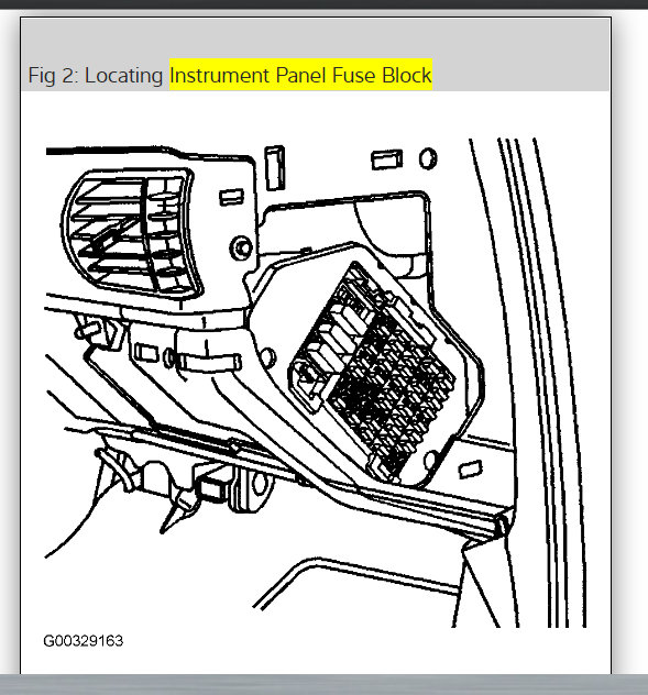

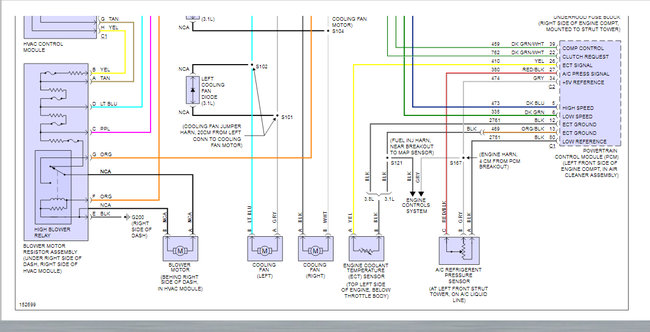

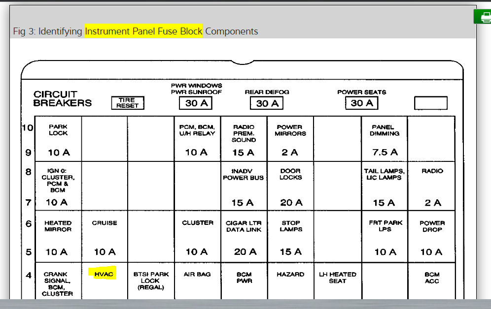

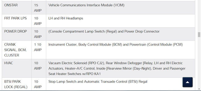

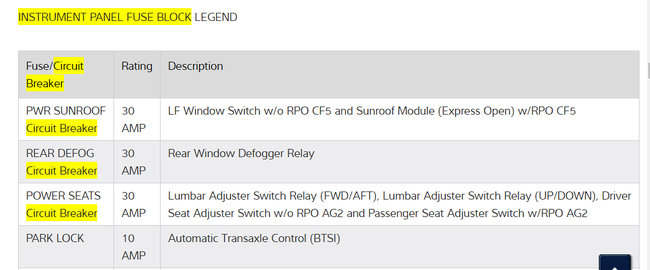

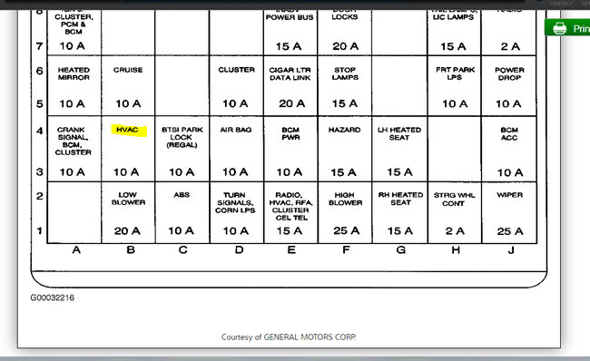

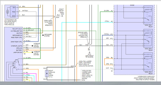

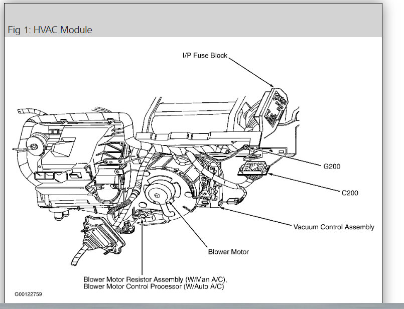

This could be a problem with your vehicle's Heating Ventilation and Air Conditioning (HVAC) fuse. It is a 10A fuse located in the instrument panel fuse block on the right hand side of the instrument panel. I have included in the diagrams down below a wiring diagram of your vehicle's A/C circuits, and the location and fuse diagram for the instrument panel fuse block. I have also included a link for you to go to below:
Please go through these guides and get back to us with what you are able to find out.
