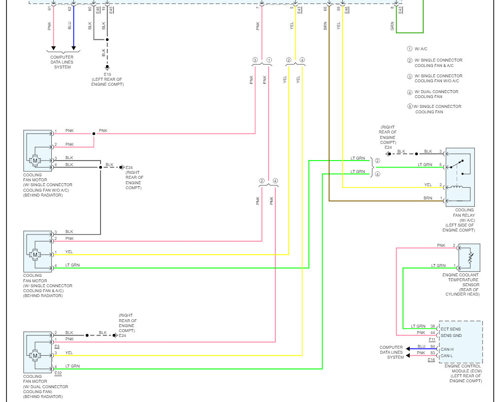

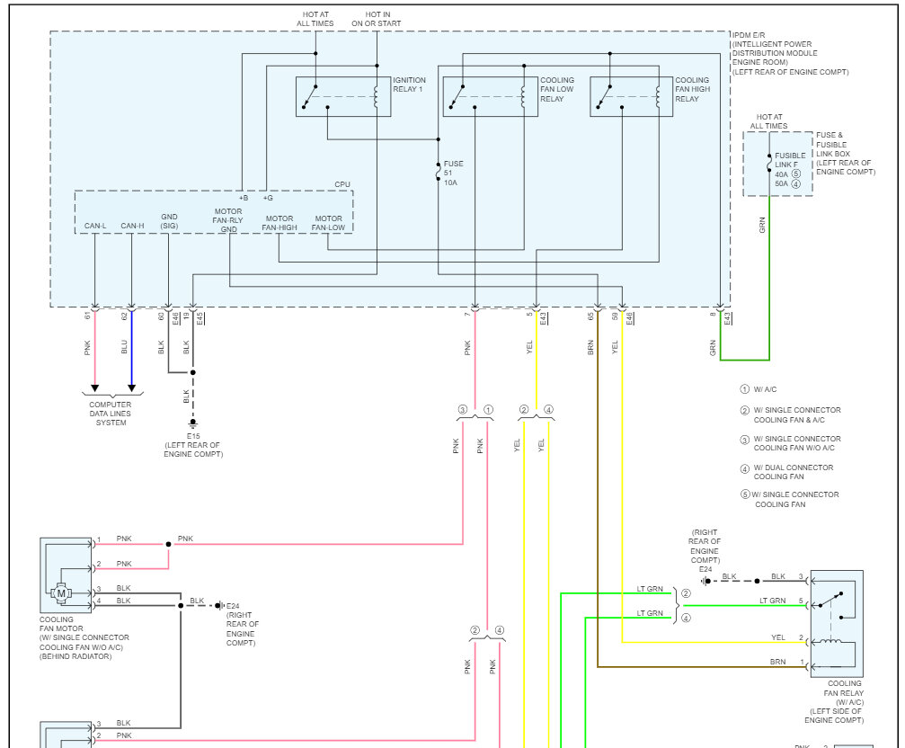

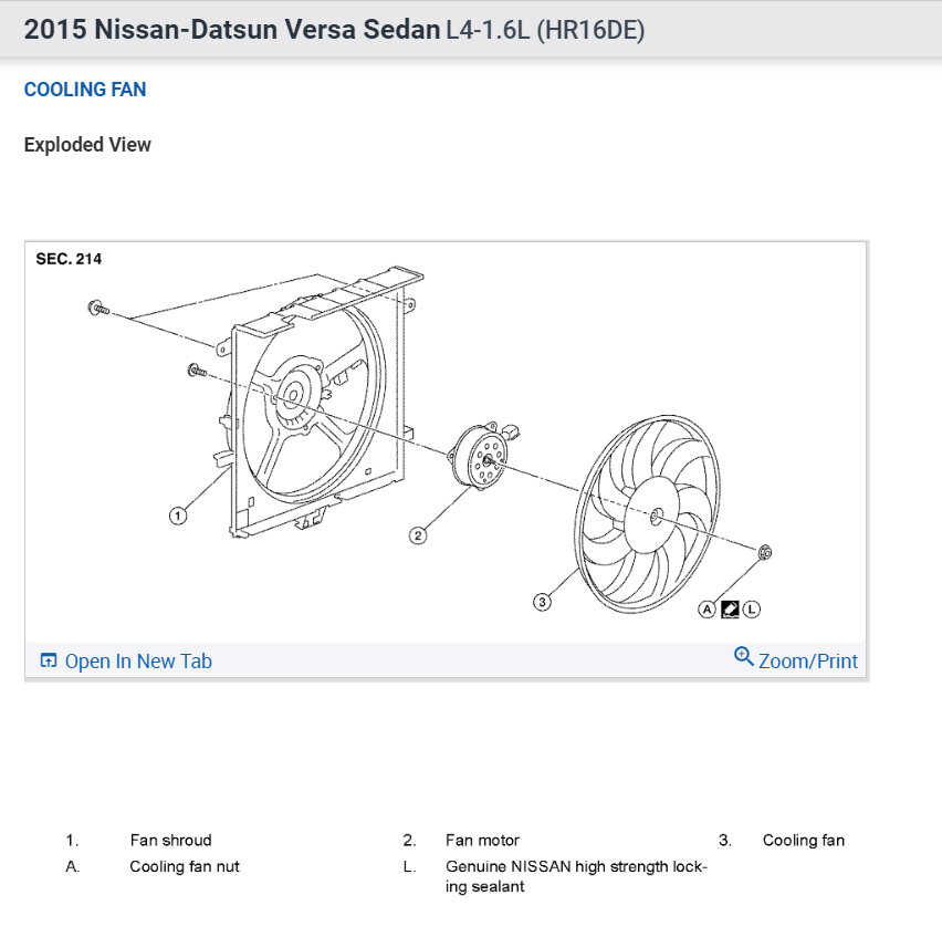

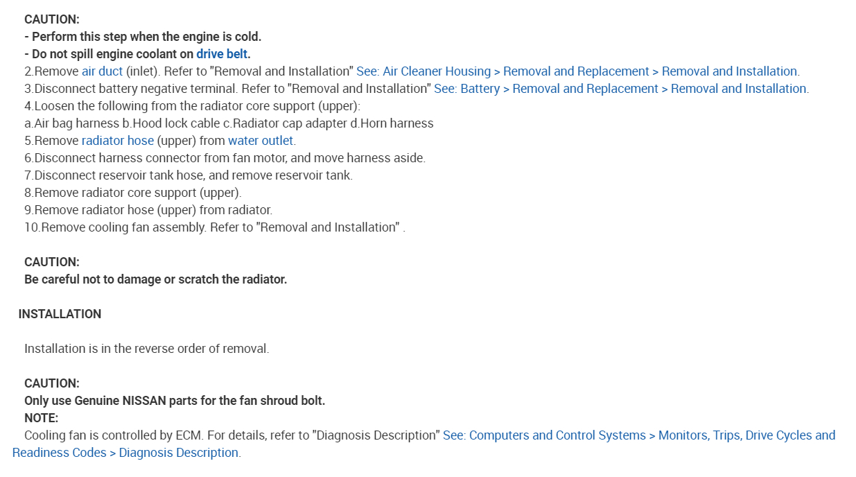

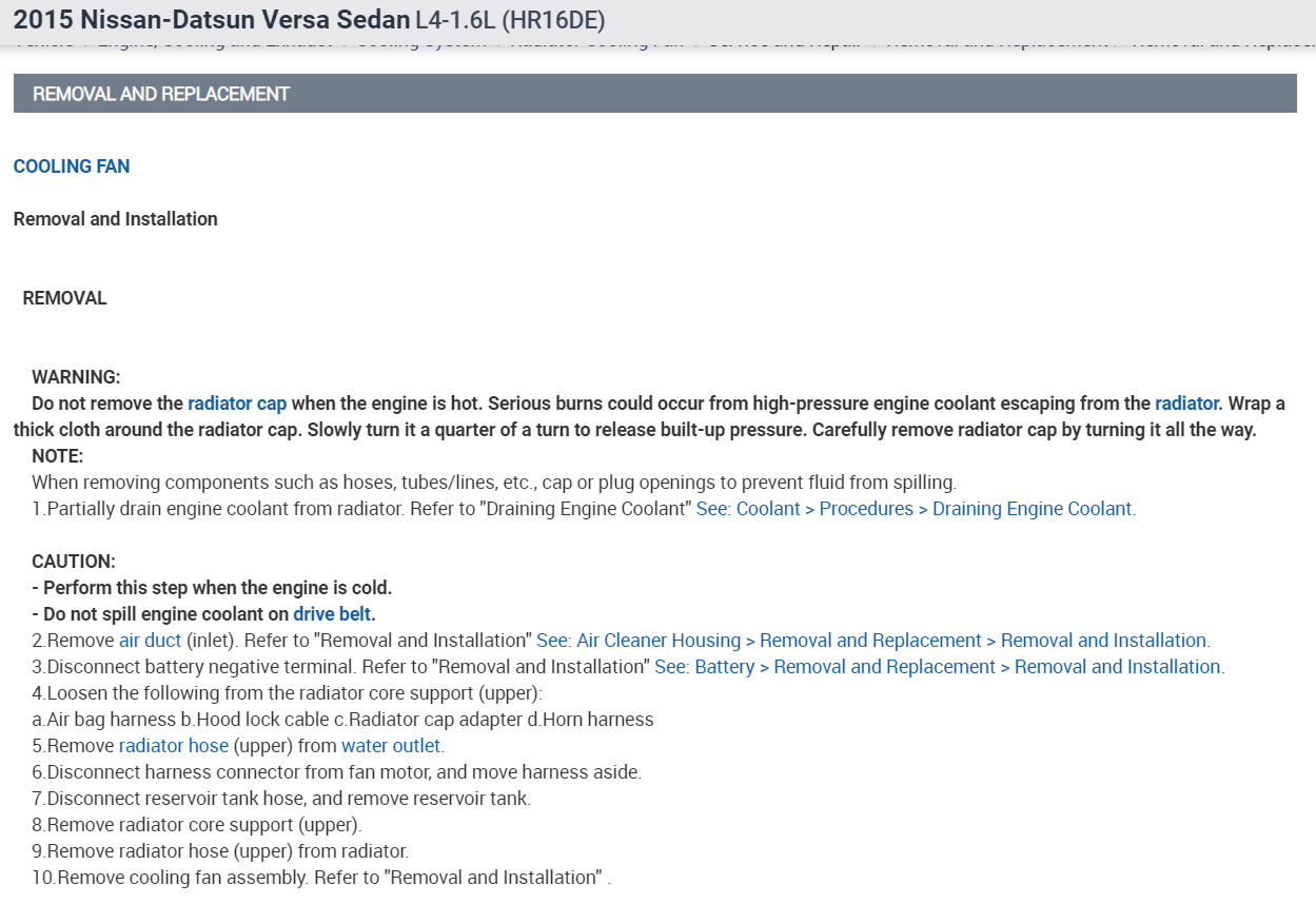

Can I ask when you turn the A/C on can you hear the radiator fan turn on? If not, this is your problem which causes the engine to run hot, which can cause the rough idle. Most of the time the fan motor will be bad and needs to be replaced. here are two guides to help us and I have included how to change the fan motor out as well in the images below.
