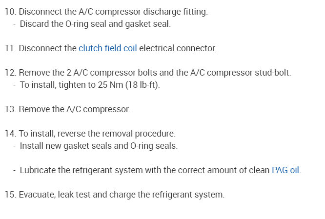

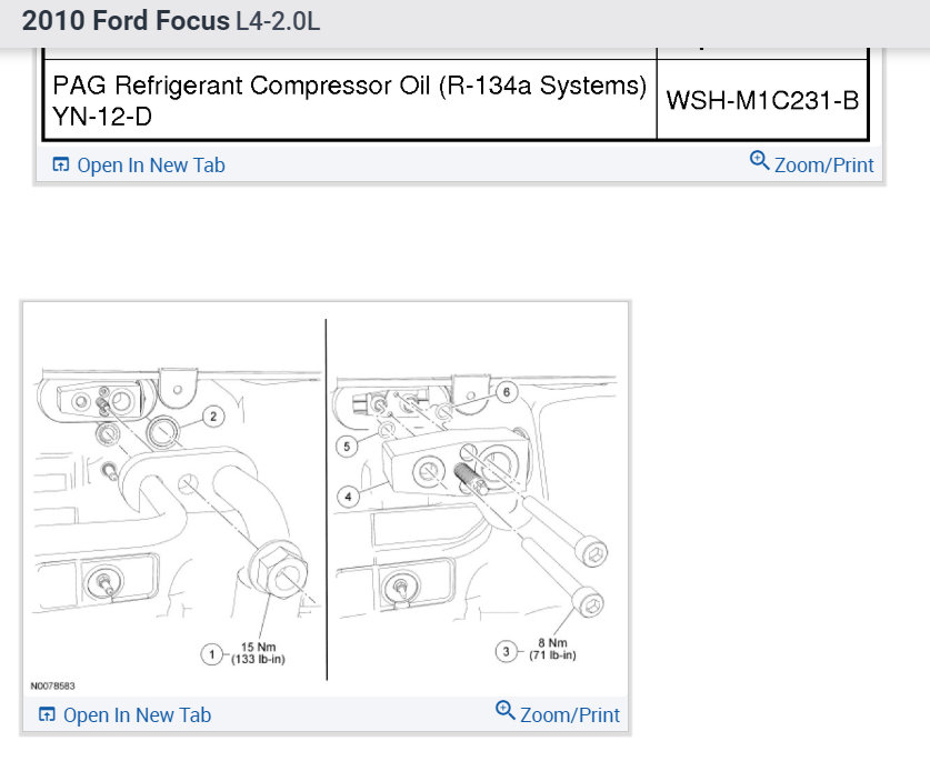

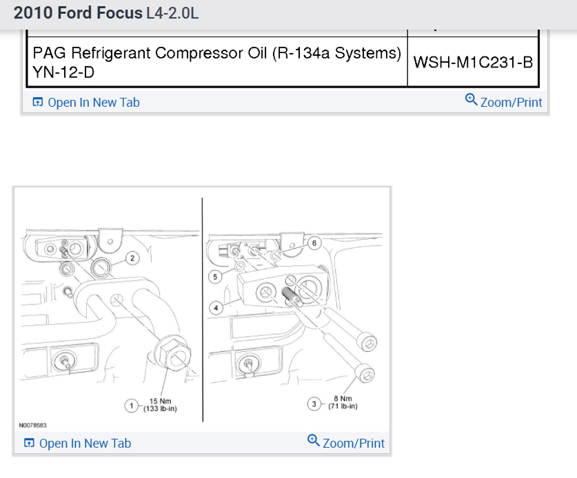

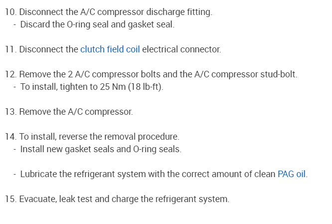

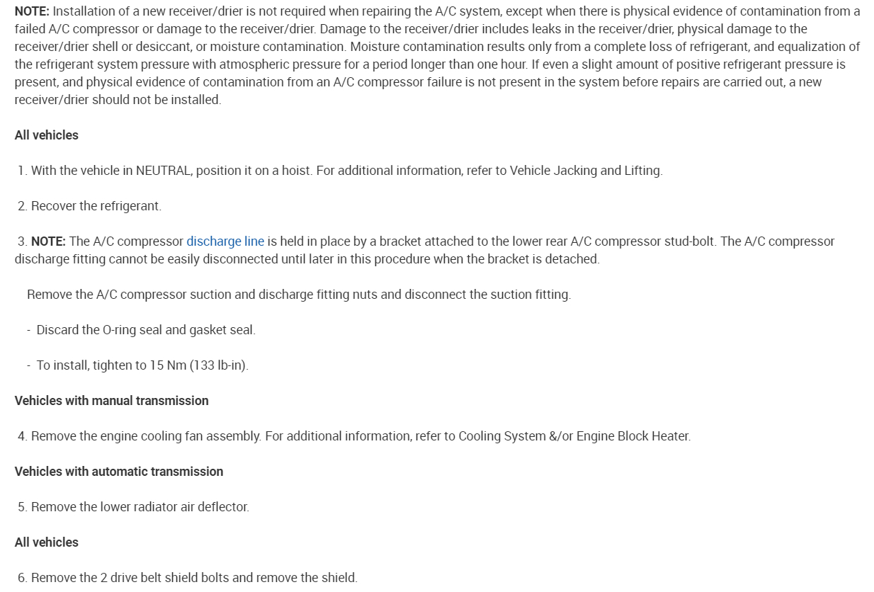

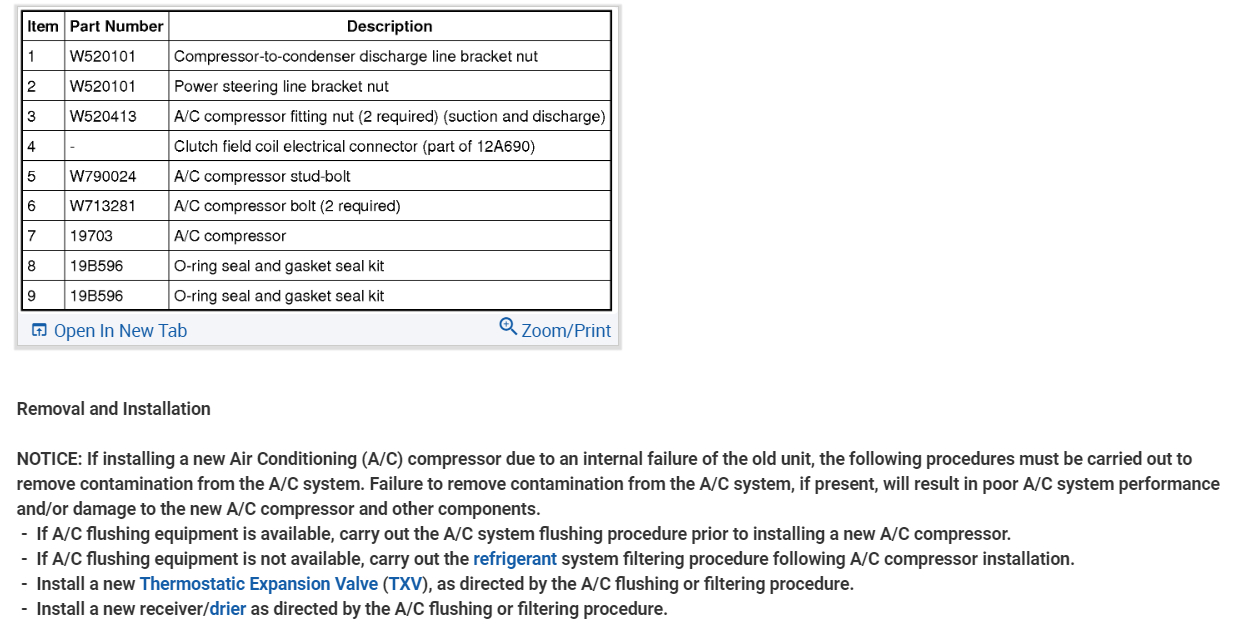

if there is a clog in the system and it requires the replacement of the Expansion valve, does this also require the tubing to be cleaned?
Aug 6, 2019 at 3:35 AM
  • 55,746 POSTS

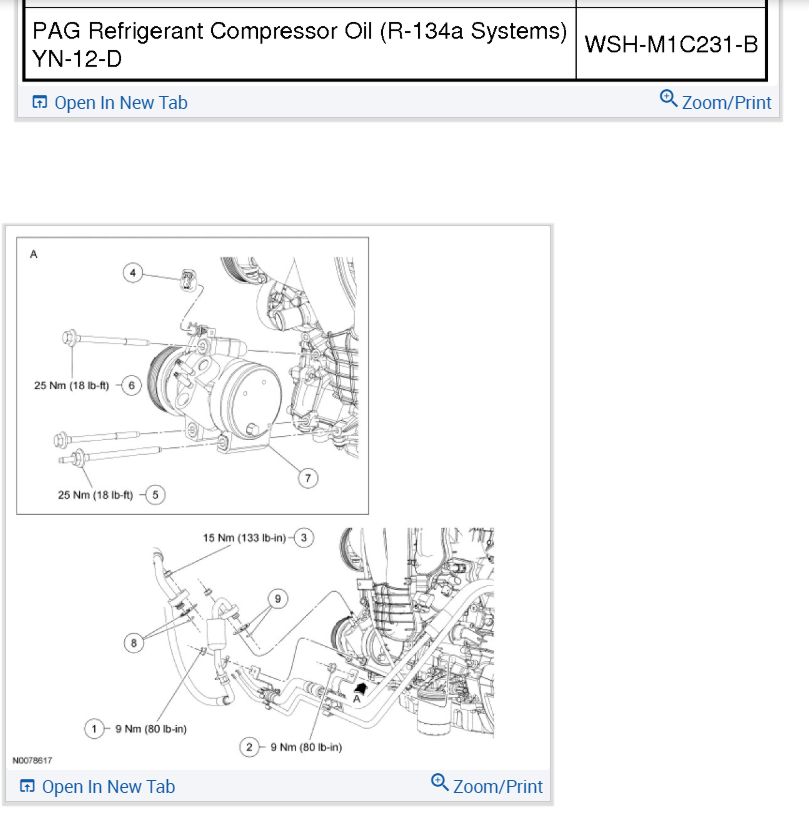

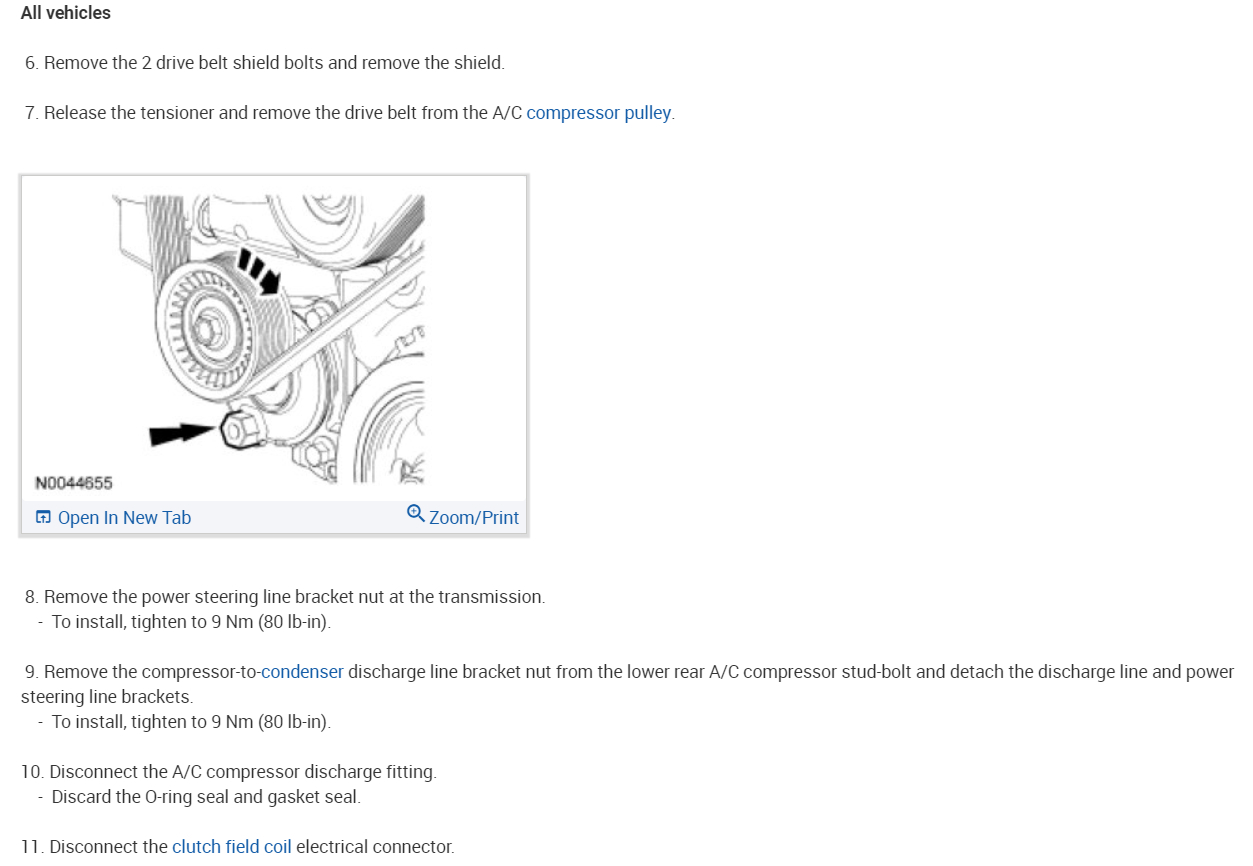

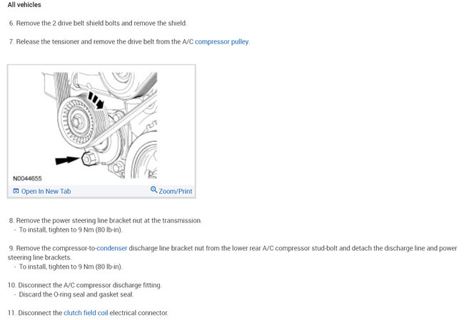

Yes it does, this usually happens when the AC compressor has failed. The system needs to be flushed so as to not contaminate the new compressor. Here is a guide that walks you through the replacement with diagrams below to help you with the repair on your car:
https://www.2carpros.com/articles/replace-air-conditioner-compressor
and
