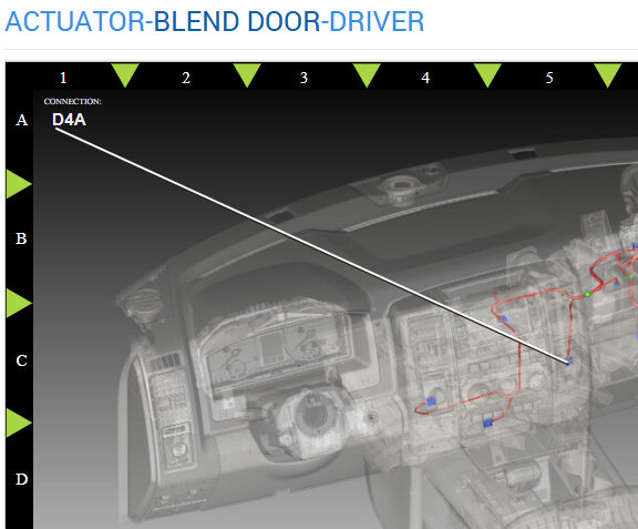

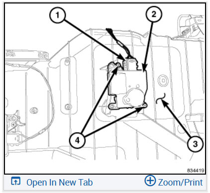

Driver side vents are blowing lukewarm air. The passenger side is nice and cold. heat works on all modes. A/C is charged and repaired all leaks.
Which blend door actuator, or the door itself should i check or replace?

Yep, this happens when the driver side blend door actuator goes out, here is the location and how to replace it. Check out the images (below). Let us know if you need anything else.
