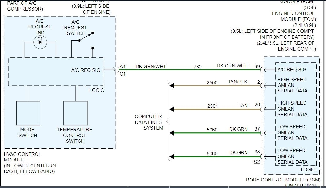

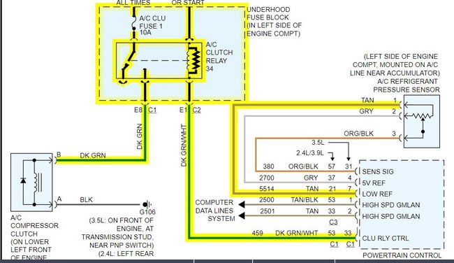

Okay, I just got the car about 3 months ago and it has been fine, A/C was working great I mean cold cold then about 5 days ago about 8 hours from night to day I go start it up to leave turn A/C on and warm hot air blows that's it never gets cool. I've checked the fuses the relay the clutch and the refrigerant all fine I even unhooked battery for a few minutes then hooked it back up to like reset it and I will say now that was one thing when it stopped blowing cold air the temperature only dic panel said -36%f when I did that with battery it now says 73%f. Please help it's so hot.

Good morning,
What is the Freon pressure? You said it was fine, but I need the high and low side pressures to see if the system has the correct pressure.
Can you see the compressor clutch engage?
Disconnecting the battery does nothing at all. It resets nothing. All is does is erase the code memory in the ECM. If there were codes, they will be back.
I attached a wiring diagram for you to view. We need to do some testing to determine the failure.
Do you have a test light or a volt meter to do some testing?
