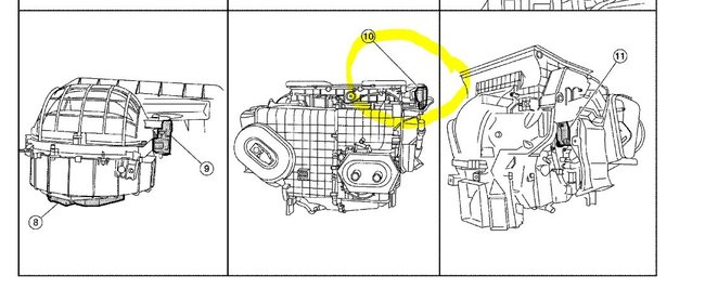

I went to turn my A/C on the other day and it only blew hot hot heater air. My compressor is working, all my A/C lines are super cold and sweating, my blower to my A/C is working. It’s like it’s stuck on heater mode? I’ve seen videos of people going in and just turning the door from heater to A/C until they get to a mechanic. I’d like to do that. I live in Loxley, AL. and it’s already 103 degrees here and I’m a single mom with kids and need my A/C. I’m very handy and can do this myself until I can get to a mechanic to fix the actual door motor. My question is which door? Aren’t there like three or four different doors. Mix door, heater door , A/C door, mode door? Which one is the one I need to find first because I don’t have a clue where it is? Which one is the one I need to turn the door on?
May 31, 2019 at 3:53 PM
Good evening,
The mode door motor is under the dash. I attached a picture and a procedure for you to access.
DOOR MOTOR
MODE DOOR MOTOR : Removal and Installation
REMOVAL
1.Remove the instrument lower panel LH. Refer to "Removal and Installation" See: Dashboard / Instrument Panel > Removal and Replacement > Removal and Installation.
2.Disconnect the harness connector from the mode door motor.
3.Remove the mode door motor screws and the mode door motor.
INSTALLATION
Installation is in the reverse order of removal.

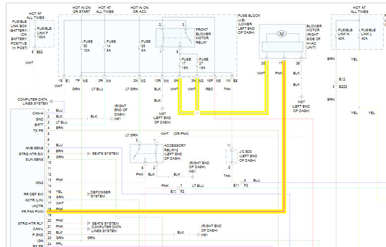

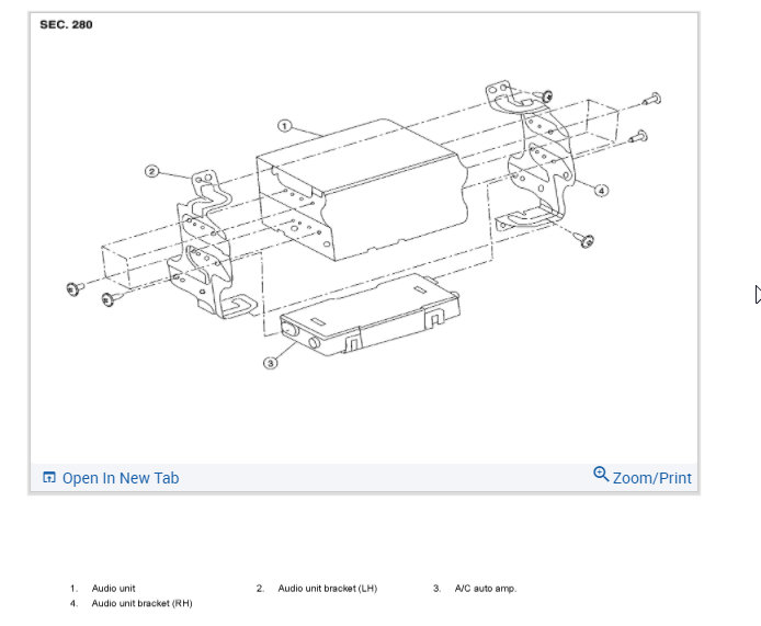

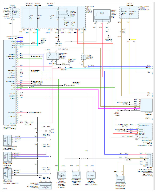

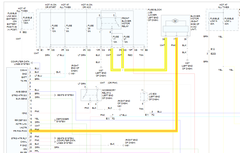

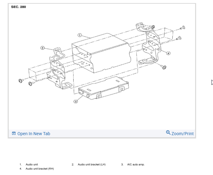

I have a problem on my Nissan Altima 2014, whenever I turn on the car the AC is on full blast. I can change the temp and it works on all locations. But it just won’t move to lower blast, I’ve tried turning off the battery to see if it would reset it but it didn’t do anything.
May 25, 2021 at 11:29 AM (Merged)

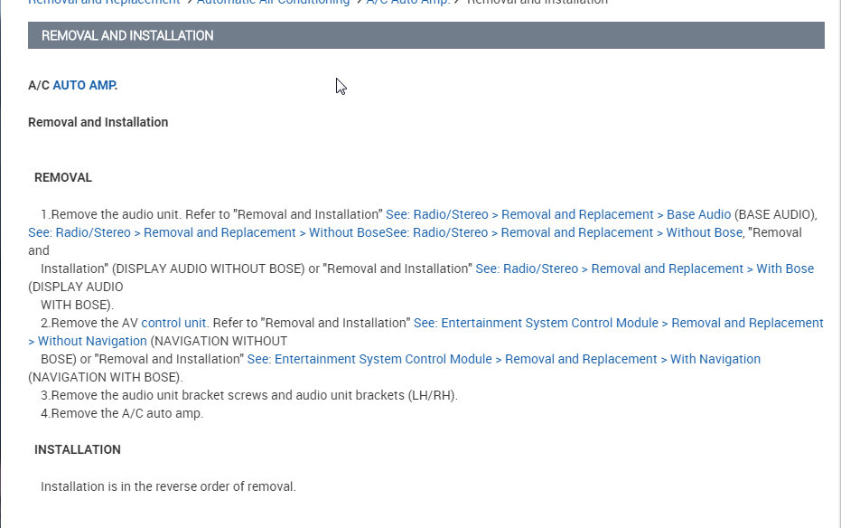

You blower fan is control with what is called pulse width modulated. That means the control module sends a varying level of voltage depending on the speed you want the fan to spin.
So if you are only getting high speed then I suspect the A/C amplifier is your issue assuming you have auto temperature control. If you have manual temperature control, it is not much different but the controller is called the front air control module. However, it is still PWM.
This is what controls the speed once the Body control module grounds the relay to turn the fan on the amp actually controls the speed.
Let me know if I misunderstood something but it appears this is what needs replaced so I included the process. Thanks
