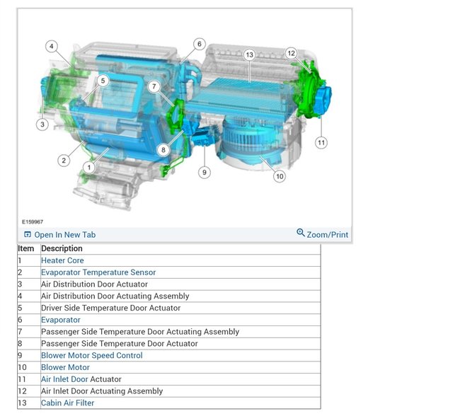

A/C blowing hot air like if it is in heater mode
54,000 MILES • 2.5L • 4 CYL • AUTOMATIC
RJEJ0208
Here in south Texas we rarely use the heater, so temperature buttons are on 68 degrees. we had a cold front and my wife switched it to heater for a few days , then when she switched back to A/C mode , it keeps throwing the same hot air. I checked it out and everything is set to A/C , even the A/C mode button is on.
Dec 19, 2020 at 6:27 AM
AL514
  • 5,691 POSTS
Hello, it sounds like the air distribution door is stuck, or the actuator has failed. It may be stuck from not ever using it as you said. Here's a picture of the system so you have an idea where components are. To replace the actuator you have to remove the steering column according to the instructions.
