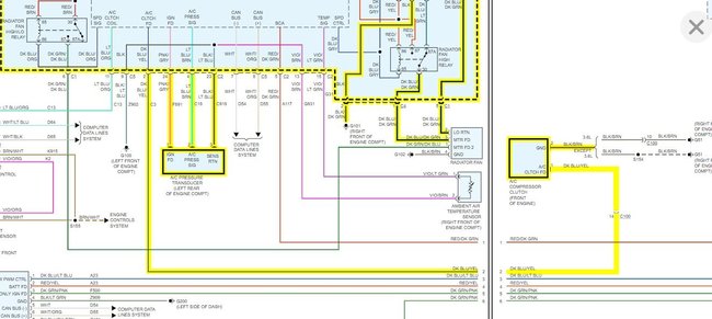

I have checked the compressor, the clutch, the fuses etc. To no avail could not find what the problem is.
May 3, 2020 at 2:35 AM
Experienced Mechanic
52,796 POSTS
Good morning,
Does the clutch engage when you turn the A/C on?
Do you have a set of gauges to check the actual pressures?

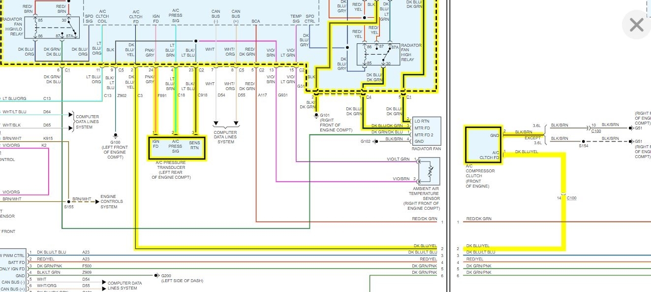

Do you have a test light or voltmeter to do some checks? I attached a wiring diagrams for you to do some checks.
