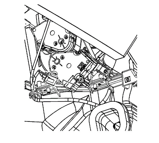

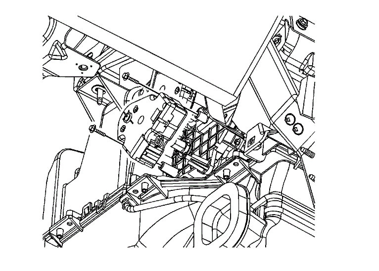

When you command cool and heat, can you hear the blend door move in the heater case?
AIR TEMPERATURE ACTUATOR REPLACEMENT
REMOVAL PROCEDURE
1. Remove the fuse labeled HVAC CTRL (BATT).
2. Remove the steering column filler panel.
3. Disconnect the air temperature actuator electrical connector.
4. Remove the air temperature actuator screws.
5. Remove the air temperature actuator.
