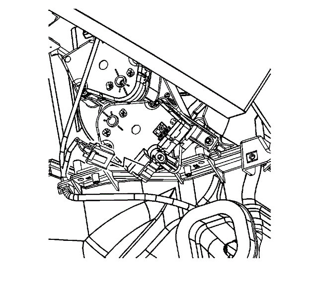

The AC is blowing mostly hot air but will sometimes get cold for a few seconds. It also is very loud outside of the car. I have checked the A/C related fuses and ensured that the clutch is engaging, but I don't see any problems. The intensity of air flow also increases as I turn the dial on the dash. So I'm not sure what the problem is and I'm smothering in the 100 degree heat. Please help!

Good afternoon,
Do you have a set of gauges to check the Freon pressures? I need to see the high and low side readings.
When you command cool and heat, can you hear the blend door move in the heater case?

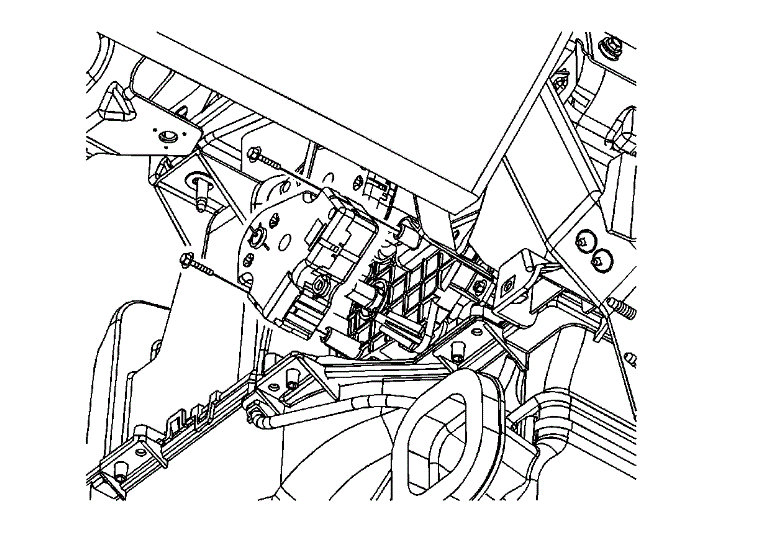

AIR TEMPERATURE ACTUATOR REPLACEMENT
REMOVAL PROCEDURE
1. Remove the fuse labeled HVAC CTRL (BATT).
2. Remove the steering column filler panel.
3. Disconnect the air temperature actuator electrical connector.
4. Remove the air temperature actuator screws.
5. Remove the air temperature actuator.
