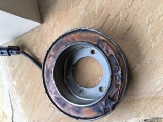

Low side pressure is on high side and A/C clutch not engaging. Ran Nissan diagnostic test and determined A/C coil was bad. Replaced clutch assembly. During repair found that old coil had burnt out. Now diagnostic test shows coil is actuating clutch however the clutch still does not engage when A/C is on. Suspect the low side switch is preventing clutch from engaging.

I do not have gauges for high and low side readings. Is there a easy way to get this at an auto parts stores without buying the equipment? More details on the problem. Initially checked the Freon level and gauge indicated low side was high and to take to a mechanic. Also noticed the clutch was not engaging. Auto shop said compressor needed to be replaced. I questioned what the problem was they indicated clutch not engaging. Asked if they could replace coil or assembly rather whole compressor, they will only replace compressor. I replaced clutch assembly for much less than a new compressor. Nissan has a diagnostic mode where you can check various relays. Running this I could hear clicking from the relay activating the coil and could see the clutch plate moving as well. This confirmed to me that the coil had power and was working. From research I did online the coil failure is a fairly common issue with the Murano. I have also included a photo of the old coil showing what I think is the defect.
Is it logical that the coil failed and caused the low side to have high pressure? Or could it be the other way that the high pressure caused the coil to fail?

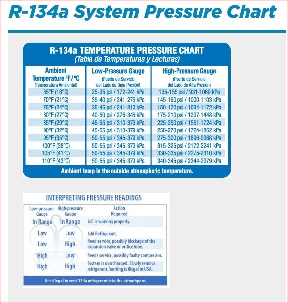

Okay. That is great info. Clearly we are still guessing until we get the high side but that narrows it down. Take a look at this diagram.
At 80 degrees your low side pressure should cycle between 40-55 PSI. The fact that your low side is going from 23 to 50 shows that it could be low on Freon. To confirm this we need the high side pressure to see if it is low as well.
There is a chance that we have a blockage in the expansion valve or other restriction in the high side but the way to confirm this would be getting the high side pressure as well.
If it were me, I would try to just put some more Freon in it and see if that low side pressure comes into line.

Got loner manifold gauge set, however high side was leaking some. Ambient temperature is 63 degrees, low side cycled between 18-47 psi and high side between 80-105 psi. Seems like both are low indicating add Freon. Would you expect small leak in high side to change results. Will get another loner hopefully that does not leak.
Jun 15, 2020 at 7:33 AM
Yep. I think you are on top of it. Both sides are low which indicates it needs more Freon. If you have a leak on the high side then that is going to leak refrigerant faster as it is high pressure.
We need to find and fix that first before we go any further or you will just be wasting Freon.
