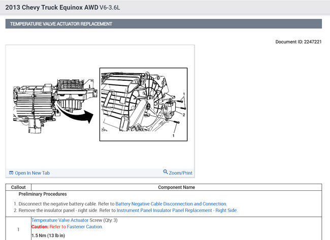

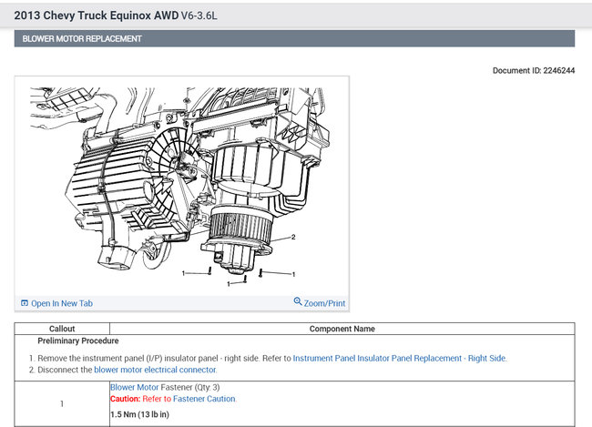

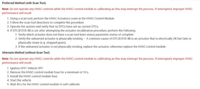

So, is there air coming out of the vents just not cold or is there no air from the vents? If no air is coming out, then 9 times out of 10 the blower motor has gone bad, but this guide can help you test the power and ground to confirm the issue also, I have included the blower motor location in the images below.
https://www.2carpros.com/articles/blower-fan-motor-works-on-high-speed-only

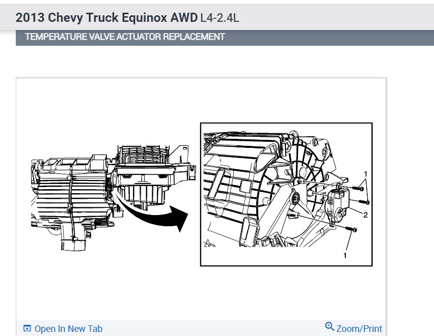

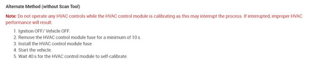

If the air is coming out of the vents okay, then the temperature control actuator is having a problem here is how to replace it and calibrate it.
Aug 25, 2022 at 5:10 AM
EQUIN0X13
Thank you for the reply, the air does come out of the vents, and you can hear the change in tone when the A/C is turned on. Still no cold air, just warm air. Fan Switch works just fine and can control fan speed.
Aug 25, 2022 at 7:09 AM
  • 55,845 POSTS

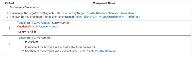

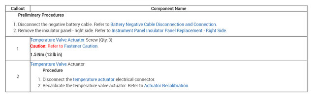

Okay, this is a temperature blend door actuator problem, here is the part that needs to be changed with the calibration instructions, let me know how it goes.
Aug 26, 2022 at 5:02 AM
EQUIN0X13
I replaced the blend door actuator, and it fixed the problem. I have cold air in the cabin again. I pulled out the cabin air filter while working in the area and discovered a mouse had moved in and buried the filter with insulation. I cleaned it all up, including the blower motor. I now have cold air coming out at a faster rate. Thank you for your help.
