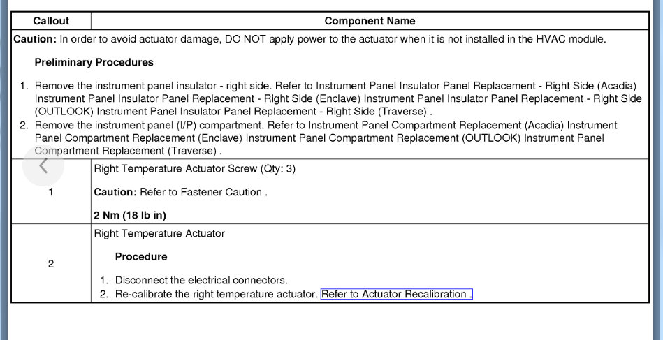

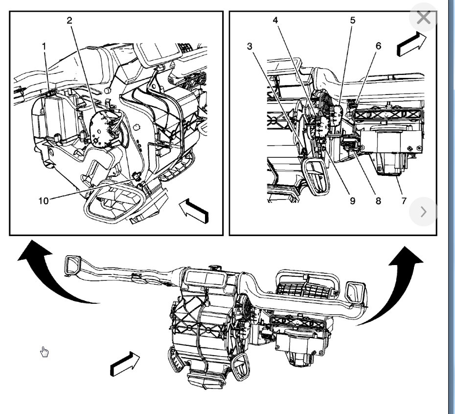

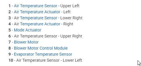

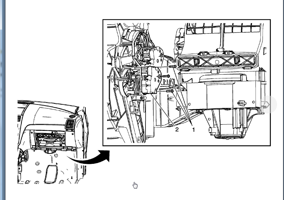

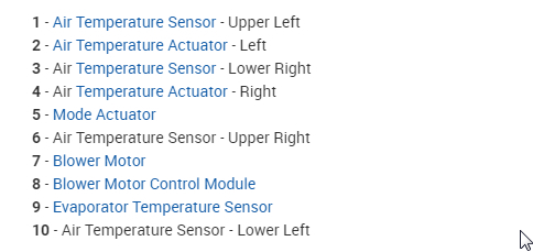

If the passenger side is the only one not working then the blend door is what would be causing it. You said you changed it but take a look at the diagrams and see if this is the one that you replaced. You have one on each side of the vehicle so I suspect this one didn't get replaced, isn't working or the door is the issue.
When you have it off, start the vehicle and run the AC, then move the door with your fingers and see if you can get hot and cold air out of the vents. If you can then the actuator is the issue. If not, then there is an issue further in the air box.

Hi kasekenny1. I’m having the same issue as Sarnold. My driver side blowing hot air, passenger side cold. (I want cold)
I’ve replaced the blend door actuator under the drivers side, per this diagram. This worked and cold air successfully blew out on the drivers side, however, it caused the right side to now blow hot air.

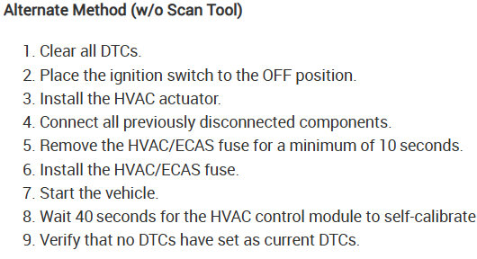

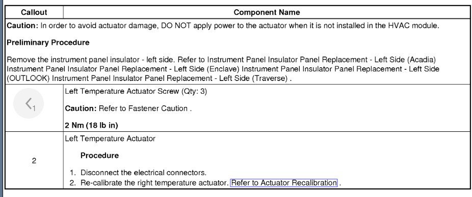

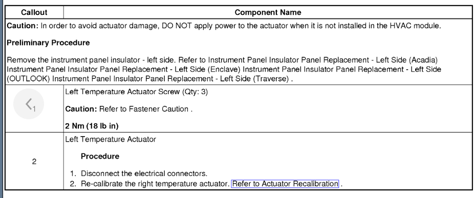

hi kasekenny, is there a proper way of calibrating the blend door actuator once replaced? im asking because iv had the same issue where driver side has warm air and passenger has cold so im hoping to replace the actuator and it fixes the problem, but want to make sure to properly calibrate it after install.
Jul 3, 2025 at 3:38 PM
  • 55,447 POSTS
Sure, here is the way to calibrate the blend door actuator. Check out the images (below). Let us know if you need anything else.
